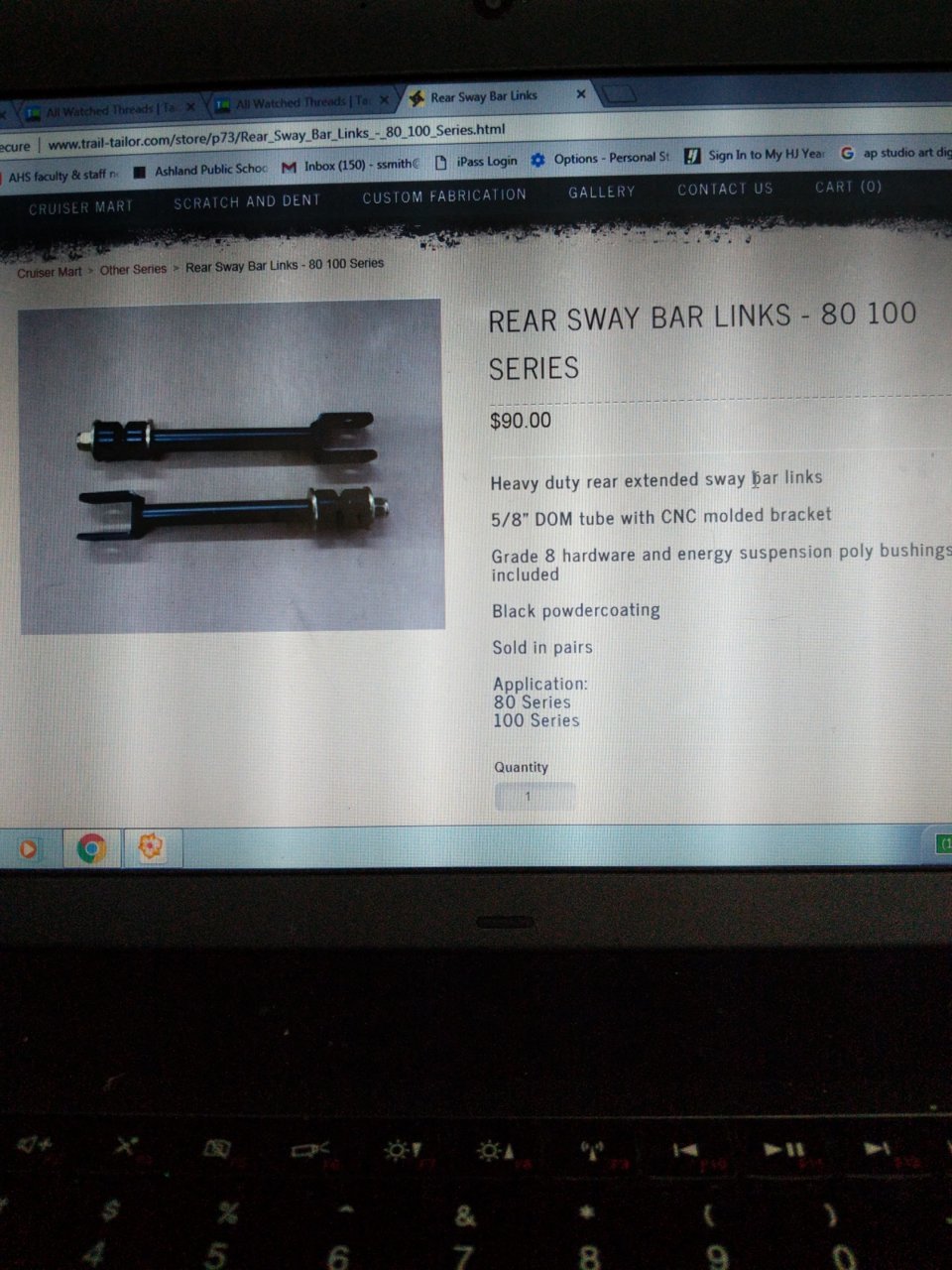

    Finally found the source of my mysterious rattling noise!!! Next fix rear sway bar extended links!

    Man I'm glad you posted this, I'm slowly replacing all worn bushings and chasing a "rattle" myself. Just ordered these, hoping this is the fix. But mine seems to be coming from the front, I already replaced the front sway bar links and it's still there. I'm wondering if it's my front brake pads? They seem to have a lot of play where the caliper pins go through the pads, and it kind of mimics the rattle I'm hearing. Any experience with this? I know they are supposed to slide along the pins as the caliper cylinders are actuated, but mine seem to have excessive movement. I have also read that with high mileage 100 series, the bushings in the rear UCA/LCA's can be worn enough to have slop in them to cause them to move enough in the bracket to create some rattles. I'm eventually replacing wheel bearings, cv's, all bushings, UCA/LCA's, front and rear shocks and coils and torsion bars. After the drive train and motor already checked out, and after all the above, she should be as good as new.

    For the rear sway bar, I climbed under and pushed on the the bottom of the link and found that their was some play. Then I with an open palm I hit it from the bottom pretty hard and it mimicked the sound pretty closely so I'm pretty sure this is the rattle I've been chasing. I've also heard that the heatsheilds to the cats can have a rattling to them because the bolts that hold them together corrode away over time. Mine seem pretty solid so thats not it in my case.....yet.

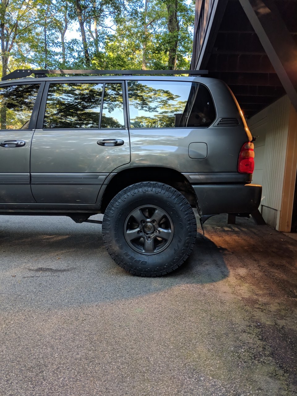

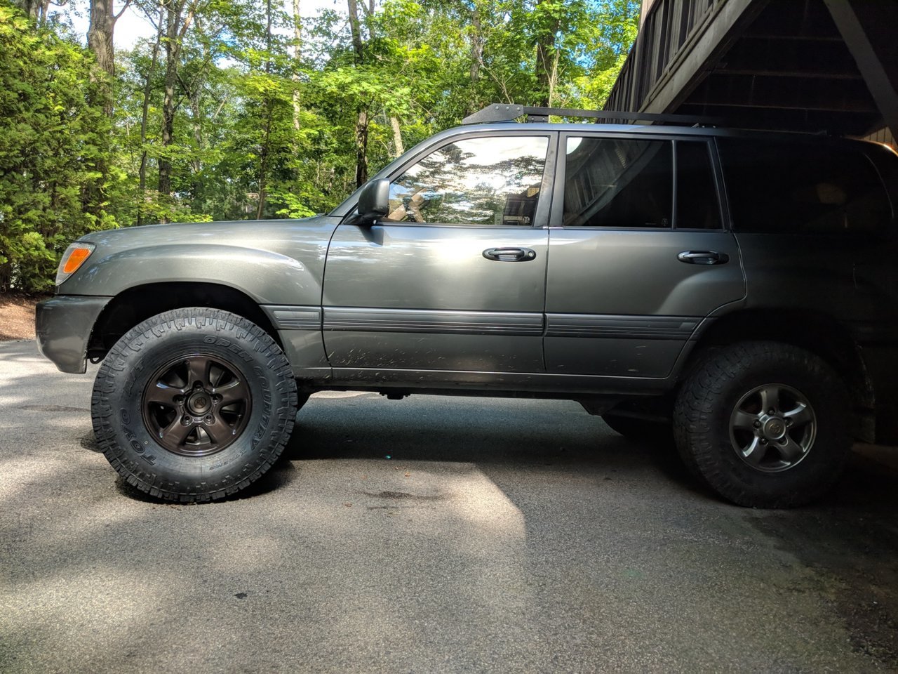

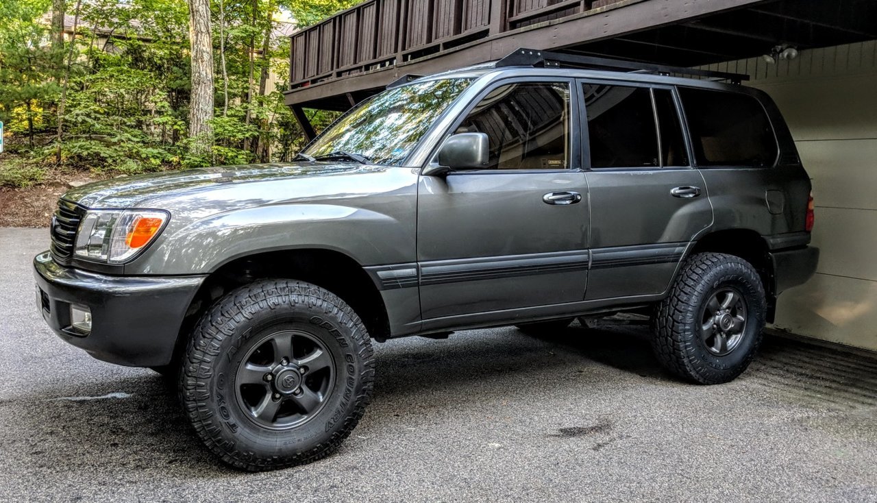

    Started today painting the spare, first I went with a dark bronze but when I put it next to the truck outside it looked more like a poop brown! It doesnt look too bad in the pic, but in person it was pretty awful!:(
    I then repainted them a gunmetal gray. I like that much better so I'll be doing the rest of them tomorrow hopefully.

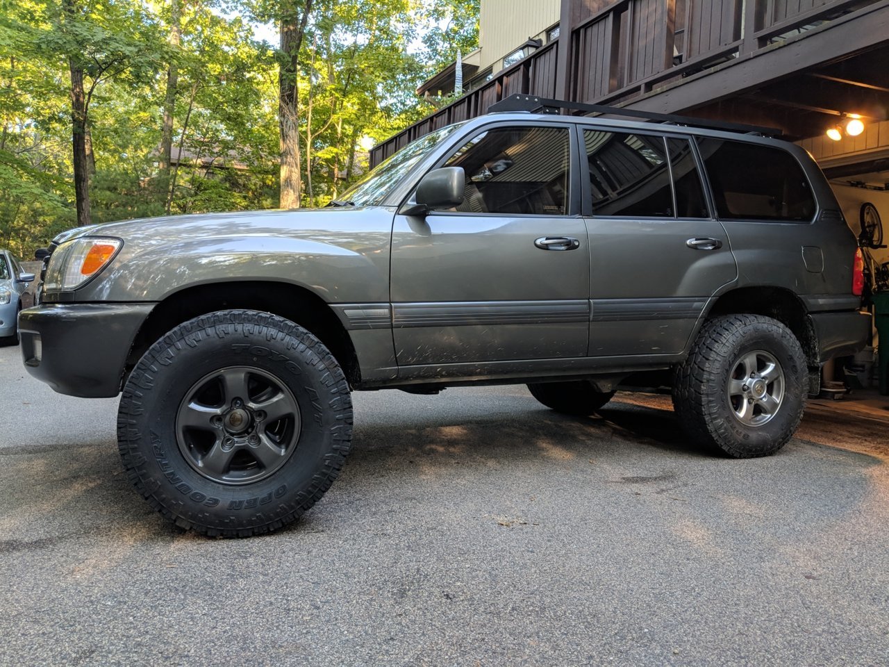

    Finished the tire rotation and wheel painting today. Came out pretty good although not sold on the color yet. I think it might grow on me though. Wish it was a shade or two darker though.
    My sliders should be coming in any time now so those will be my next project!

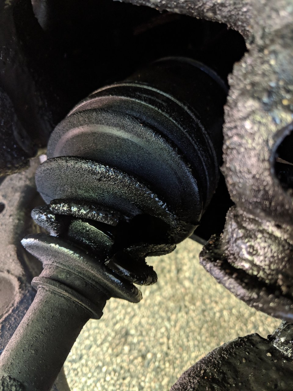

    And I found this little issue while I was in there. What I thought was weeping clamps was actually a big ole hole!:bananadead:

    The pic in my last post on the last page shows it, but I found a big tear in my CV on the driver's side! :(
