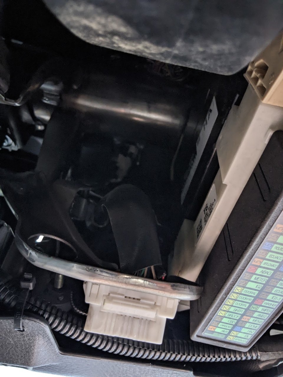

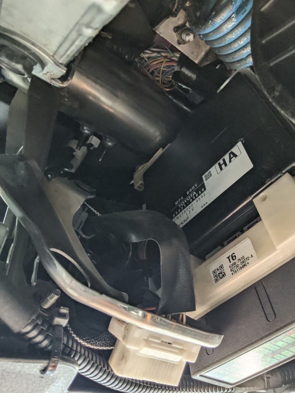

    Along that line, it would be good to peek under the dash at the OBD connector. Some dealers / aftermarket folks modify it for different mods that were installed. It should look sorta like this if unmolested:

    Magnuson TVS1900 Supercharger with 87mm pulley, Catted OVTune dumptubes, Doug Thorley 2.5in y-pipe, custom mufflers, 76mm Tundra throttle body, 5.29 Yukon gears, JamesT custom fuel rails, Yotawerx 87mm tune, Eibach Pro Truck Stage 2 suspension. And some other stuff.
    If I am following what you are saying........... I replaced the factory ODBII port while troubleshooting. There was no pig tail connected. It goes directly into a wire harness.
    Nothing is connected to the ODBII port while I am trying this. Tactrix is directly plugged in.

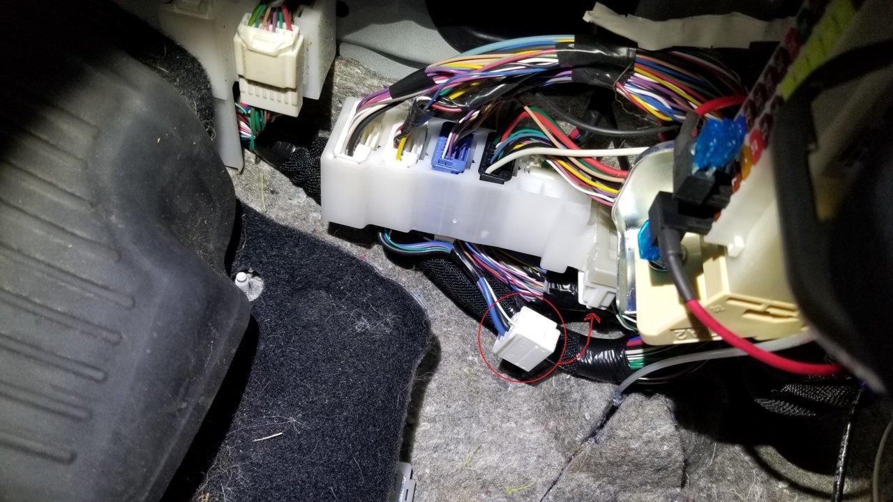

    So I just discovered something while checking you guys suggestions:
    Should that not be plugged in? It is right behind the in cab fuse box, and behind the hard plastic cover. Possibly this is the issue, and I knocked it loose at some point? Can someone check their truck to see if that is connected? You should be able to see where it plugs in at just above the hard plastic cover (to the left of the brake).

    That would be my first place to start looking?
    I believe that is the trailer brake harness? If so, it should be no problem.

    I don't quite follow. Replacing the ODBII was an attempt to correct this issue. I had this error before and after the ODBII port replacement. The new ODBII port works fine with another ODBII reader that I use.
    This is that device: https://www.amazon.com/Friencity-Bl...t=&hvlocphy=9009452&hvtargid=pla-445660804042
    Yep you are right it is the trailer brake controller harness: https://www.tacomaworld.com/threads/brake-control-install-write-up.428999/

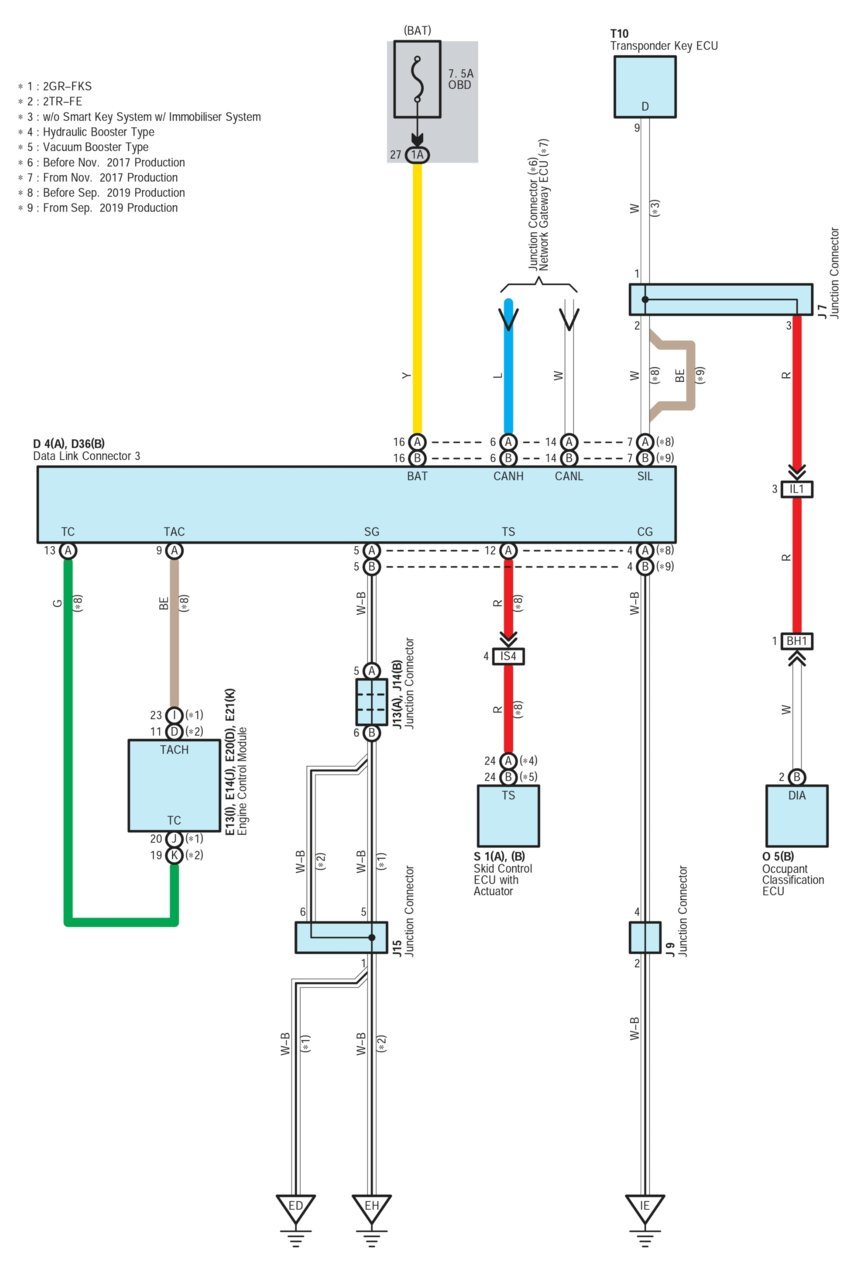

    I guess it wouldn't be a bad idea to verify everything is pinned correctly.

    Were the replacement pins OEM? I've heard from others before that using non OEM pins tend to bend over time, causing a crappy connection.
    To flash, you only need a few pins.
    Pins 4, 5, 6, 14, and 16. Those are the pins I would focus on.
