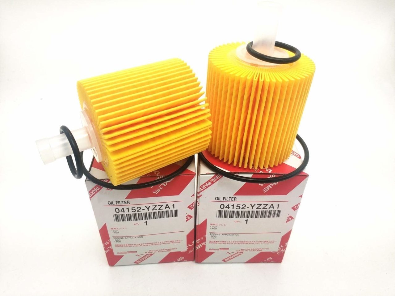

    for those of you who did/do your oil changes what are the parts that you get before hand? i know this engine is a lot different than the 4.0 that i had in my other taco. that oil change took all but 2 mins lol. basically, im wondering if you guys could list things that could make this much more smoothly, like aluminum housing (i remember someone mentioning in another thread), any drain valves, whatever! i know an unorthodox request, but i appreciate it. thanks.

    I just did this again a few days ago.
    I've never had a problem with the plastic housing, but I always torque to spec and I make sure my tool is properly seated before applying any force. I notice the housing is hard to screw past where the o-ring seats using just my hand. Once I get it to that point, I go ahead and tighten it the rest of the way with my wrench until it's torqued to spec.
    There should be plenty of room to slide underneath and do everything without jacking up the vehicle. You just need a flat spot the work on. I've been doing it in a gravel driveway. I suggest throwing down some cardboard though to catch drips and overflow.
    You can get torque specs and other info in the pinned DIY maintenance thread:
    https://www.tacomaworld.com/threads/3rd-gen-diy-maintenance-quick-reference.406712/

    The 3.5 really isn't radically different than the 4.0. It's the same architecture. The computer controlled stuff is a little different.
    As far as special tools? Just the filter tool. I'm at 86K and did my oil changes other than the free ones and have not had issue with the plastic housing. I don't use a torque wrench. I just get it snugged up and it works fine.

    Use 0w-20 Mobil 1 Advanced Fuel Economy.
    Get the Toyota filter which will have the o-rings and filter drain push-in.
    Get the proper tool to remove the filter housing.
    A hose for the filter drain plug is nice for reducing mess.

    I’ve been able to get the filter at Walmart. Some of them, usually the mega-marts, have started carrying the Toyota filters in their “Toyota genuine parts” box. It has the gaskets and the filter drain thingy included. I think I paid about $7-8 so I just grab one when I pick up the 5 qt jug plus another qt of Mobil 1.
