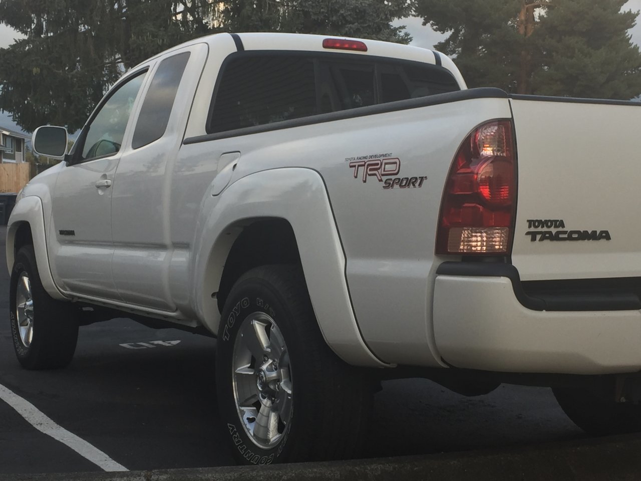

    I’m fine with .85 because I’m only trying to fit 265/75/16 with 0 offset wheels. I might lift more later when I get some armor but this is fine for truckin’ around in snow and sand.39DAA621-3E81-4F0E-A680-373157484CBA.jpg

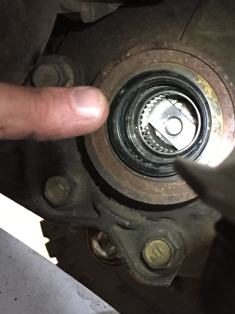

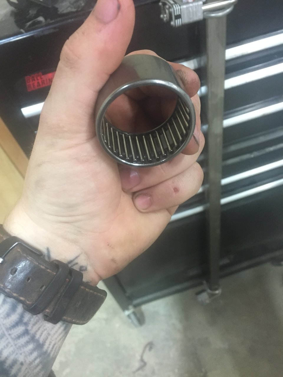

    ECGS bushing installed! Didn’t even mess anything up. Thanks @ECGS, no more vibes or slop in CV.
    The Needle bearing seemed in near perfect shape. However IMMEDIATELY after changing front ride height (5100’s) I noticed wiggle and vibes in CV on drivers side. This bushing saved the day because I was getting really annoyed at the “hvvvv” sensation.

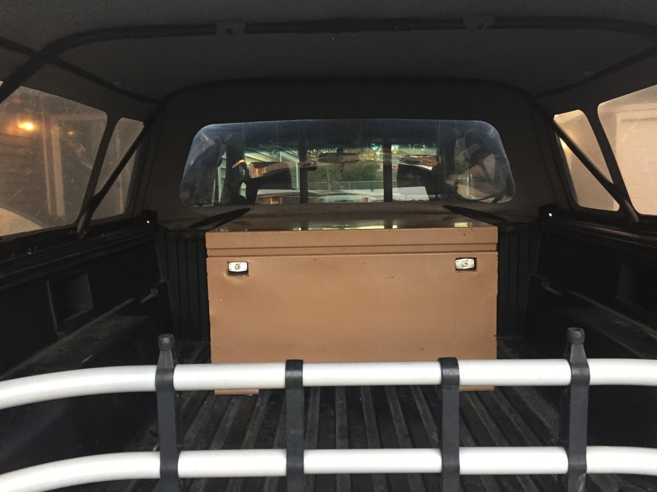

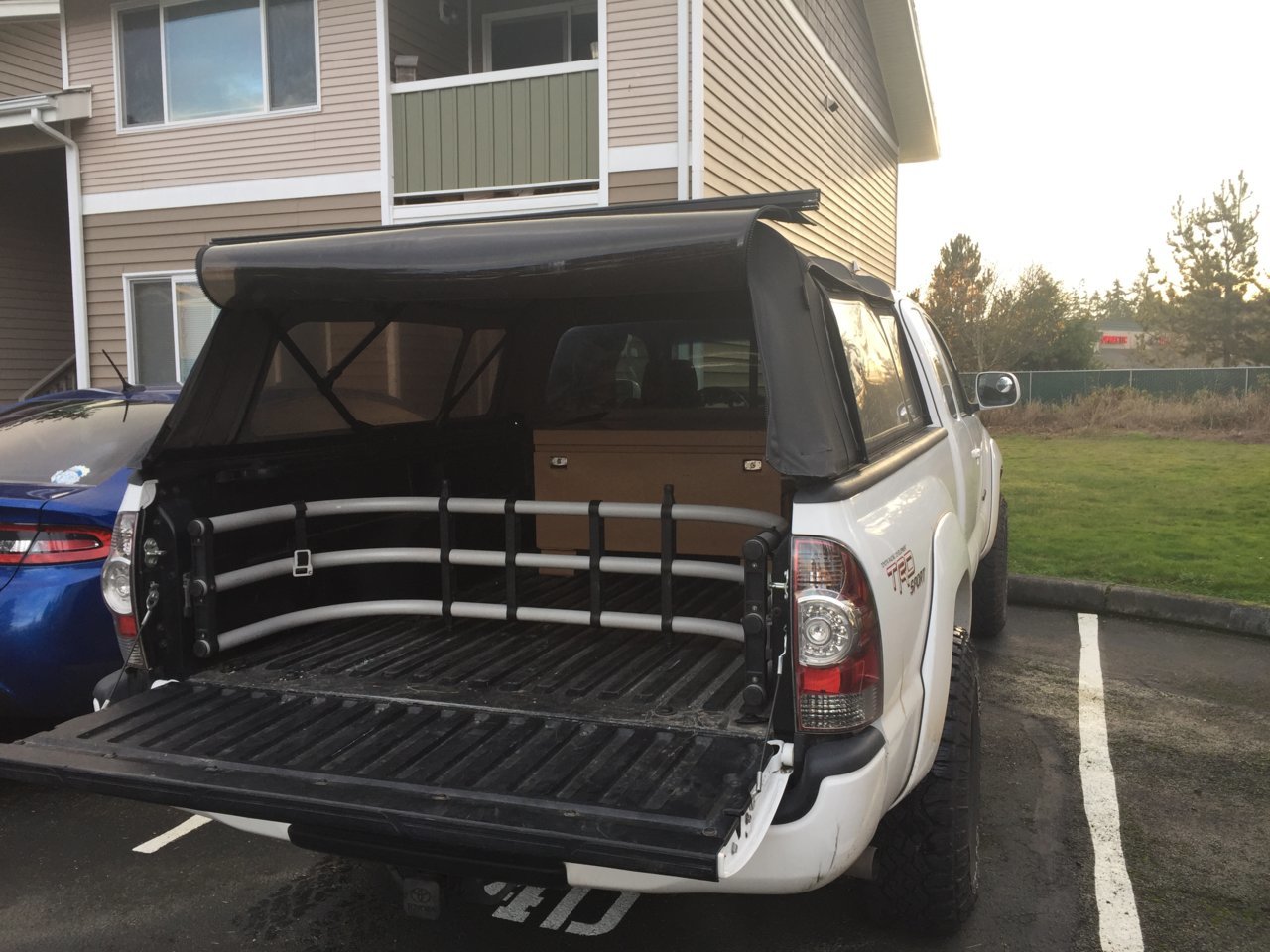

    Added a Bestop I got used. Pain to install in the cold but I really like the look. Also bolted a knaack job box to the bed. Hopefully the tweekers will stay out.

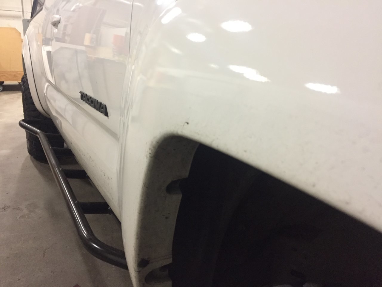

    #Snellworks Sliders welded on. I asked for some extra kick out. I really like how they turned out, still looks natural. Rattle cans FTW.
