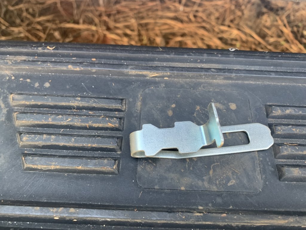

    During cross member removal, this fell out. Maybe from brake area. Anyone know where it goes ? Thank you.

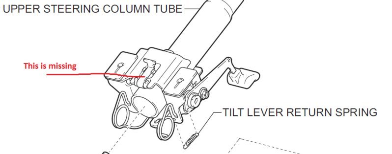

    I think that's part of the collapsible steering column mechanism, there should be 1 on each side where the steering column bolts up I believe.

    No just one in the center between the mounting bolt slots.

    Ah ok, I wasn't gonna take mine apart to go exploring lol.
