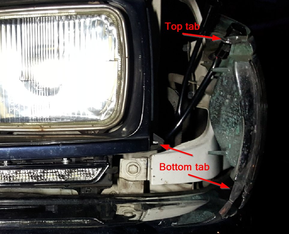

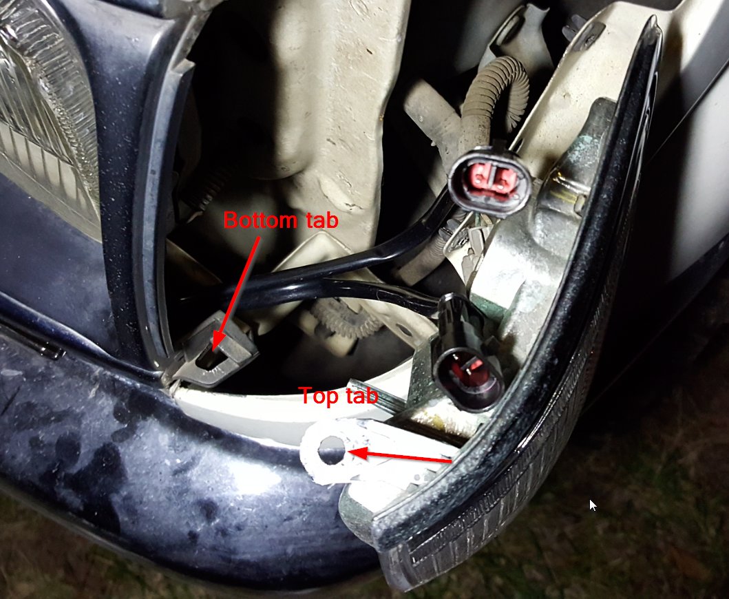

    Have owned 2, 1st gen tacomas and both eventually had thier corner parking lights come loose and it seems like on mine its because the plastic bracket attaching it to the corresponding headlight is inherently weak!
    Any ideas on reinforcing it or in my case now that its broken does anyone sell a better corner light assembly than the OEM taking this 'flaw' into account?

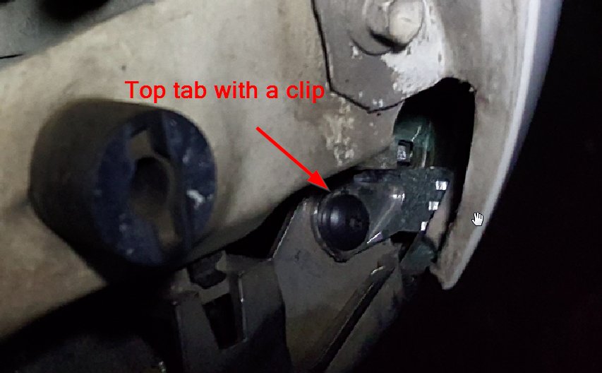

    I dont think they are talking about screws necessarily but thanks for the threadlocker tip regardless. The tabs which mate the corner lights to the grill are not the most robust bracket design as in strength / thickness. They will break off just getting them into place prior to inserting and tightening the screws. Also the lights need to be inserted at an angle and I noticed on mine the tab inside the corner light housing of the fender well can get old and break causing it to become loose.
