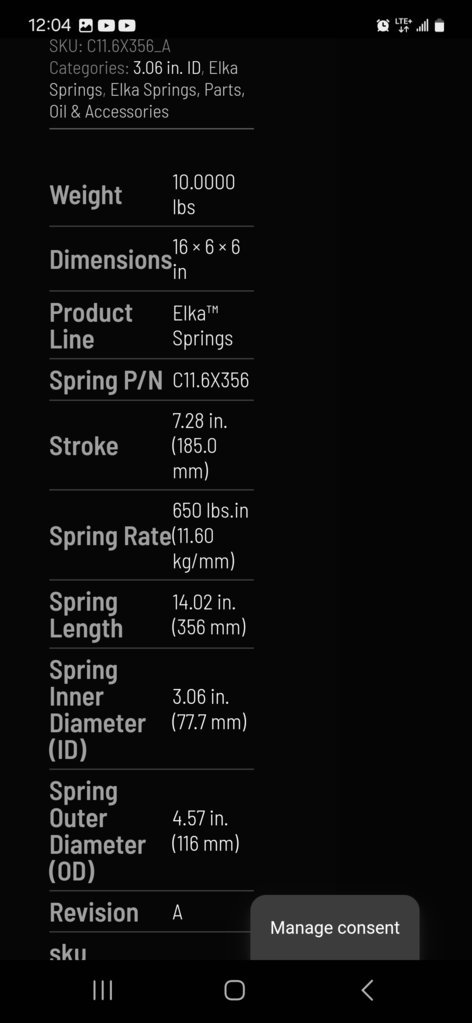

    11.6x356 is a 650lb coil that's what I'm running. Pulled from elkas site.
    I had 11.6x330's but had them changed as there was a disgusting amount of thread showing once i actually got the truck to lift.
