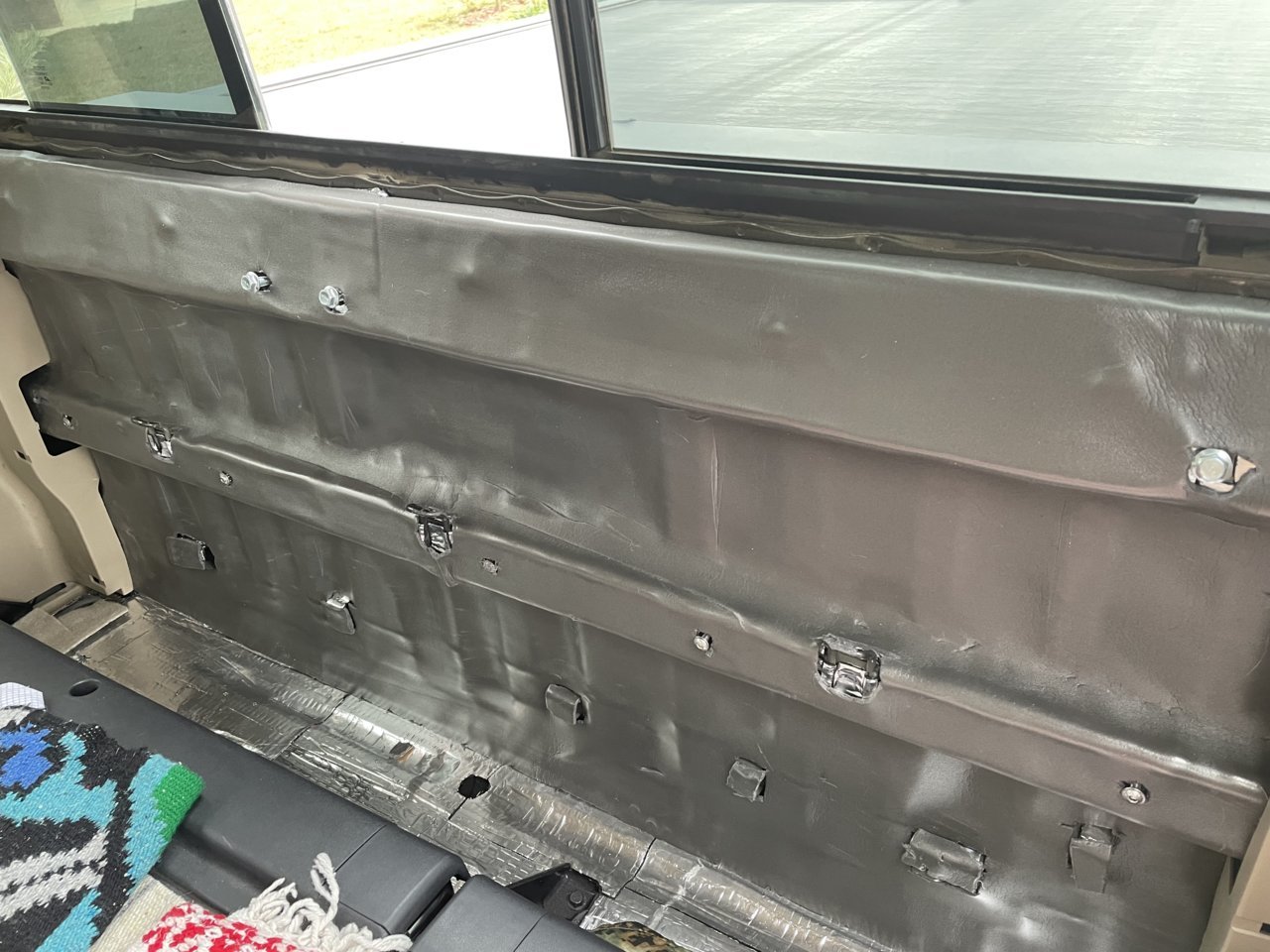

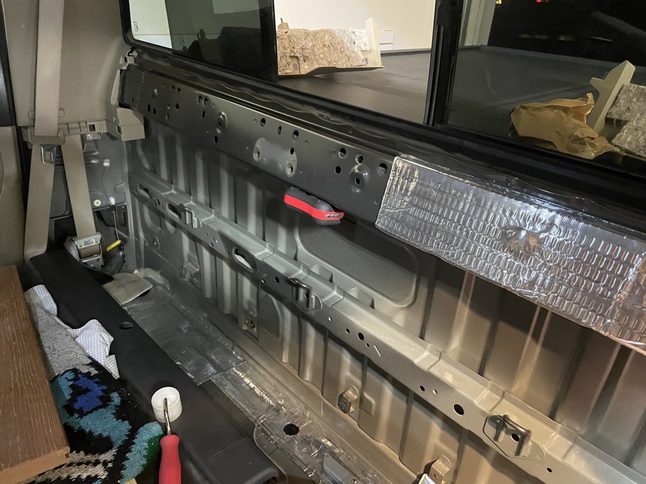

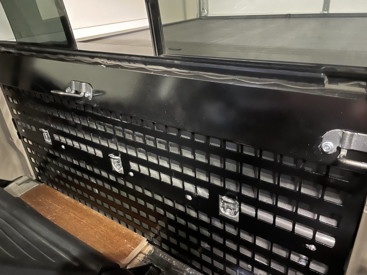

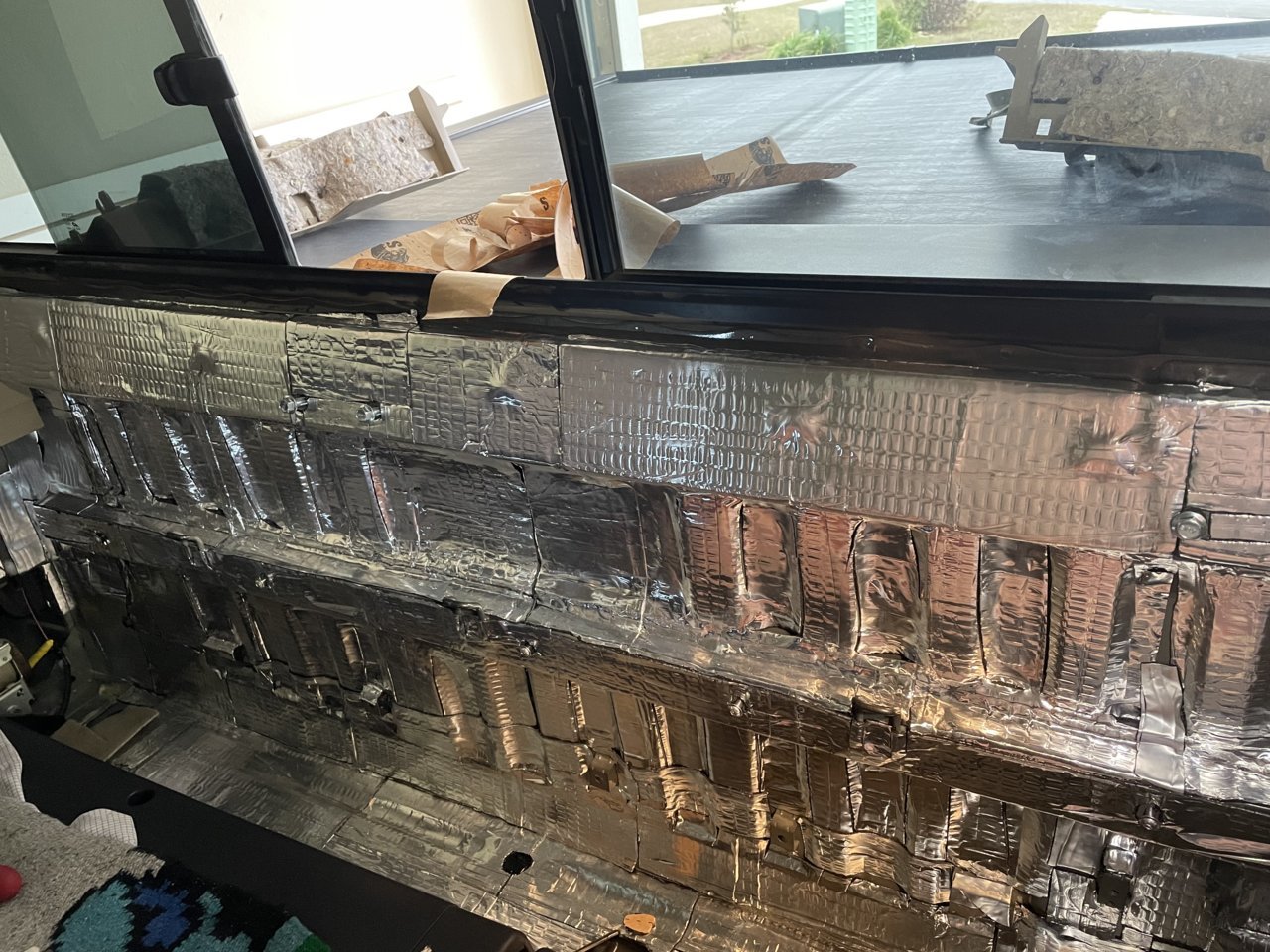

    Just completed my install of the molle panel for my DCSB. Took some time but worth it. The IMG_0937.jpg IMG_0939.jpg IMG_0942.jpg IMG_0941.jpg sound proofing was definitely worth it. Can't wait to finish the deck, overhead, doors and pillars. Here are some pics.

    Is that sound + insulation?
    Did you use the name brand stuff or Noico?
    I've got a box of Noico sitting around but keep going back and forth on whether to spring for the spendier foams.

    I used Siless sound deadening mat and Siless foam. That is what others have gone, used both. it made a big difference in sound coming from the back seat. I think you can use Noico and add a closed cell foam brand of your liking. Plan to do the rest of the truck in the future the same way.

    The hooks were reused but the panel came with new bolts for the latches and 5 for the lower section to secure it. You will need longer bolts, OEM are too short to use.

    I used 5 sheets of Siless 80mm sound deadening Mat measuring 15.94X23.6in (2.61 sq ft) equates to 13.5 sq ft. The same amount for the Siless 157mm closed cell foam. I ordered the supplies for 36 sq ft since I plan to do some more sound deadening as I progress with my other improvement. I pretty much covered all the areas and under the square tubes plus the floor up to the seat bolts and up a side where the seat belts are. If you don't doe the floor and sides, you may be down to about 9-10 sq ft vice 13. Personal preference and how much time you want to put into it.
    Hope this helps.

    Factory bolts are a tiny bit too short on the seat back latches. They will work in a pinch but not alot of threads grab
