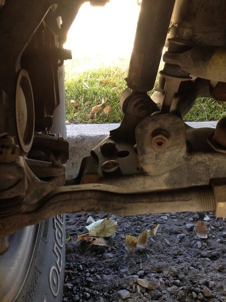

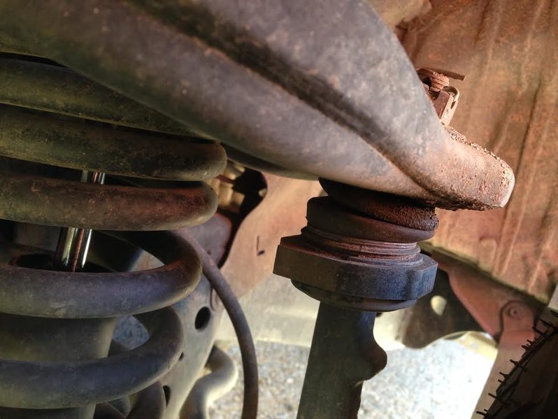

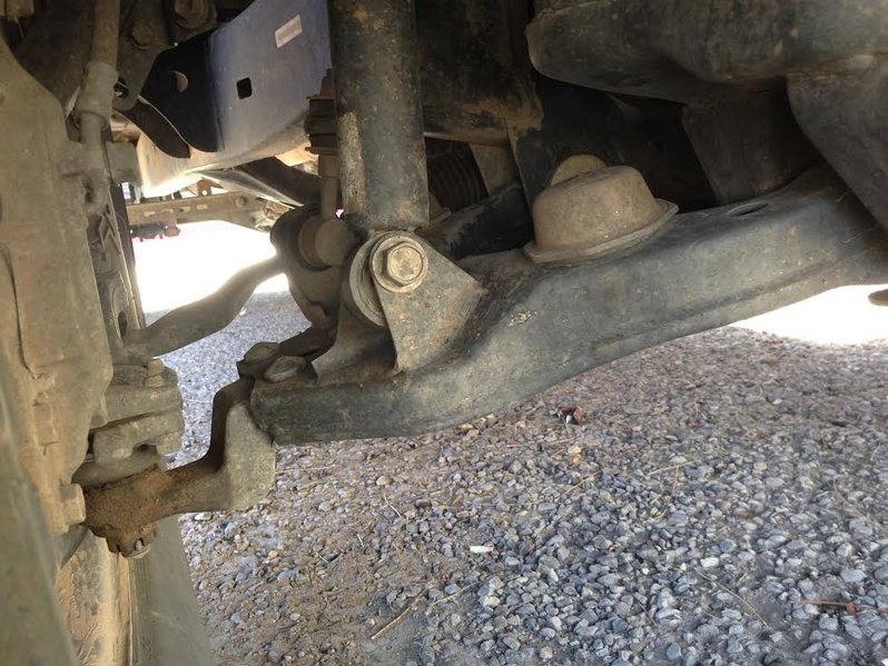

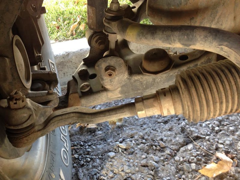

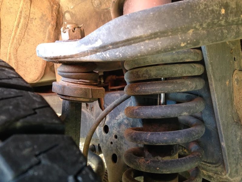

    All the gunk around the ball joints is kind of worrisome

    actually it doesn't look all that bad! Yeah there's a lil buildup, but they don't look to be in horrible shape. Mine looked worse. Probly do atm. Need to replace mine before too long. Your shock bushing is bad tho! But yeah, I'd just replace those just because. Theyre probly on their way out. idk. I came from spacers and blocks too. And what you're getting with 5100's and dakars/aal isn't gonna be a HUGE upgrade, btw. It'll be better tho for sure. Just letting you know ahead of time.
    And I would just get the aal. And youre not gonna gain much offroad with just dakars. You would need to do shock relocate for that. You'll gain some extra with dakars, but probly not enough to worry over with what youre doing. Get em later. And then you can decide if you want greasable shackles and whatnot! But aals will provide additional weight capability as well.
    And yeah I wasn't sure if you would actually NEED ucas or not. Some do. The first thing I got was camburg ucas because with my spacer lift, when i got the truck, uca was clunking on coils. And it future proofed me. Eventually I'll be going mid travel tho. But yeah skip those if you can. Then I would focus on whether or not you need to replace the stock uca bushings. Not sure on the process of those.

    :rofl: is that bolt for the shock supposed to be in the middle, not at the top?
    yeah I figured it won't feel a lot better but yeah it will be better for the truck.
    With the ball joints again, I need that bottleneck tool and it pops them out and then you can use it to press the news ones back in? Was it not too bad of an install?
    And tie rods, I believe they are fine. But now looking at the symptoms I will look out to see if I notice them. Because this would be the time to change them as well. Would I have to replace both inner and outer?
    Sweet so total so far for shocks struts and aal is about $440. Now time to source out bushings and ball joints.
    edit: looks like for the bottom ones I can just buy the whole assembly for under $10. For the top I just buy the ball. Right?

    Nahhhh, you got another 50k miles on those shock bushings. They're fine! :)
    As for the ball joint tool, I rented that from the auto parts store too. iirc, I had to go back a couple times to get the right one, it's been so long that I honestly don't remember which one worked best.
    I do remember that I ended up cutting off the post on the upper BJ's so the tool would fit to remove it from the control arm - but that that point I was committed!
    I remember this being really useful:
    http://www.bajataco.com/tech/control_arms_01.html
    their method for reinstalling the upper BJ was a PITA, for me at least, and it took a while to get it aligned properly and in straight.
    For the tie rods, you might as well replace both if you're under there. But do them 1 at a time, though, and take a bunch of measurements before and after so you don't screw up your alignment too badly. Then, when you're all done (with the whole front/rear end), take it in to be properly aligned.
    If you have slop in your steering, the way to tell where the slop is, is to have a friend rock the steering wheel back and forth (but don't fully turn the wheel, just jiggle enough to feel the slop at teh wheel), then hold each of the rod ends and see if you feel any play.
