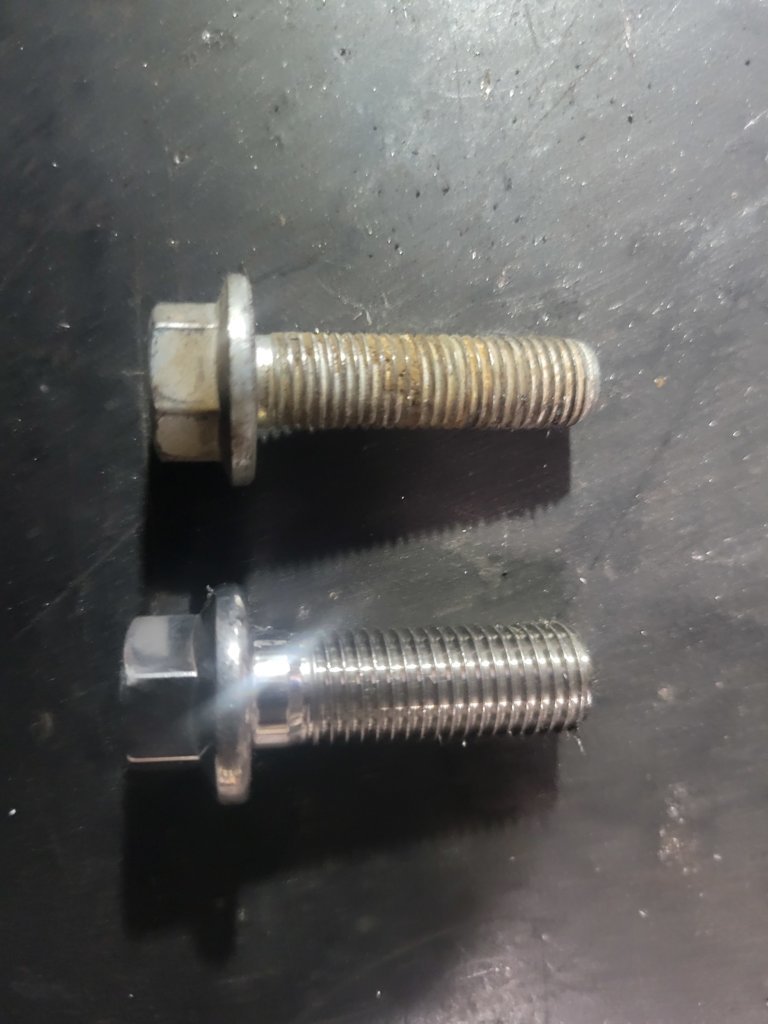

    For the record. Now that I have taken the side apart that didn't break. The LBJ bolts were the two different length, like what is provided by @TOTAL CHAOS. Therefore, my memory did not serve me. The bolts had to have been the ones provided by TC, because I have never purchased different length LBJ bolts.

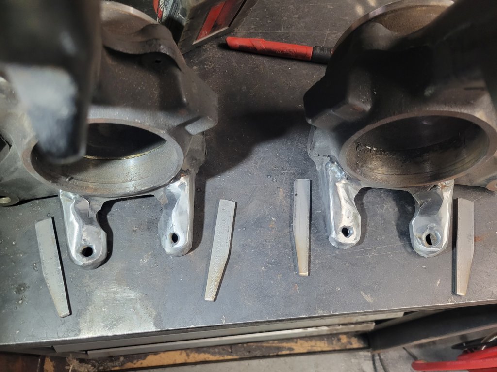

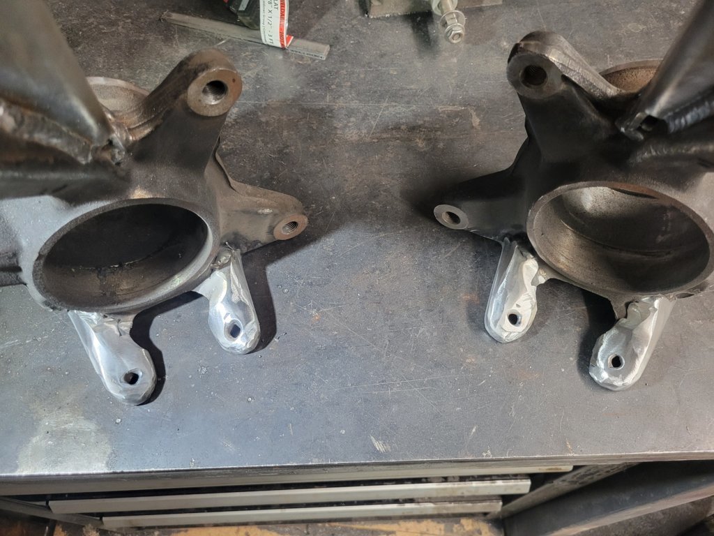

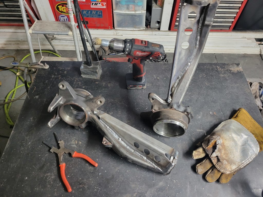

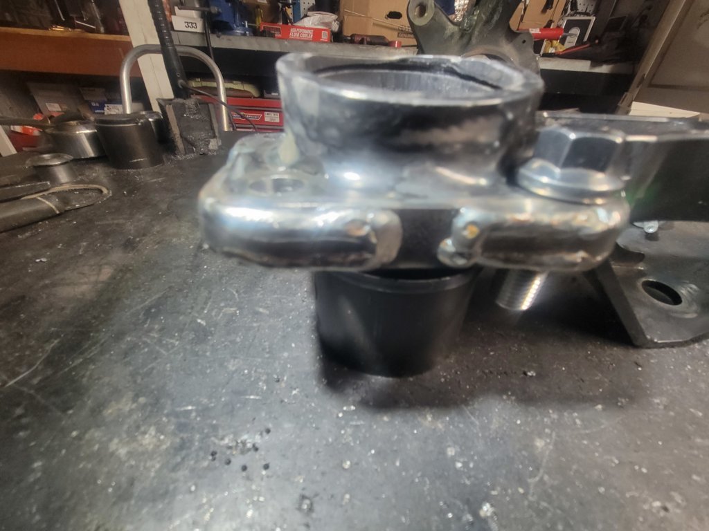

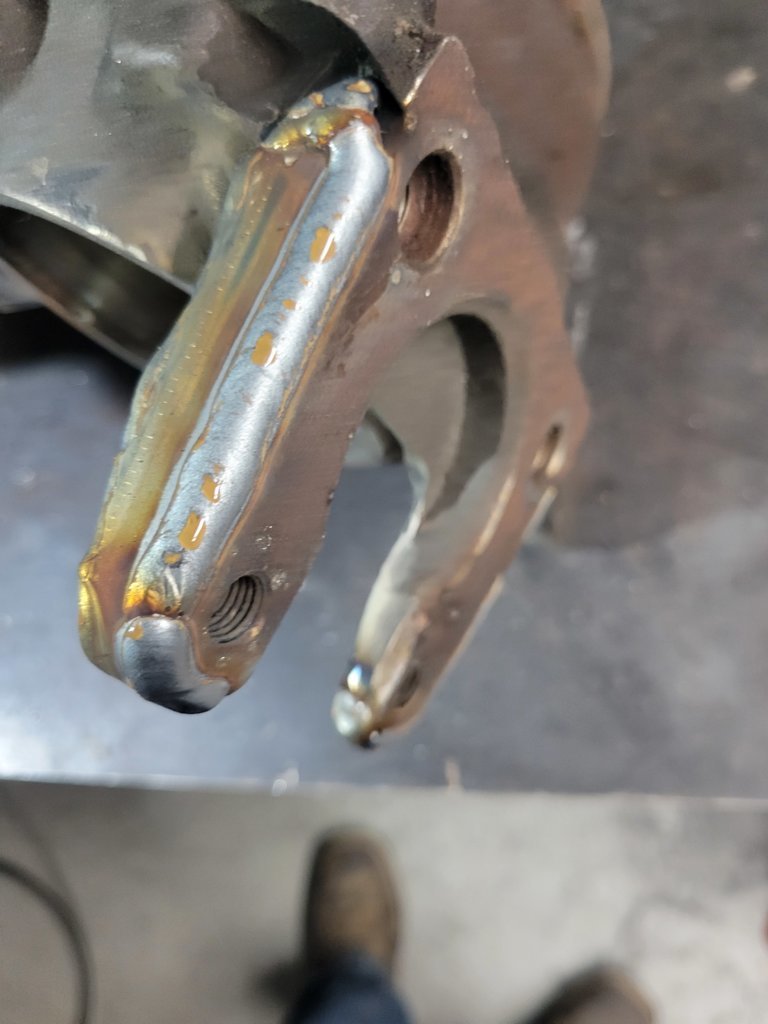

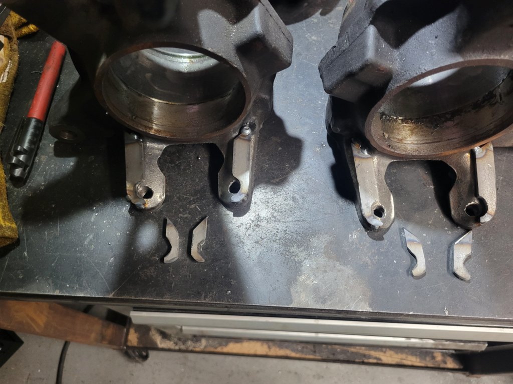

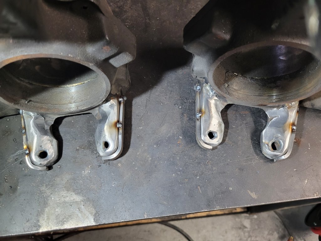

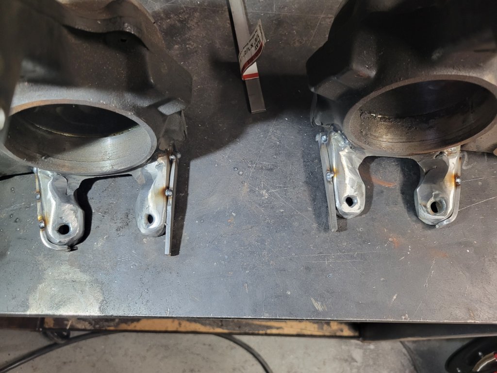

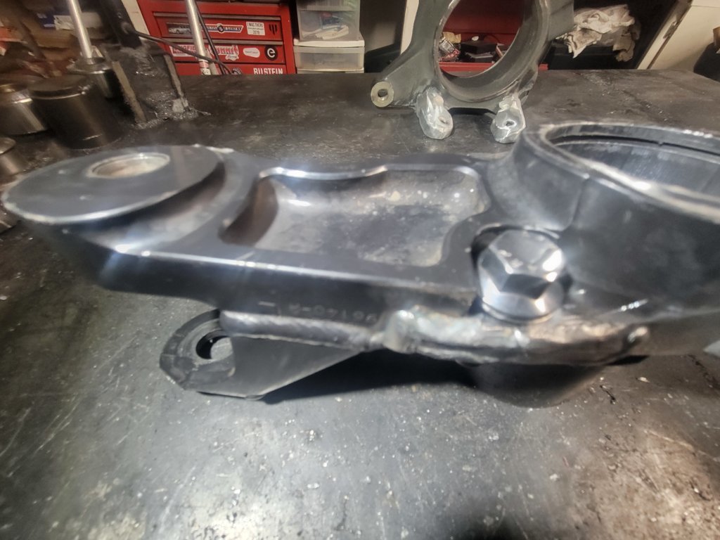

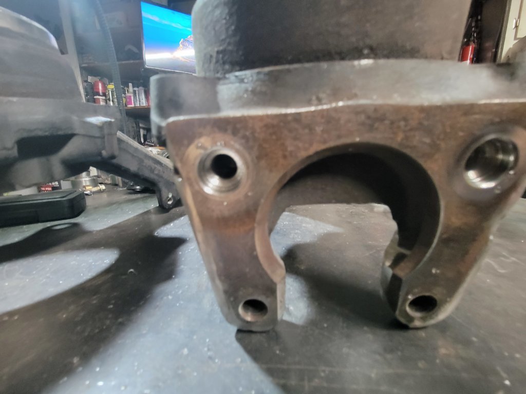

    Ok, so here's what I'm working on.
    Difference between M10 and M12 is actually not that much. But M12 is rated 30% stronger than M10.
    Working with a new (to me) set of spindles. So, I started by doing gussets.
    Then I started building up the forks of the spindles. Because I'm removing material for the larger bolts, I wanted to build them up so they didn't lose strength at the area near the (widened) bolt hole.
    20241028_183854.jpg 20241028_194559.jpg 20241029_184203.jpg 20241029_185253.jpg 20241029_185359.jpg 20241029_185409.jpg 20241029_191914.jpg 20241029_193145.jpg

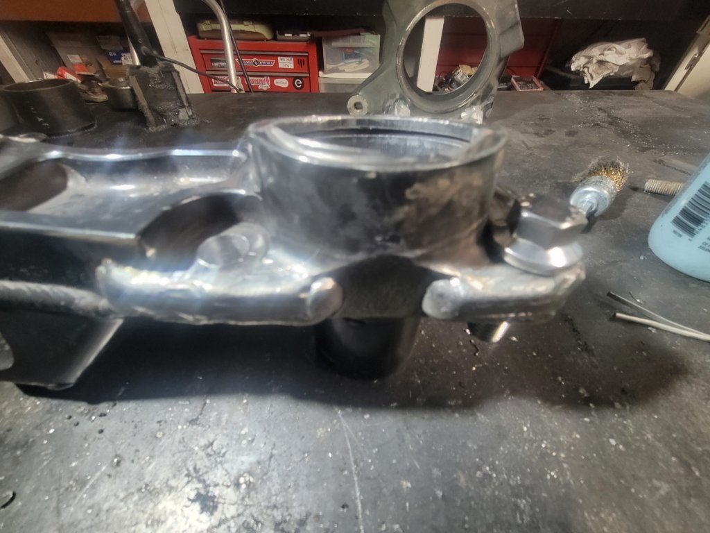

    Test fit. The LBJ still nests properly in the spindle.

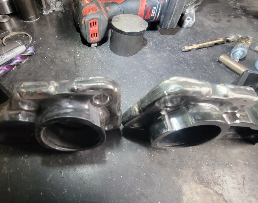

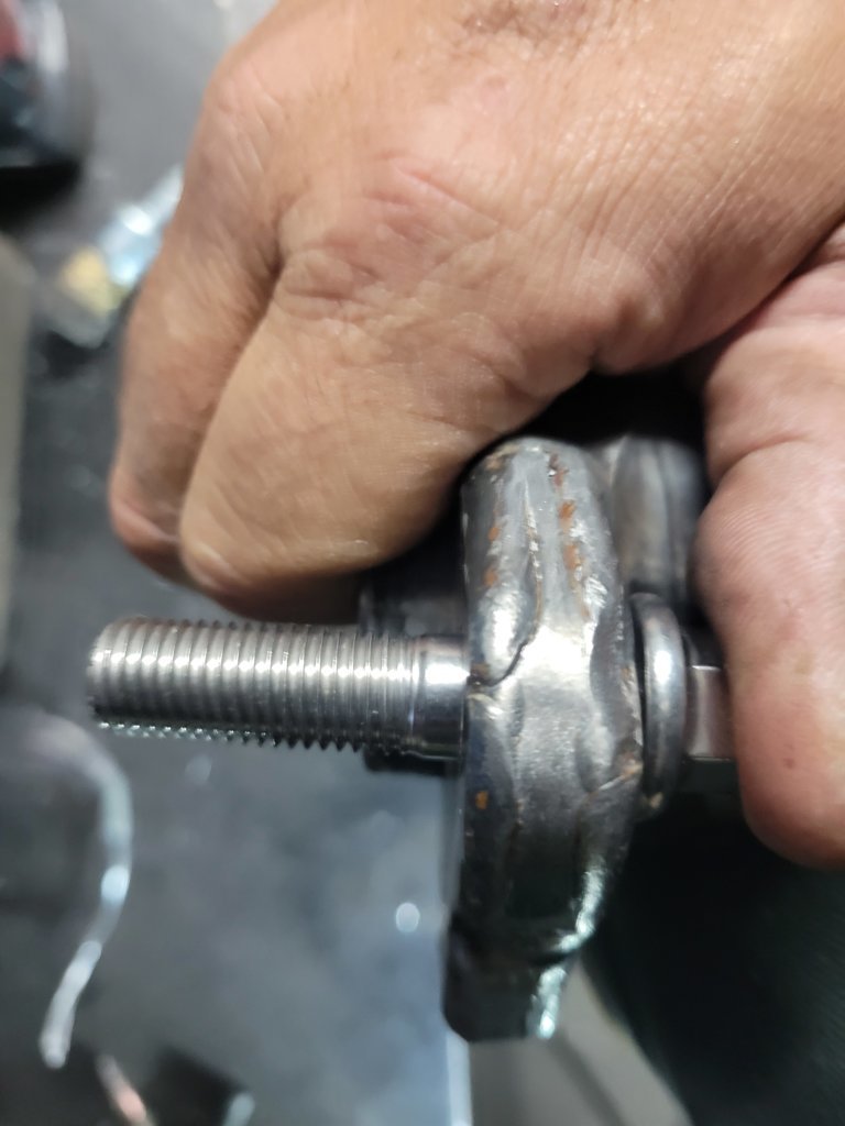

    Then I built up the LBJs... again, because I'll be opening those holes from 10mm to 12mm.

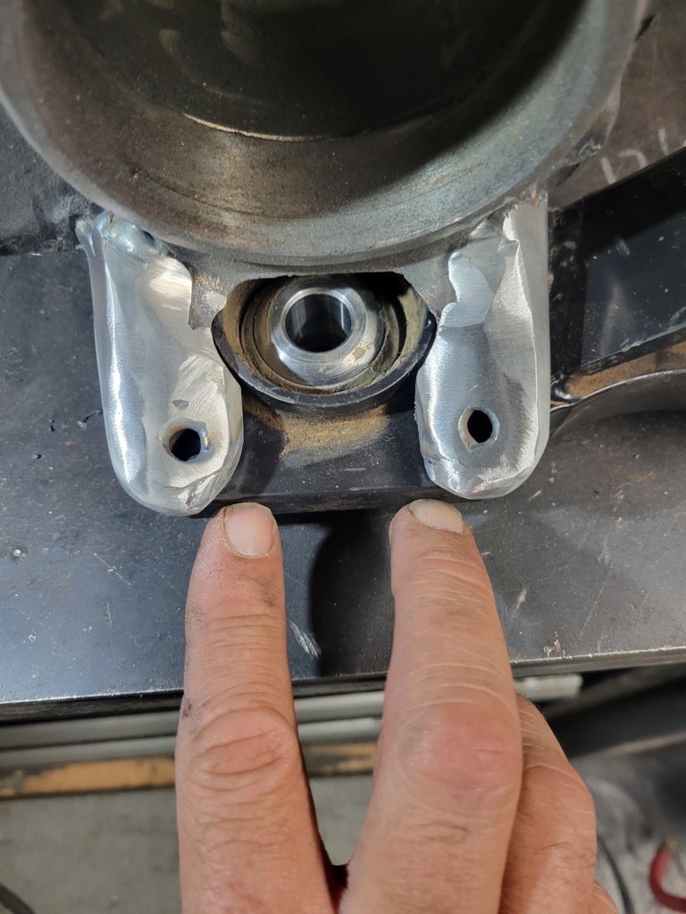

    Drilling the LBJs to 12mm
    Not sure how clear you can make out the difference between 10mm and 12mm here. The hole is about halfway drilled.

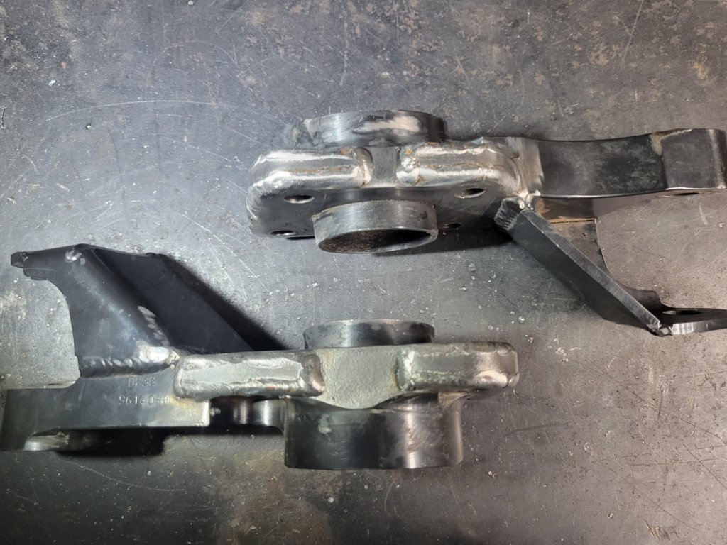

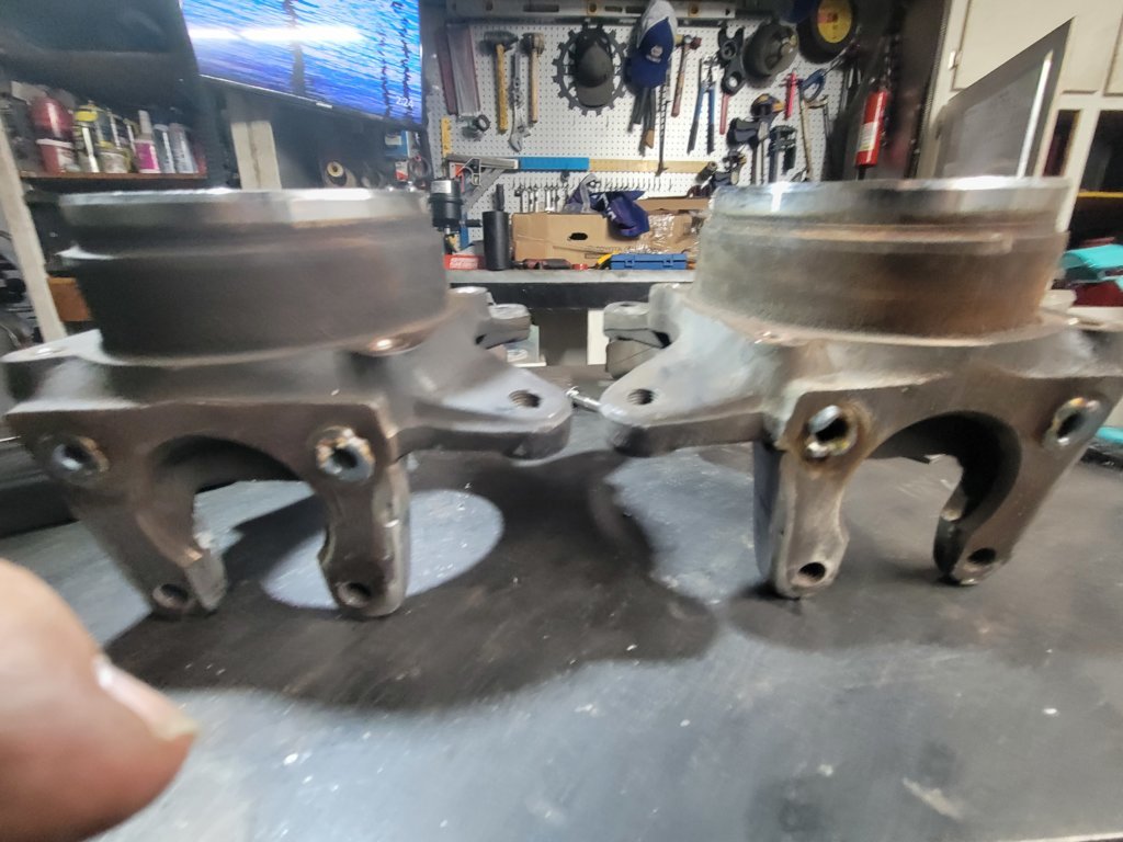

  12. Nov 23, 2024 at 12:41 PM
    #192
    El Taco Diablo
    El Taco Diablo Professional Pinstriper
    Nov 6, 2017
    #235223
    13,979
    Matt - KN6DZP
    Hughson, CA
    Impulse Red DC, 5vz-fe, 4wd swap, LT, dual case, F/R locked
    Just 3 tons of fun!!!

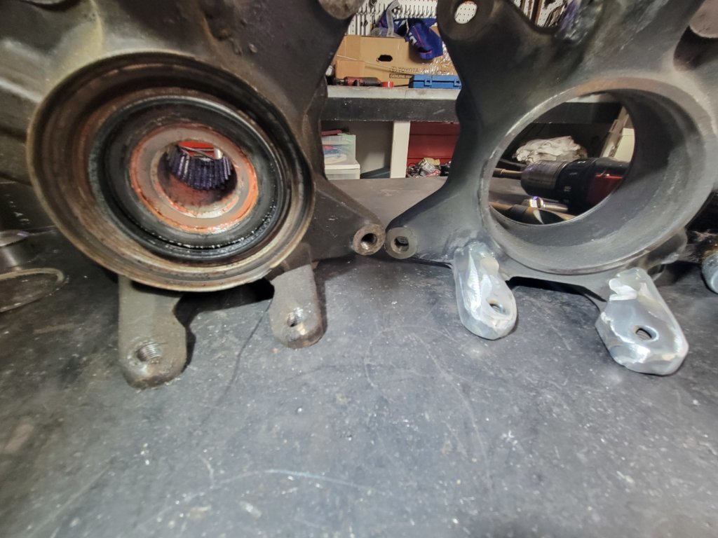

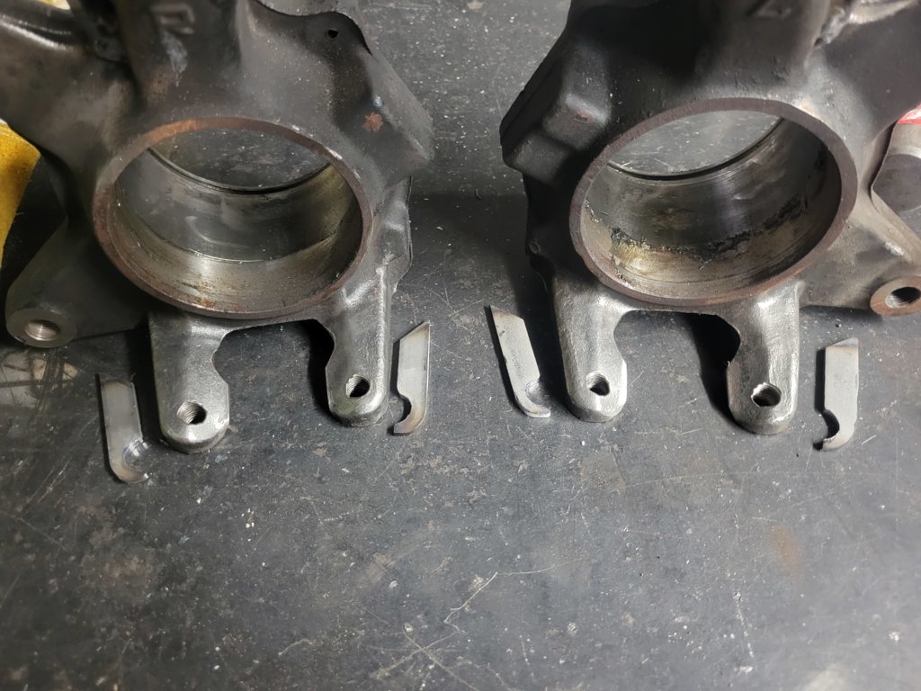

    Difference between the spindle forks before (left) and after I built them up (right).
    Not sure how clear it is... but it's quite a bit actually.

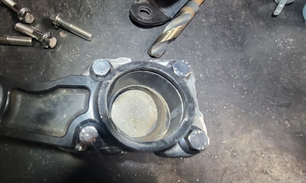

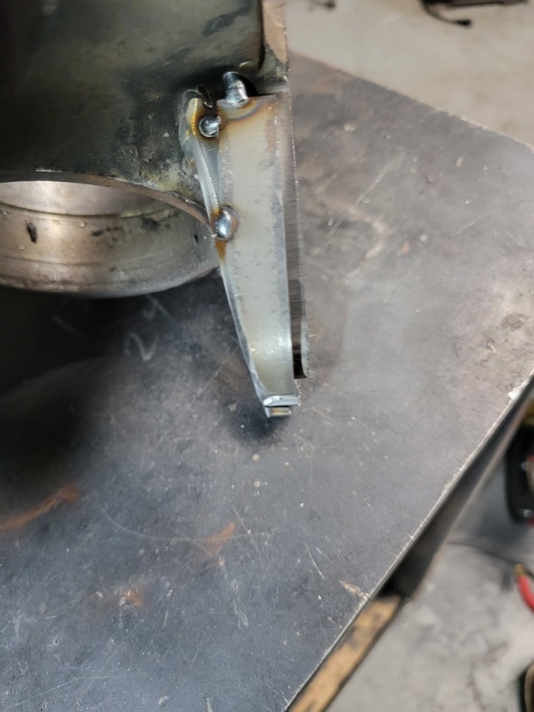

    Most of the bolt heads fit fine.
    I'll need to do a little grinding to make a couple of them fit though.

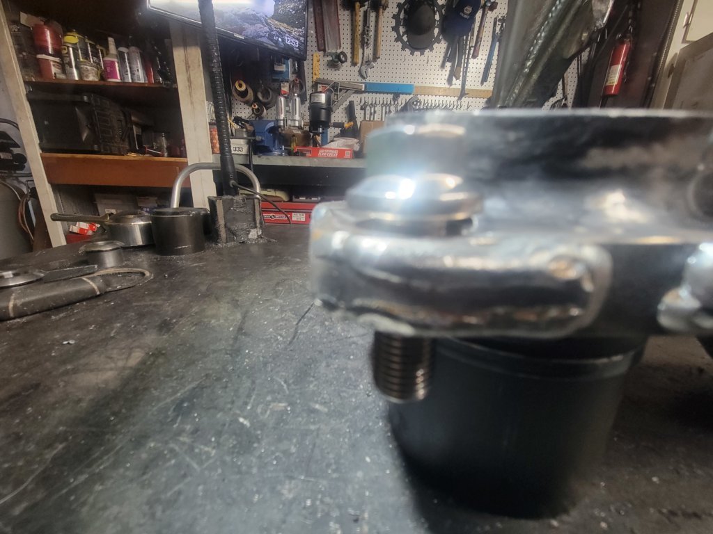

    A little bit of persuasion and all the bolt heads fit.

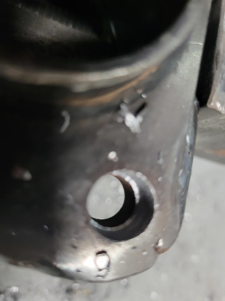

    13,979
    Matt - KN6DZP
    Hughson, CA

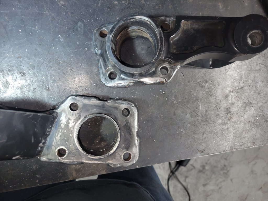

    The holes that allow the locator sleave are about 12.85 mm. I need them to be 12 mm.
    So I welded them in. I'll drill them back out to 10.5 so I can tap 12 mm x 1.5 threads. Then I will counter sink 12 mm about 4 mm deep so the shoulder of the bolt will be the locator.
    The shoulder of the bolt will take the place of the locator sleave.
    TACOTU3 likes this.
