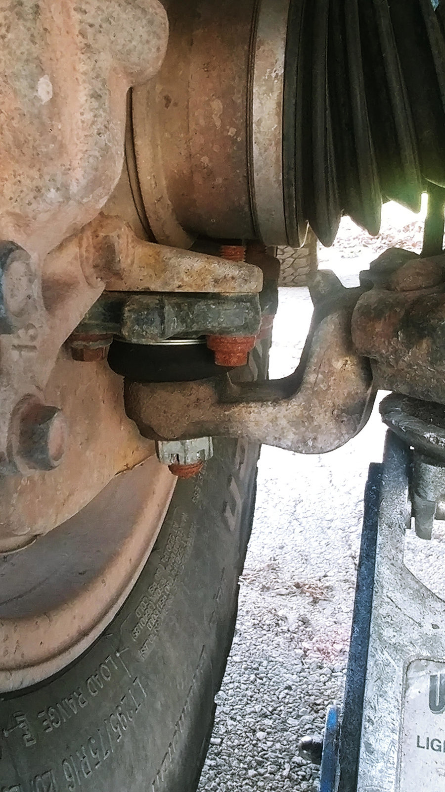

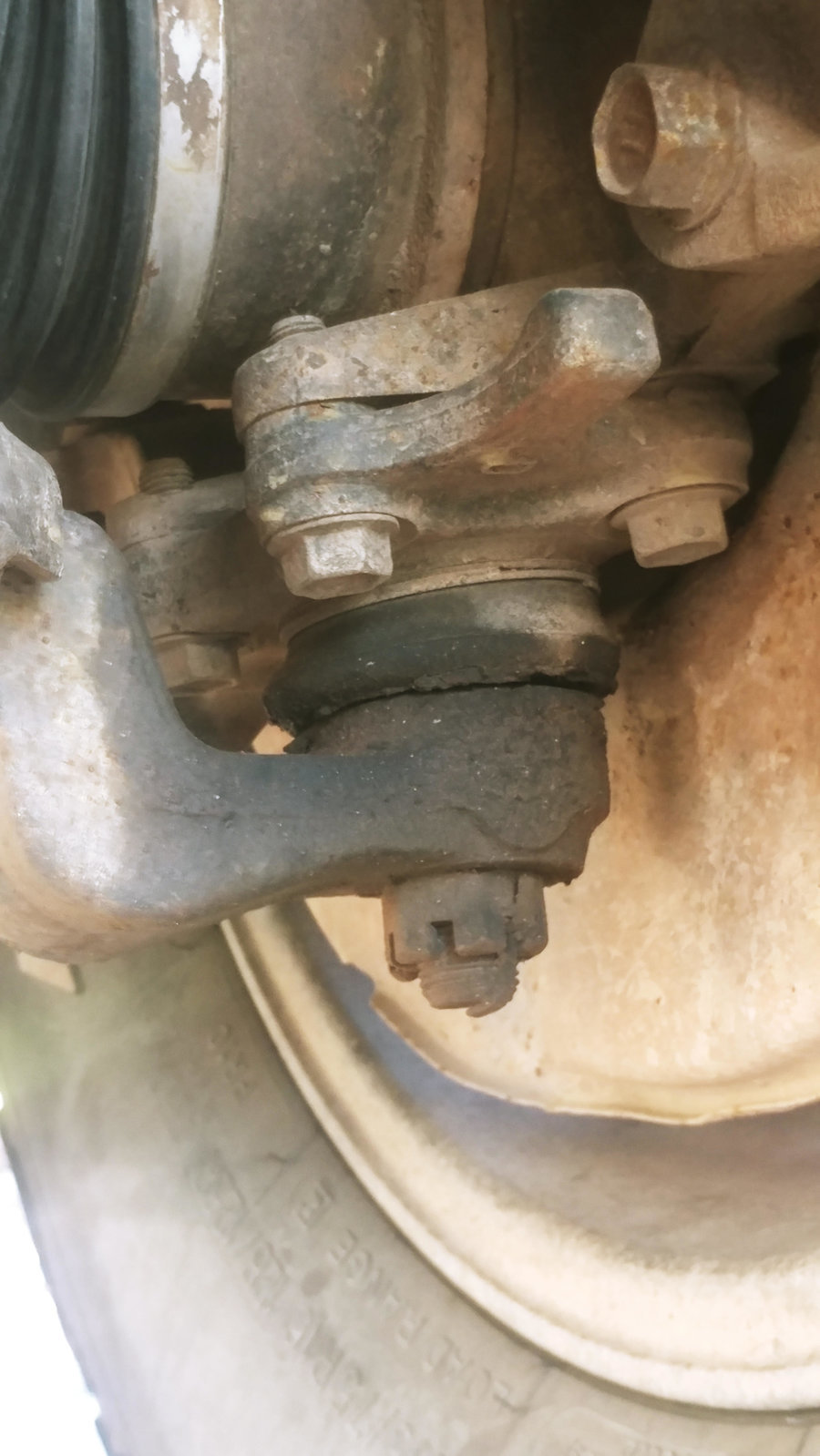

    Not wanting to hold folks in suspense, the issue I was made aware of was with the ARP bolts (I know, a collective "oh s**t" sigh).
    There was no problem with the bolt strength, or any of the data we collected, which are the important things. However, I was made aware by a friend in St Louis that her ARP bolts rusted badly within 8 months. In retrospect, it's not a big surprise, the ARP bolts we tested are finished in black oxide, which has very little resistance to the elements, compared to zinc plated bolts. So they really are not meant for areas exposed to weather, like suspension.
    You can still use them, perhaps hit them with a coat of paint after installation. However, I am more inclined to go with ARP stainless steel series, since they'll be more resistant to corrosion. I haven't done the testing on them yet, which is why I have been holding off on bringing this up, but I will report back after I run some tests. I expect them to perform as well as or better than the ARP black oxide bolts.
    Stay tuned!
    Here are the ARP bolts after only 8 months:
    And here are the factory zinc plated bolts after 6 years - in the same rig:

    Whoa. I've had mine for over a year and they're still black, even though I've removed them a few times to swap broken axles.
