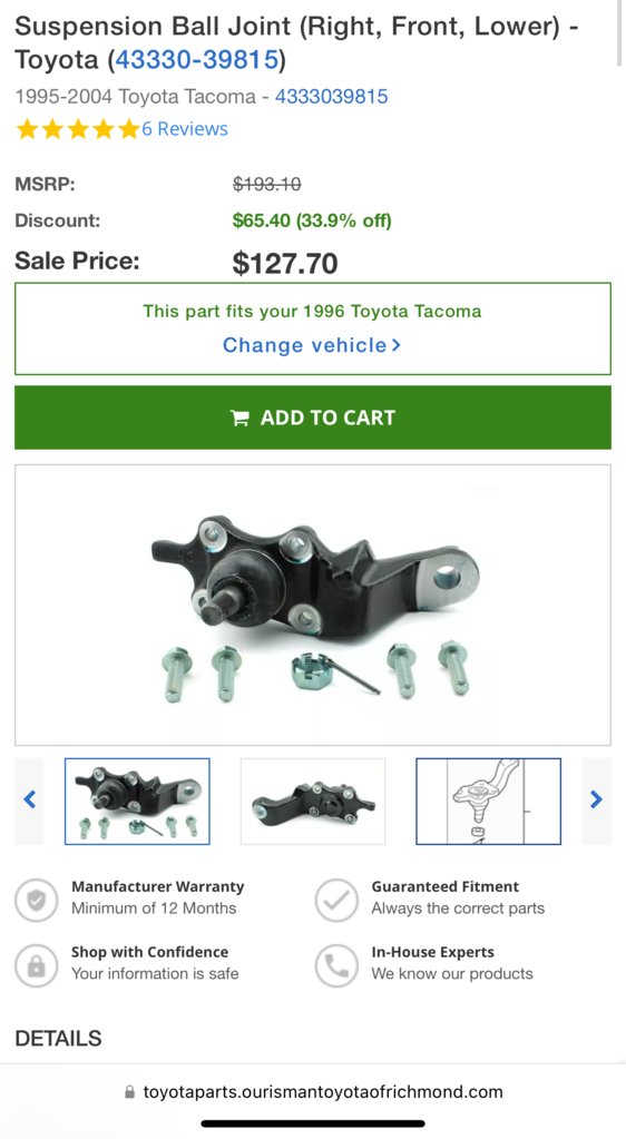

    Im getting my LCAs replaced so my truck can hold an alignment and my mechanic said the LBJs should be replaced at the same time since it’s hard to pry the control arms and ball joints apart without ripping the rubber and/or possibly damaging some other part of the joint. My OEM joints only have 20k or so miles on them though. Does anyone have experience with this?
    Also, the part I found on Ourisman Toyota comes with hardware - does anyone know the torque specs for these? I recall there being some disagreement on what they should be torqued to. Thanks.

    That sounds like a ridiculous statement to me. I've removed my LBJs many times (to replace them) and have never ripped the rubber boot or damaged them in any way. That's the whole point of a pitman arm puller.
    Those are the green bolts. 59 ft-lbs.
    You can look through everything involved in the process, with photos, here: Step-by-Step Replacing Lower Ball Joints (LBJ) on a 1st Gen Tacoma – AdventureTaco

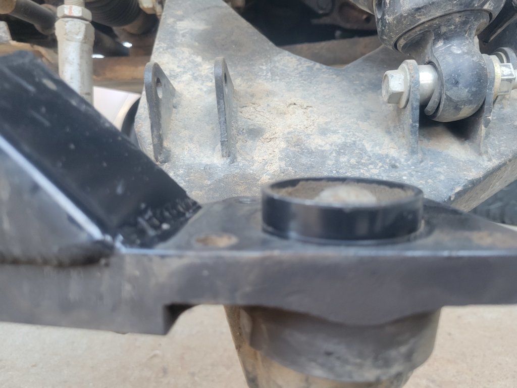

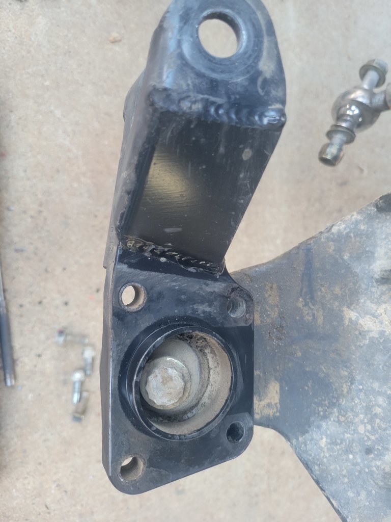

    Disassembly underway.
    One thing I found interesting. The locater sleeves are completely GONE. (This is the side that did NOT break).
    Tuluk and JTFisherman like this.

    are the missing sleeves same size as OEM sleeves?

    It'll be kind of hard to tell. Being as the missing sleeves are... not here to measure.

    I think they would since it fits into the spindle, right? Have you given any thought into filling the spindle space between the inner bolt holes? Between the 2 ears where the bolt holes are.

    Mine are machined out. Looks like yours are actually sleeved like OEM or am I seeing it wrong?

    You are correct. Mine were sleeve like OEM. You can see where the sleeves were broken off where it's flush on the LBJ.

    Interesting. I wonder when they changed that design. When did you buy yours?

    May of 03

    Sorry, I meant the TC lbjs. I’m guessing they had a redesign at some point.

    I'm surprised they were machined out of the billet chunk vs being pressed/tapped in roll pins like the ones that line up a cylinder head. Making them out of the original body of the BJ conversion makes them a very thin feature.
