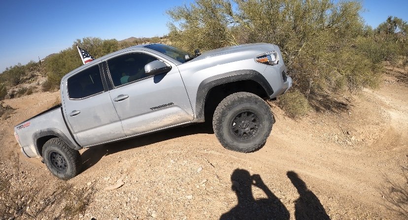

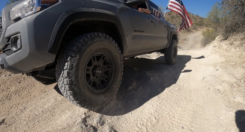

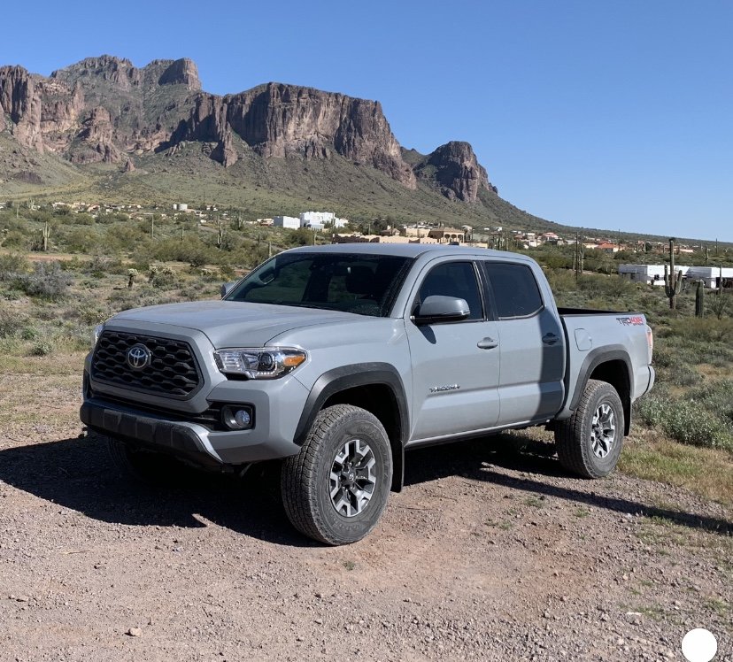

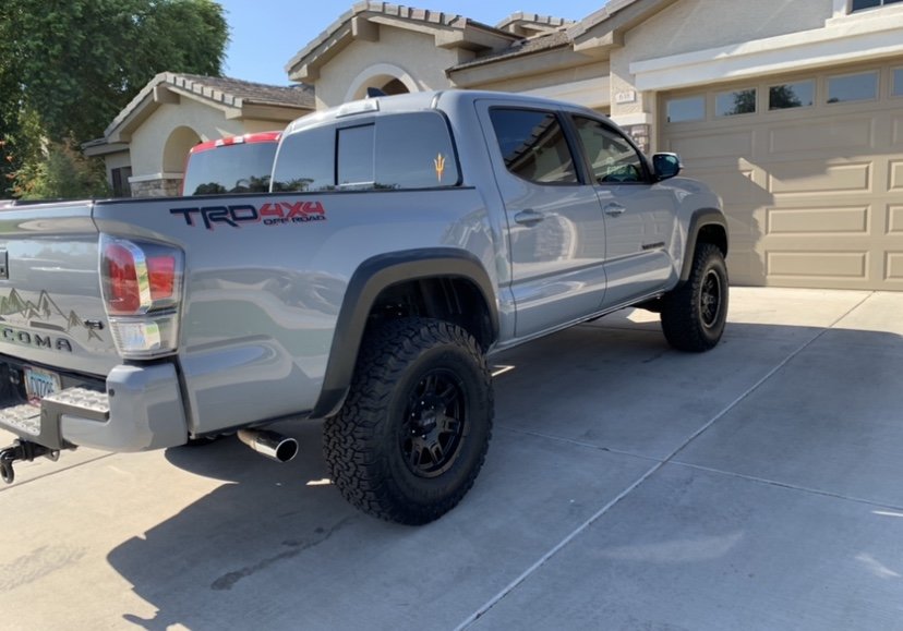

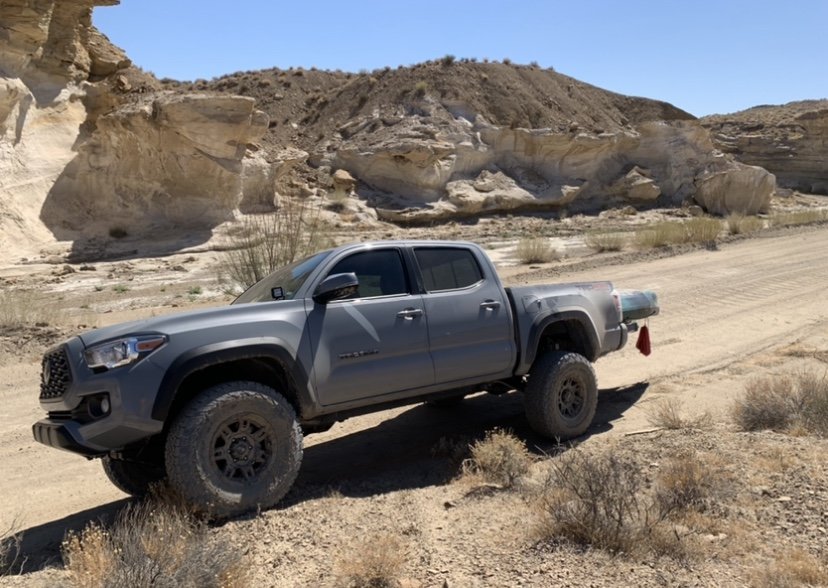

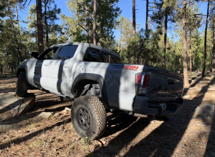

    Let me know if you guys have any questions at all. I'm going to make a youtube video covering this and will update with that link, which will show it offroading for your comfort, when I'm done with the video. For now here's some pic before and after.
