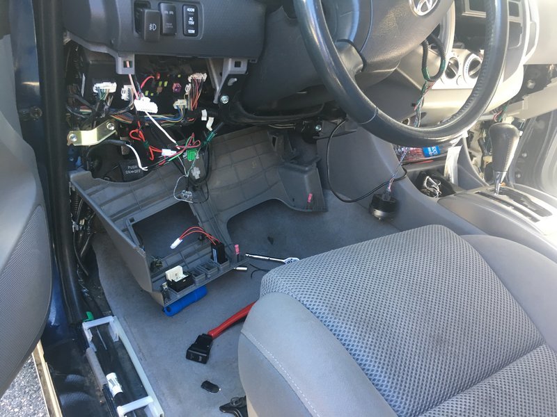

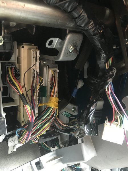

    Why did Toyota decide to put 2 :censored: gray wires in the wiring harness?!? And both are without a stripe! One goes to add and one to t-case... So after the last 2 weekends of fighting the harness I was about to quit and decided to test all the wires before stoping, thinking one was broken in the harness.. Well none were. I mixed up the gray wires.. :frusty:
    Downloaded the scribd app that has the wiring diagram for the 05(close enough) I found that my truck is wired for a 4wd computer that only controls the rear dif lock (which I don't have) but that connector is set up for power and the vss pins. The neutral switch I have the wire taped but not sure if I'm going to run that or send it to constant power yetimage.jpg
    The white connector to the right was taped up to the dash harness , this is the 4wd computer connector. The purple-white strip is the vss signal. This can also be found at the 2nd connector from bottom at ecu. The neutral switch wire is blue-white strip goes into the second connector from the top on the junction box.
    If anyone is interested the red-white strip located in the black connector on he left of the pic is +12v when in reverse for reverse lights.
    So now my next step is to get hubs in and install add, as well as extend the wiring harness so everything reaches the locations I want them in. :bananadance:

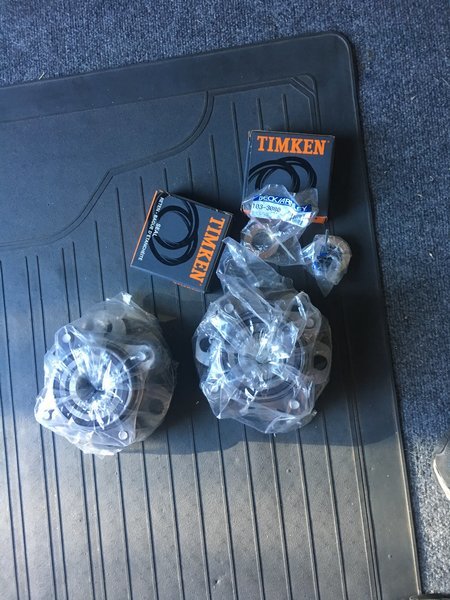

    Thanks @nj636 for the hubs, they look great and should make installing the front dif easier. IMG_2641.jpgGot all the wires soldered and ran for the dash switches. Now after 3 weekends I can put the dash back together and ready for the hard parts to be installed :bananadance::yay::woot:IMG_2642.jpg

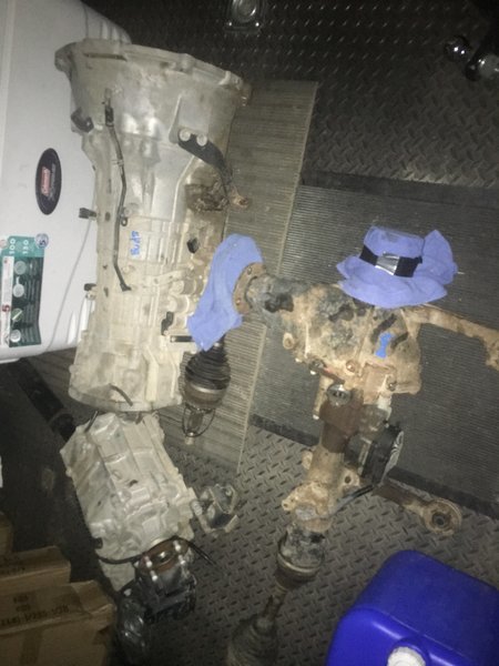

    I'm a horse
    Asgard
    Furd F150 Ecoboost
    What were all the parts you sourced for the conversion? I see a tranny, transfer case but not sure what the other piece is or what other parts you needed also.
    Good luck btw :thumbsup:
    ChadsPride likes this.
  15. Sep 20, 2016 at 10:04 AM
    YamaDirtrider
    YamaDirtrider [OP] Custom armor @FORT-ifyRigs
    Mar 1, 2016
    #179877
    5,656
    Josh
    Parker Co
    06 DCLB sport prerunner
    What hasn't been modified?
    Also got the front diff with cv axels (they piled the joint apart at the dif, the blue rags are covering the greese)
    4wd tranny crossmember with mount
    Front driveshaft
    yoke end that's on the 4wd shaft connects to tcase
    Most mounting bolts
    4wd computer
    Center dif lock switch
    4x4 switch
    The electronics I got as much as possible without spending hours tearing it apart
