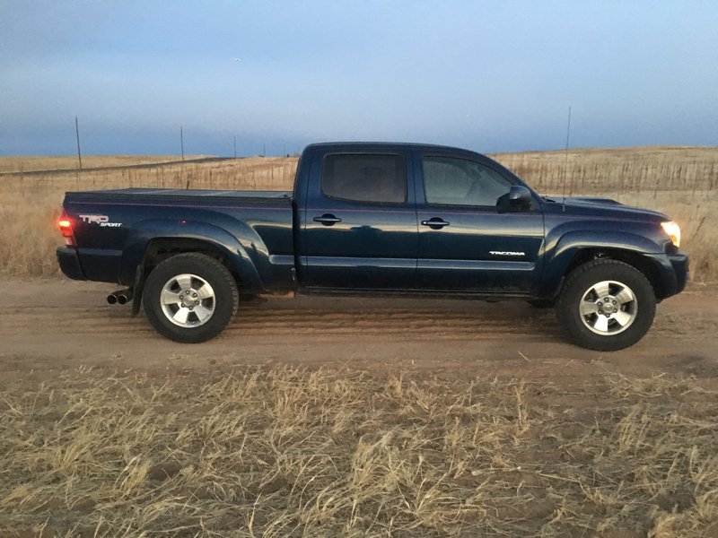

    Got the lift installed finally!
    Truck sits almost level now.
    Thanks to @3378jakesr5 for helping install it. IMG_2737.jpgNext peoject is to finish ar build. O, and repair more wires the rat chewed....

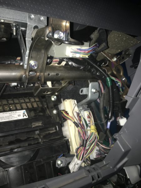

    Did you used the 4runner 4WD ecu?, any pics?
  18. Jan 1, 2017 at 5:22 PM
    #58
    YamaDirtrider
    YamaDirtrider [OP] Custom bumpers @FORT-ifyRigs
    Mar 1, 2016
    #179877
    6,344
    Josh
    Elizabeth CO
    06 DCLB sport postrunner
    What hasn't been modified?
    Yea. I used the 4Runner 4wd computer. And attached the speed sensor and neutral switch wire. Tucked the computer up under the passenger side dash close to the airbag IMG_2692.jpgThe gray box at top of pic is the computer.
    There was a connector taped up in the corner that must have been for the off road model's locker, that's where the power, ground and vss all are located
