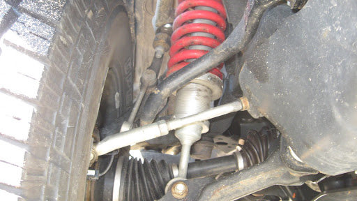

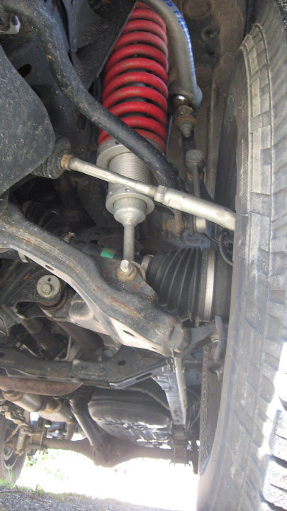

    So I have the toytec ultimate lift on my '08 tacoma, but to me the angles on the cv joints look to be a little much. Wanted to see what other people thought about it. I will mention though that there isn't any driving issues what so ever. The only thing so far is one of the cv boots tore open on the highway, spraying axle grease everywhere. Luckily warranty covers that, so got a new one for free.
    Enough talk though! Here's some pictures.
    IMG_6447_55b1fd488e774ef5ad1e09ad20176638a9b9dbd5.jpg IMG_6453_8a77cfdbf4ca0eb460ae0eabcbe624ec8d5fdc9a.jpg

    Truthfully I'm surprised they covered it under warranty. The angles are a bit much.

    Looking at your upper control arms I would say that you have more lift than your truck can handle. They are almost coming in contact with your coil. You're gonna get the death diff, like me.

    The torn boot says it all. The angle is most likely too steep (based off lifted Ram 1500 experiences) . I have zero experience with Toyota but I'm shocked they replaced that boot under warranty with the suspension being modified.

    Way too much lift. you have 0 down travel from where it is sitting + you will continue to tear cv boots like that.

    the fins on your cv boots are touching which continue to wear through.
    You can lower the front no problem, you will however have to get an alignment again after you lower the front ride height.
