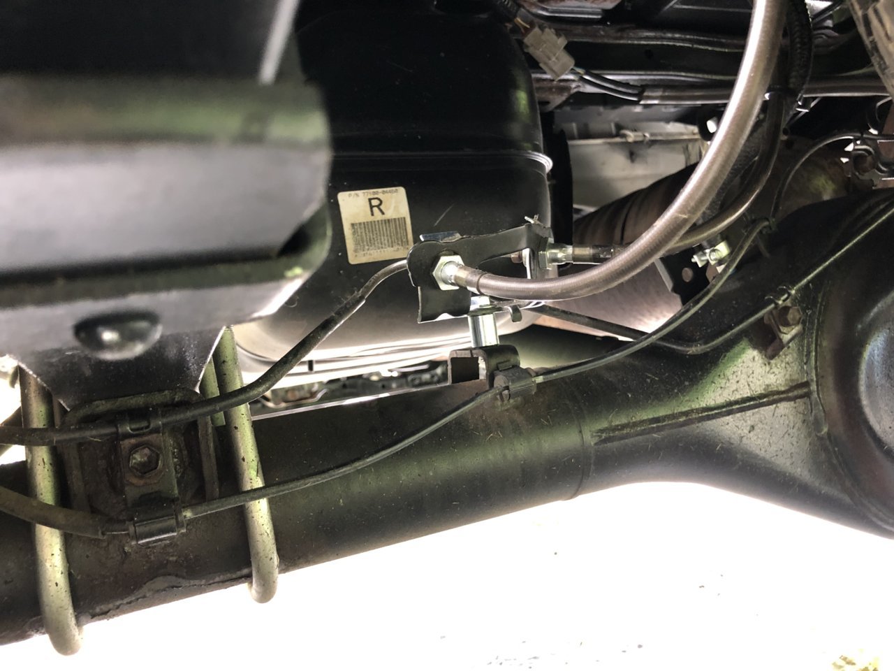

    F
    Forgot to measure the shock when it was on the lift today.
    I did measure from the bottom of the flare to the top of the tire:
    on the ground - 9 1/2" est.
    on the lift - 15 3/4" est.
    Also, the passenger leaf spring hits the exhaust when it's on the lift.
    I added a 3/4" spacer to the brake hose bracket and unclipped the ABS harness.
    I also installed the two missing leaf spring pads.
