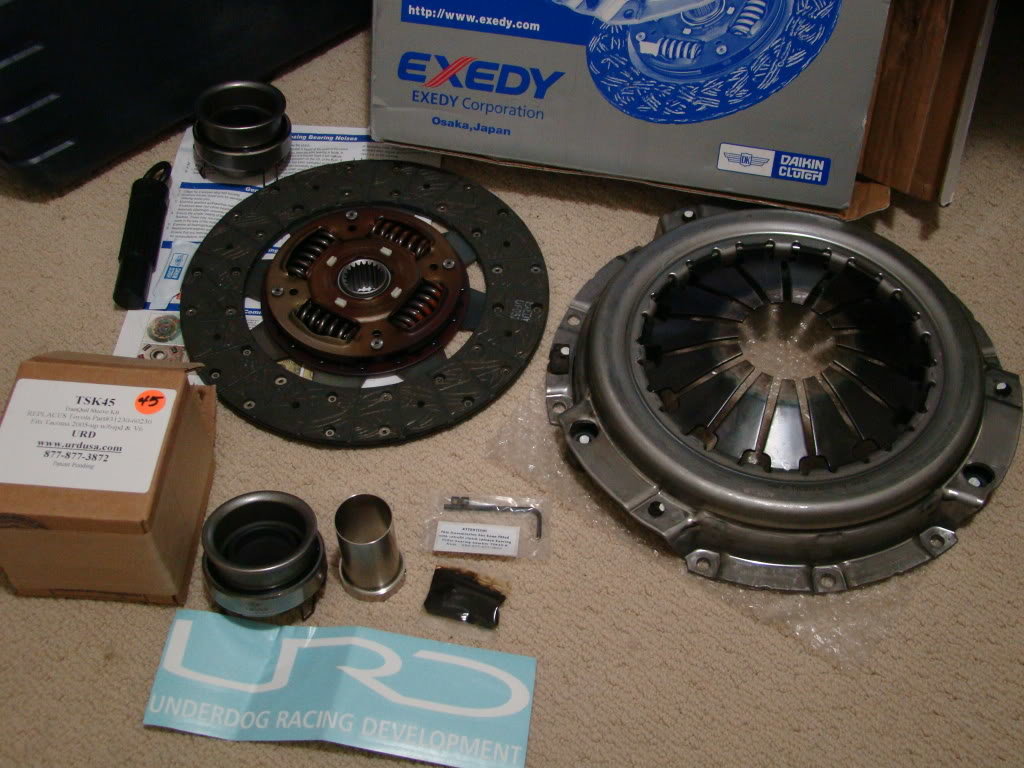

    Ive search around before but couldnt find anyone with exedy clutches on their tacoma's as my TOB started chirping about 3 weeks ago @ 53kms.

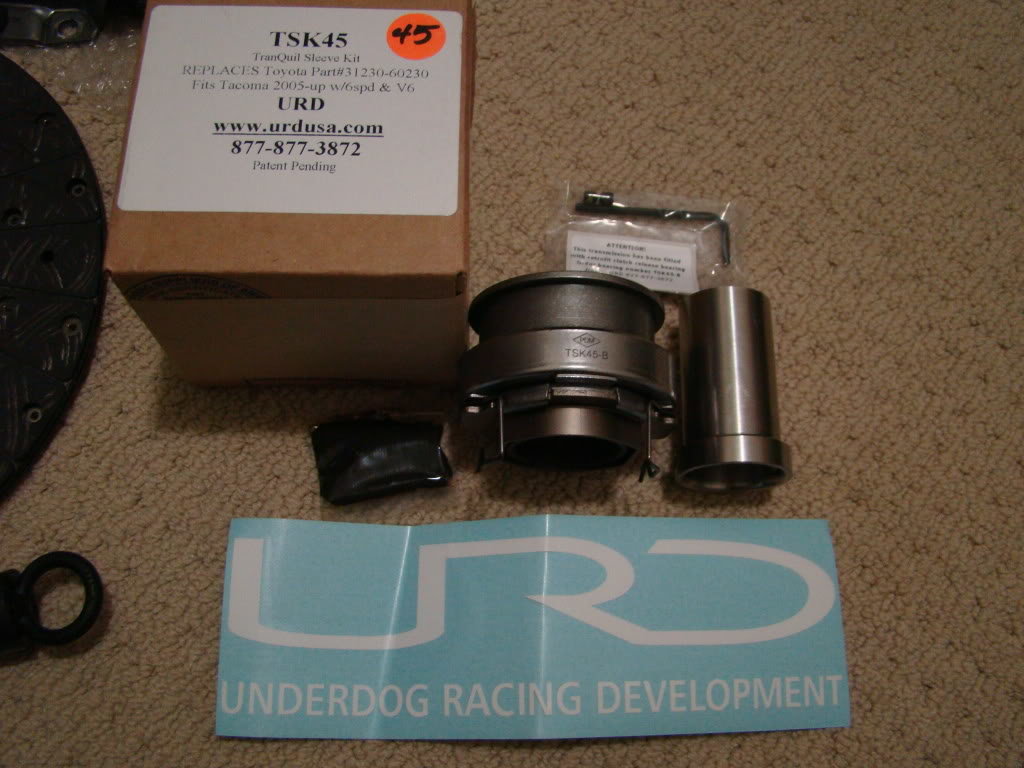

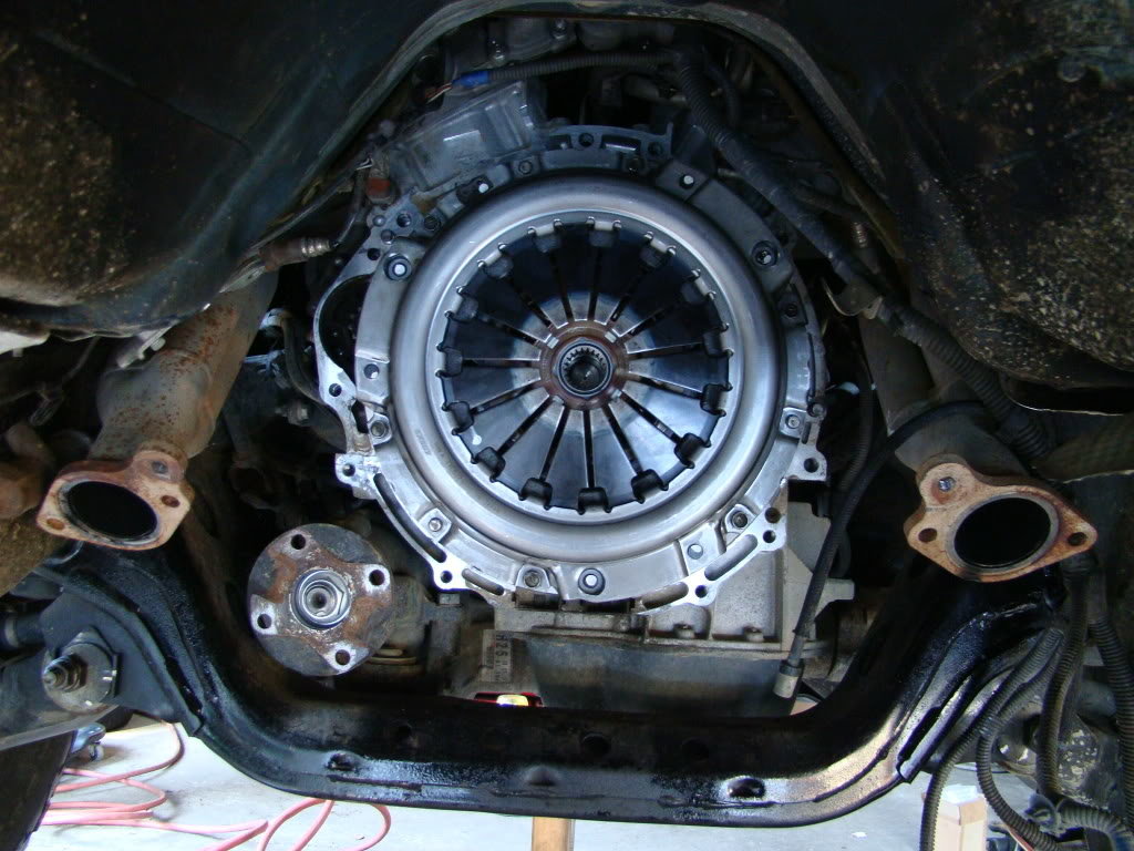

    Installed the OEM Exedy clutch kit with the upgraded TOB kit from URD over the weekend.
    Clutch is much better than the stock AISIN from toyota. Pedal feel is about 25% lighter. That spongy feeling is also gone. Engages quick and smooth. It pretty much feels like driving a car, clutch wise. I couldnt be happier.
    The input shaft also had some wear from the bearing so Im glad I got the TSK for that.
    $206 for the clutch at Amazon.
    $225+shipping for the bearing.

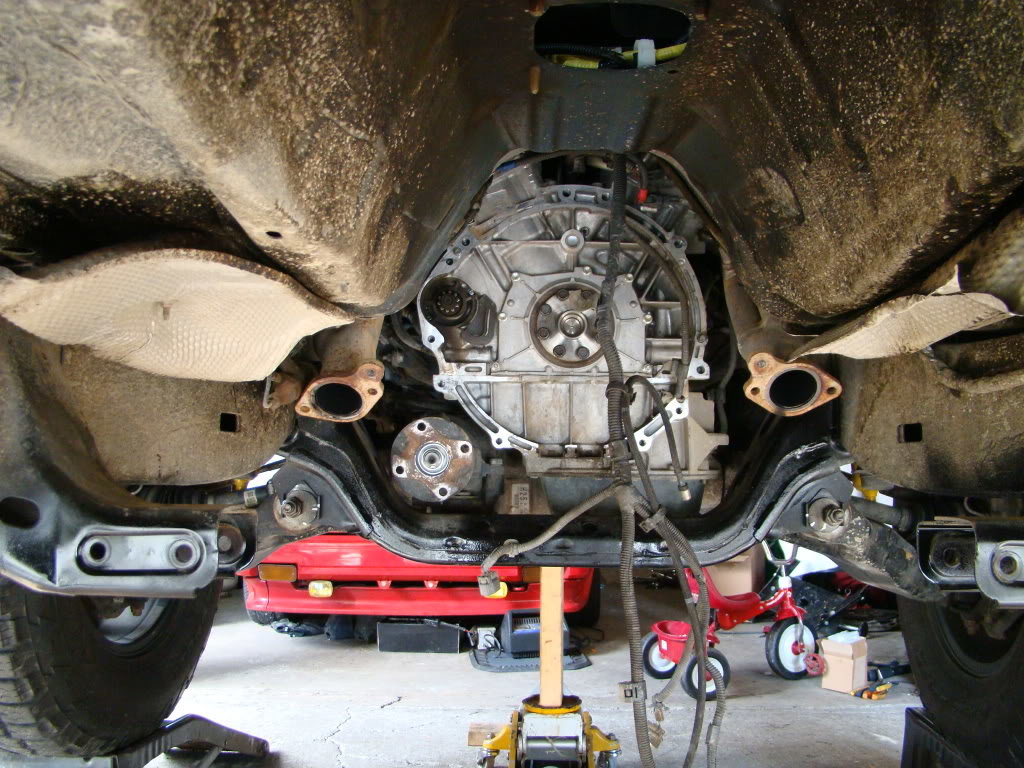

    About 8 hours of backbreaking labour :D
    CLUTCH OUT
    CLUTCH IN
