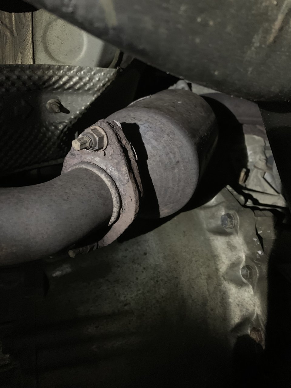

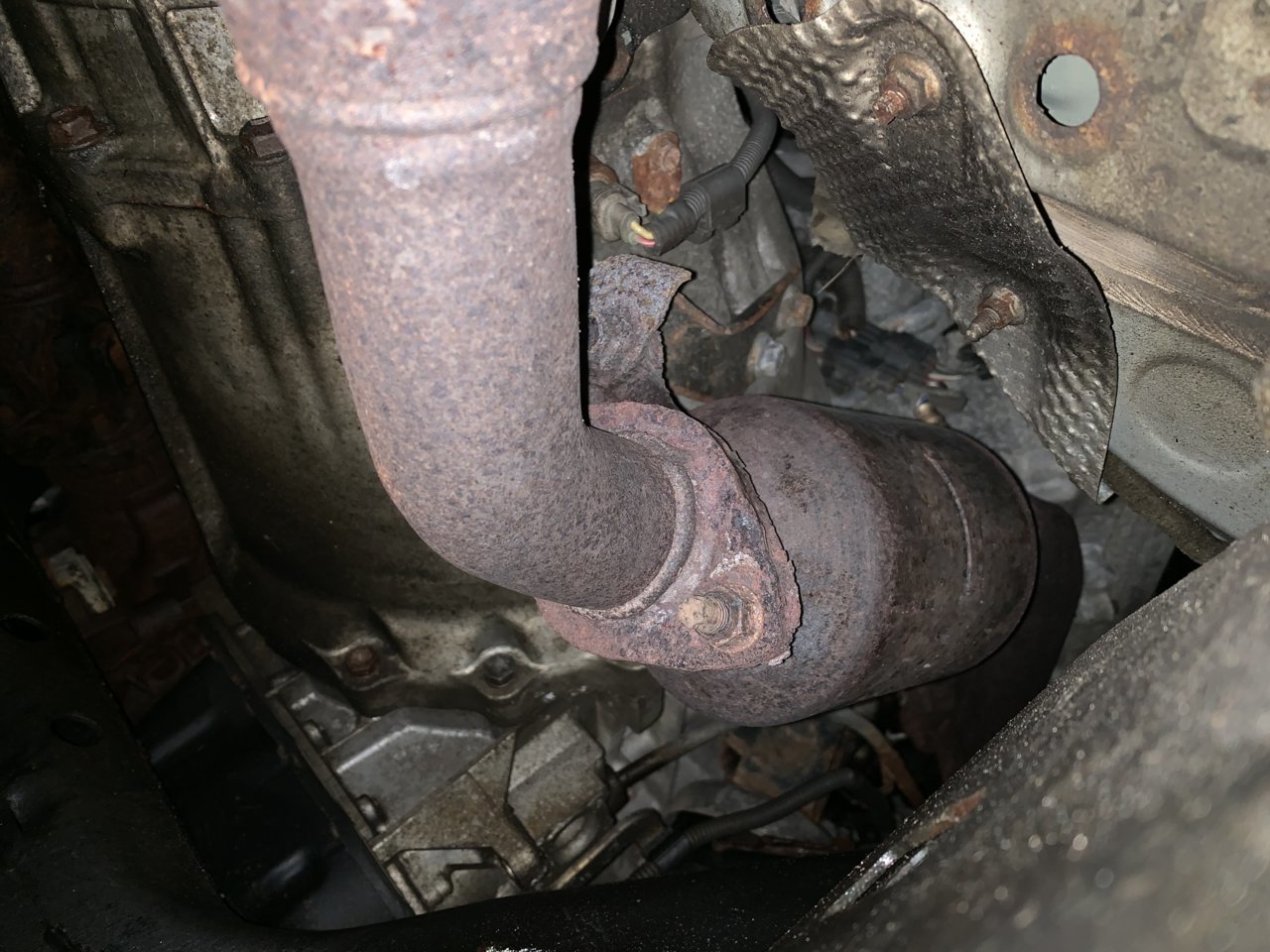

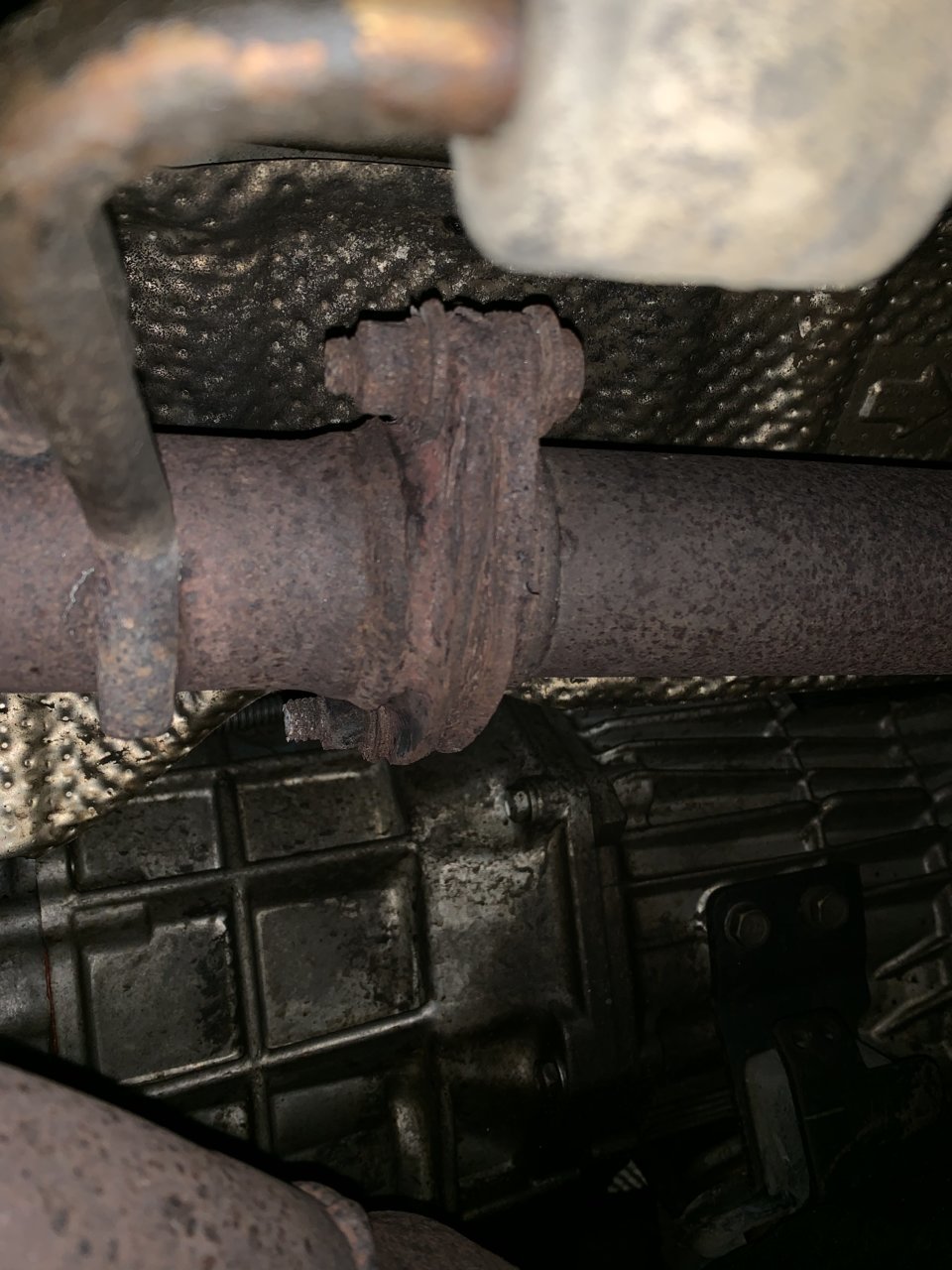

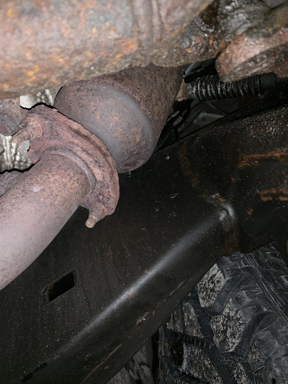

    My exhaust is leaking from several junction points and I’m looking for an opinion on the best way to fix the leaks. Should I attempt to fix the leaks myself or just being to a shop?
    It’s essentially leaking from all connection points at the middle of the exhaust system between the headers and the cat/muffler.
    On the drivers side coming from the headers here:F370E7CE-A94C-44DB-A4EE-4FFB484A78FB.jpg
    Passenger side coming from the headers here:176281F3-8DC6-42BB-91CF-921578CCD176.jpg
    And headed back towards the cat/muffler here:31F07C53-221E-4EC7-969F-CA6B89533463.jpg

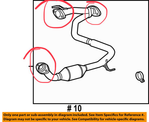

    I’ve circled the leaky points here:
    I don’t have much experience with exhaust so how bad of a fix is this?

  2. Jan 16, 2019 at 5:42 PM

    OP, the OEM gaskets for the areas you have circled are a bit pricey IMHO. I have sourced some aftermarket which appear to be the same or nearly the same and use them on mine. I can see possibly breaking off a stud or nut on those flanges if way rusted but no big deal they are available as spare parts. If you do not feel warm and fuzzy about doing it yourself I bet a muffler shop would do it relatively inexpensive but if this were mine I would first inquire with them about possibly bringing your own parts. Some are ok and some not.

    Looks like I sourced mine from Rock Auto and used primarily Fel-Pro gaskets and a Walker bolt/spacer/spring kit. OEM part numbers are also included.
    Gaskets
    - At flange where the cats first attach to header manifolds, both sides: Fel-Pro 61040, need 2. OEM is 90080-43036
    - At RH (pass side) where cat flange attaches to downstream connecting pipe: Fel-Pro 61040, need 1. OEM is 90917-06083 but the Fel-Pro 61040 also works fine there.
    - At flange where both cats merge together and downstream where they connect to the muffler pipe piece: Fel-Pro 61106, need 1. OEM is 17451-0A010
    Hardware
    - Nuts at the flange connecting both cats to header exhaust manifolds on both sides: OEM are 90080-17187, need 4
    - Bolts connecting RH (pass) cat at flange to downstream connecting pipe: OEM are 90080-10064, need 2
    - Nuts for the two bolts immediately above connecting RH (pass) cat at flange to downstream connecting pipe: OEM are 90177-A0004, need 2
    - Two long spacers, bolts/springs at flange where both cats merge together and downstream where they connect to the muffler pipe piece: Walker is 36454, need 1 kit. OEM is 17451-0A010, need 2

    In the second pic it looks like a weld has failed? And the hardware looks newer there. It looks like this has been apart at least once before. The last picture hardware doesn't look factory, but dunno as I have a 4 cylinder.
    Buy all new hardware before you start- it's unlikely you'll get any of those joints apart without breaking bolts unless you have an oxy-acetylene torch. I was able to get my 4 cylinder exhaust apart but I have an OA torch. If those are studs on the end of the converters and if they break you'll be drilling and replacing. If I didn't have an OA torch I'd buy the supplies and see what a local exhaust shop would charge to change it out. Since they'll have a proper torch and a lift they'll do it fast as they do this all the time. And if that joint has failed they might be able to weld it back.
