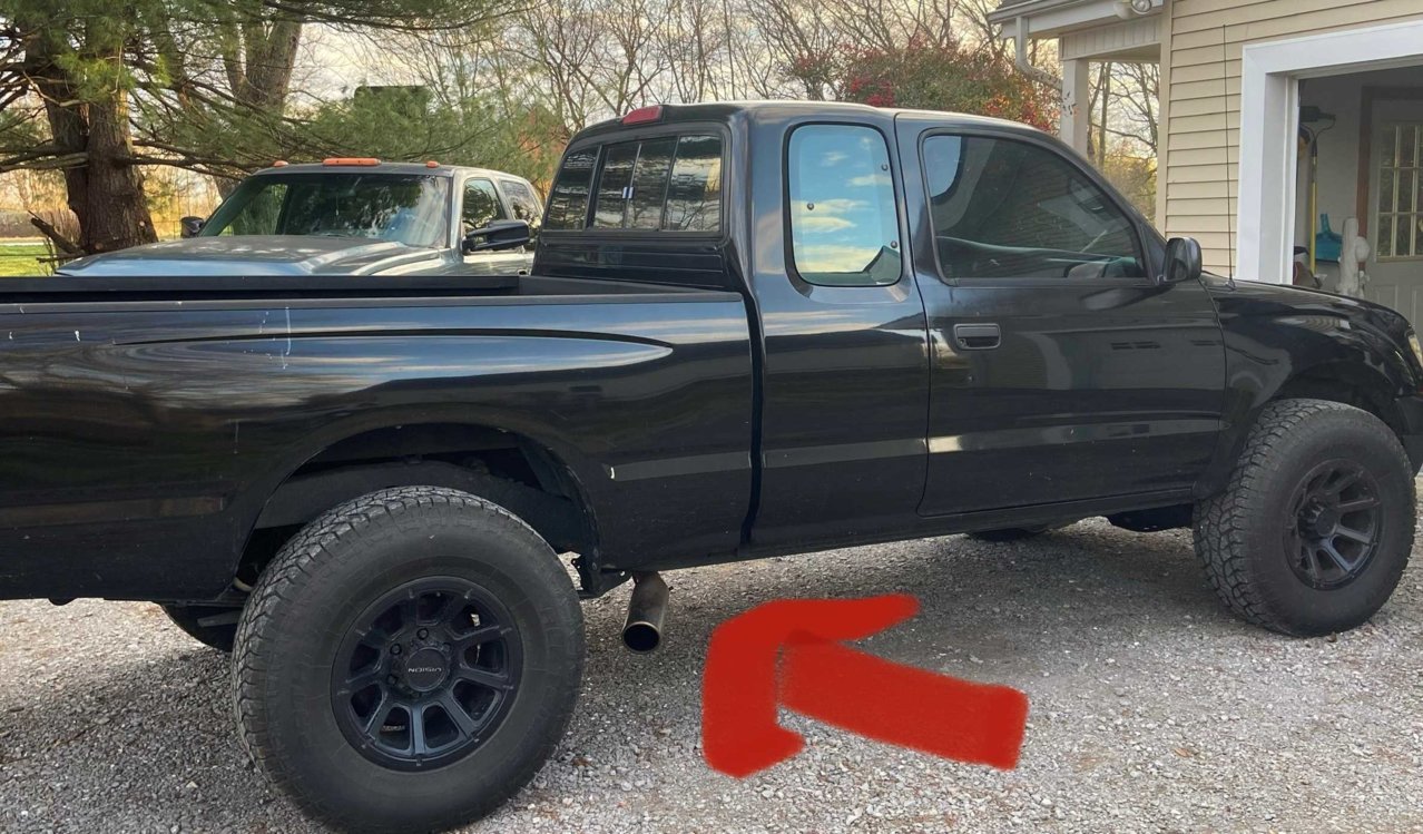

    Been a little over a week with our (new) 1996, and it's on to project # 2: the exhaust.
    The PO modified it to be a side exit.....and I assume at the same time put a glass pack on. The problem is, it's too loud - especially in the cab at cruising speed. My soon to be 16 year old son will be driving it, and even he thinks it's too loud for his liking - so that should tell you something. So I see my options as this:
    1. Re-route the exhaust to the rear and leave the glass pack or.....
    2. Re-route the exhaust to the rear and put on a muffler that is not necessarily stock, but not as aggressive.
    Few things to keep in mind: It's a 4cy 5spd. According to my son - he doesn't want it to sound like a mini van.....but he doesn't want it SO loud....and doesn't want to wake the neighbor kids next door when he comes in at 10pm.
    My hunch is to 1st re-route it away from the cab to the rear, then see what kind of a difference that makes to the cab noise level. Then, if it's still too loud.....cut out the glass pack and put on something else - maybe not factory, but something that would sound okay on a 4cy. (I'm not sure what).
    Photo below of the side discharge that we'll be getting rid of.....and I'll try to get a video tonight and post so you can hear it. Any suggestions or experience with this mod? Or rather backwards modification?
    Thanks in advance! I'm loving this truck, and going to be a little sad when he turns 16 and it's always gone :)

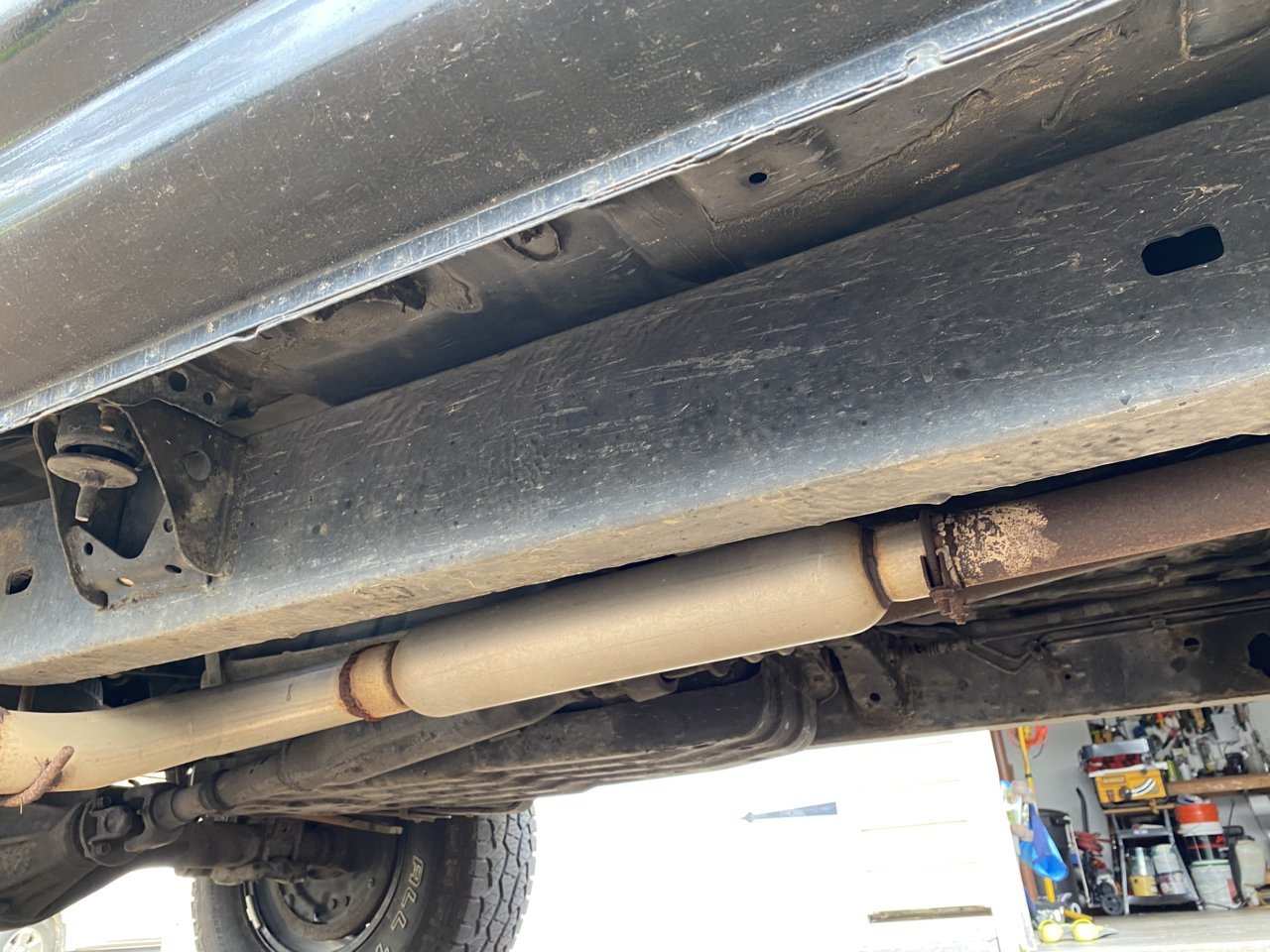

    So maybe it's more of a hack job then I thought.....I do see at least one clamp. Pictures and videos to help tell the tale....although the video really doesn't sound anything like what you hear - the engine noise heard in the video is almost non-existent in reality.....especially that close to the exhaust. Anyhow, thanks for any suggestions!
    https://www.youtube.com/watch?v=kDrh3ZwRT84

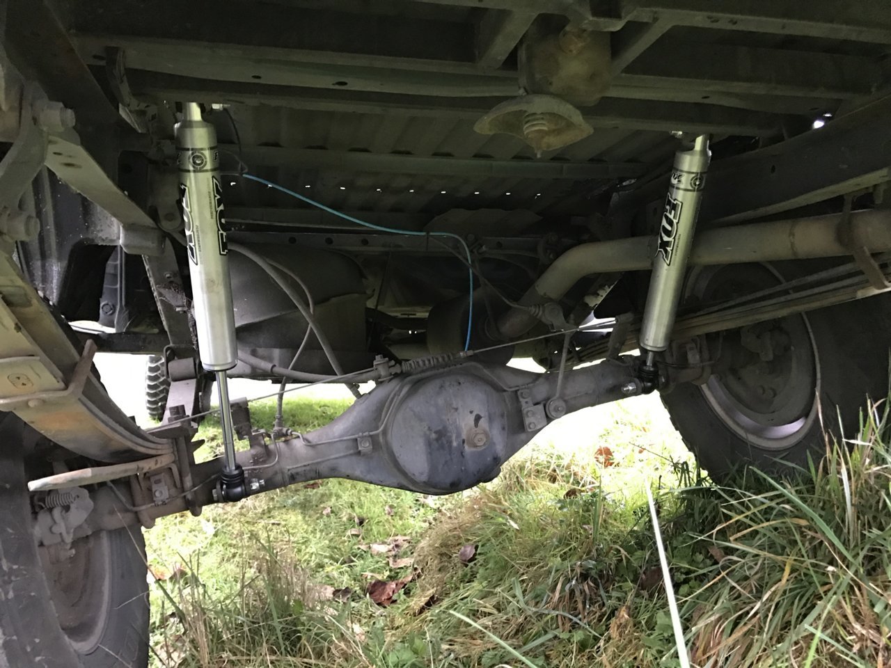

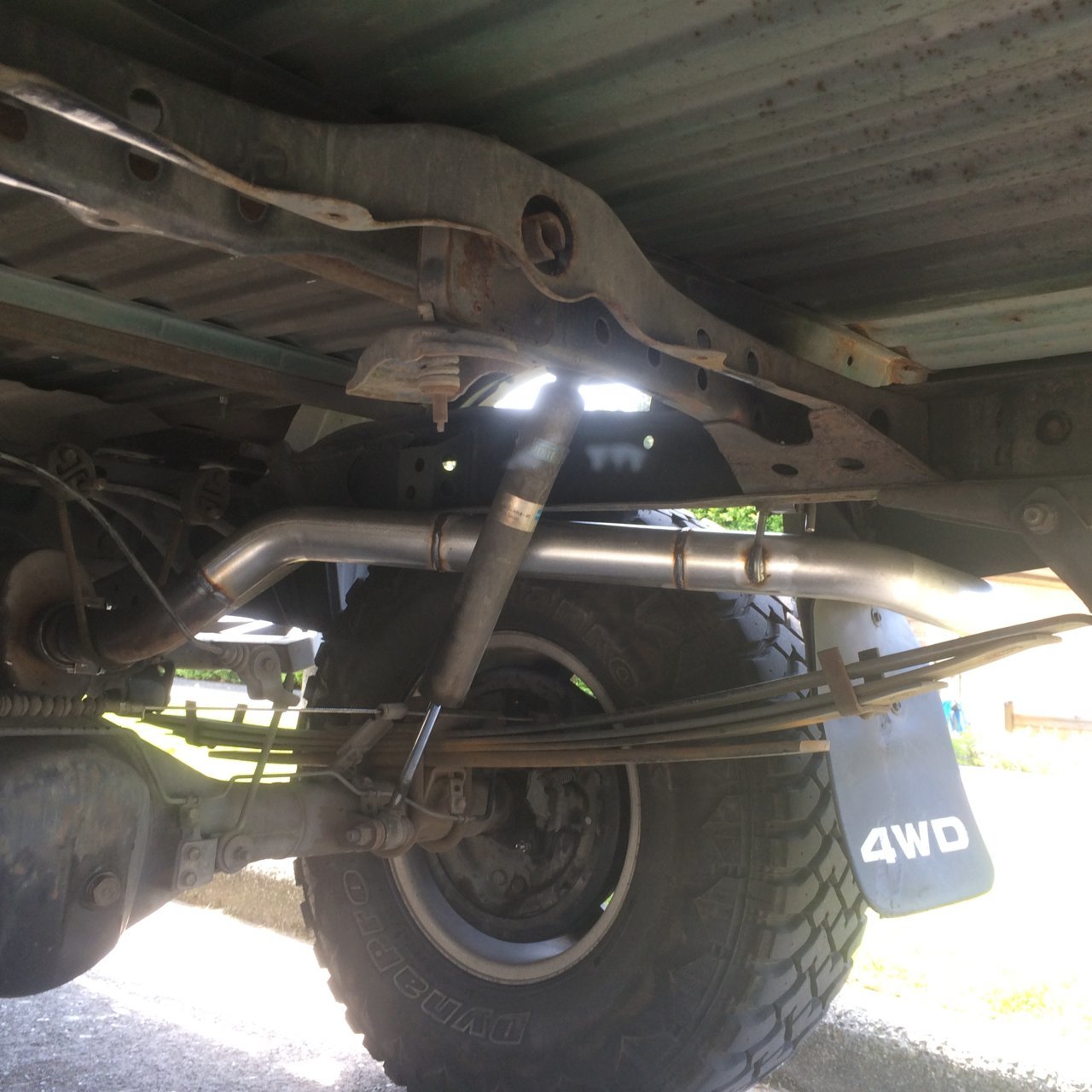

    1E4271F3-A146-4862-8DD6-95217B64229C.jpg I have a JBA catback so I got some 2-1/2” exhaust tubing and elbows and exited between the frame and leaf spring2752B893-2C68-42D6-A8F2-EBBC1047260D.jpg 7 years later still holding up fine, though welds are rusty. I sprayed the pipe with bbq paint but it’s mild steel, it’s gonna rust.

    Not even close to the same, and it’s obvious. If you don’t wheel your rig then it’s not a concern, go back to stock, and honestly for the work involved and to get the exhaust notes you want ccoyle71 you should just get a catback and save the headache, stock install, just removing/reinstalling hardware.
    Routing it over the leaf spring saves clearance of over 3” the stock exhaust adds, not to mention the leaf spring now protects the tailpipe and you don’t have to worry about the leaf spring hitting the tailpipe when you droop the passenger side suspension, which absolutely happens on lifted trucks.
    Some say you can just add a drop bracket to the rear tailpipe hanger, but this just further decreases clearance, and the stock is already in a bad enough spot, it doesn’t take much to back up with the rear passenger tire toward a rock or stump or drop off an ledge and crush it.
    I don’t have to state why crushing or kinking the tailpipe as in my case is a bad thing.

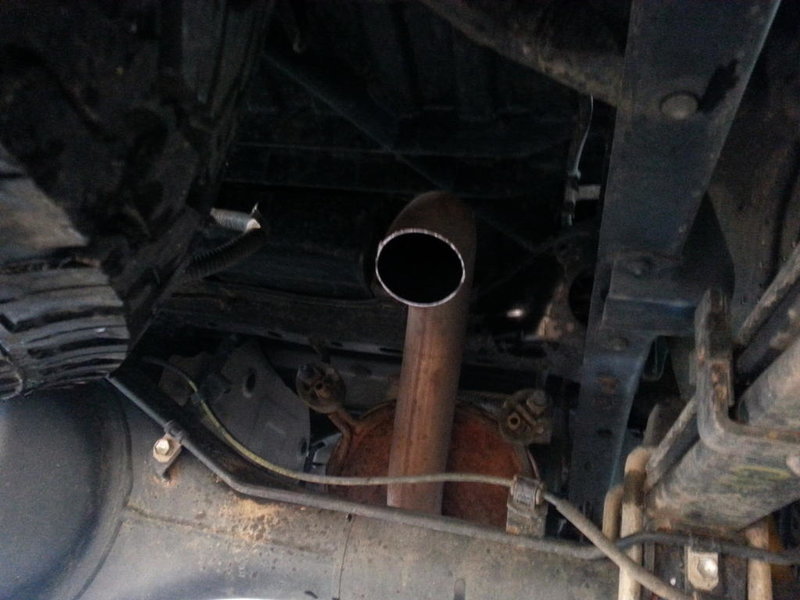

    I crushed my tailpipe when it hung below the frame so I went with the logic of the day to just cut the tailpipe back under the bed which is not good advice.A057D9C0-E122-4ACC-A5BE-9FC1E639286C.jpgAs a result it had several negatives
    1. It trapped heat under the bed which would actually melt plastic in the bed stored in the rear passenger corner.
    2. It trapped exhaust gasses under the vehicle so they wouldn’t dissipate and you could actually smell them in the driver seat while sitting in traffic
    3. The heat ended up rotting/cooking my spare tire
    4. The moisture/heat from the exhaust gasses caused the passenger side of the frame to rust, obvious by comparison to the driver side
    I’m not suggesting cut the tailpipe under the bed or that anyone else did, more commenting to enforce the logic that running the exhaust the way I did is sound and solves a lot of problems the stock exhaust location presents.

    That’s not my photo, I just found one as an example.
    Mine was cut back even closer to the muffler because of how the tailpipe got crushed.
    At any rate, for about $50 in tubing, the way it’s run now has zero issues.

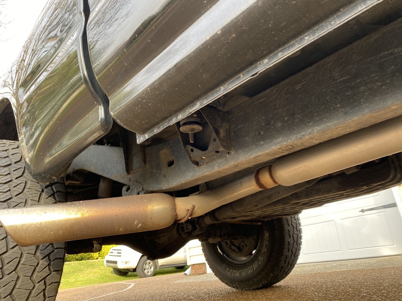

    I'd go quieter muffler and stay side exit. Much easier (and cheaper)
    Can post pics of mine if wanted.
