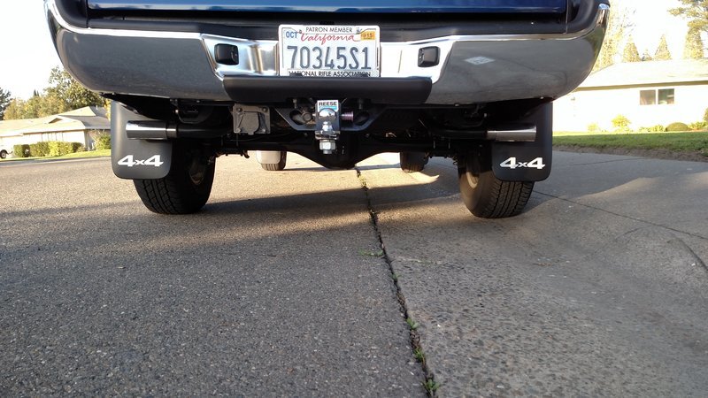

    I had the flow master done. Then had dual exhaust. 1 tailpipe out each side. With stainless tips put on. Sounds nice. The flow master was single pipe in and dual pipes out. But if u are going to do duals u will need to add 2 inches to the brake lines on the left side of truck as there is a bracket where the 2 steel lines come to and they switch to flexable line. I got braided lines 2 inch longer then stock and it clears the pipe with no issue.

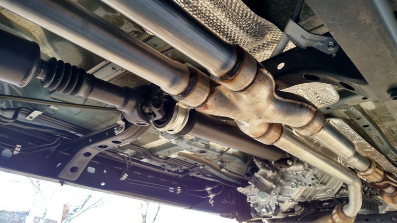

    Cut the exhaust at the cat's. And had stainless steel pipes ran all the way back. Magnaflow Mufflers

    Applause for the fact that it looks really good, and has flex couplings.
    My only question is, are there no other flanges than those at the outlet of the cats?
