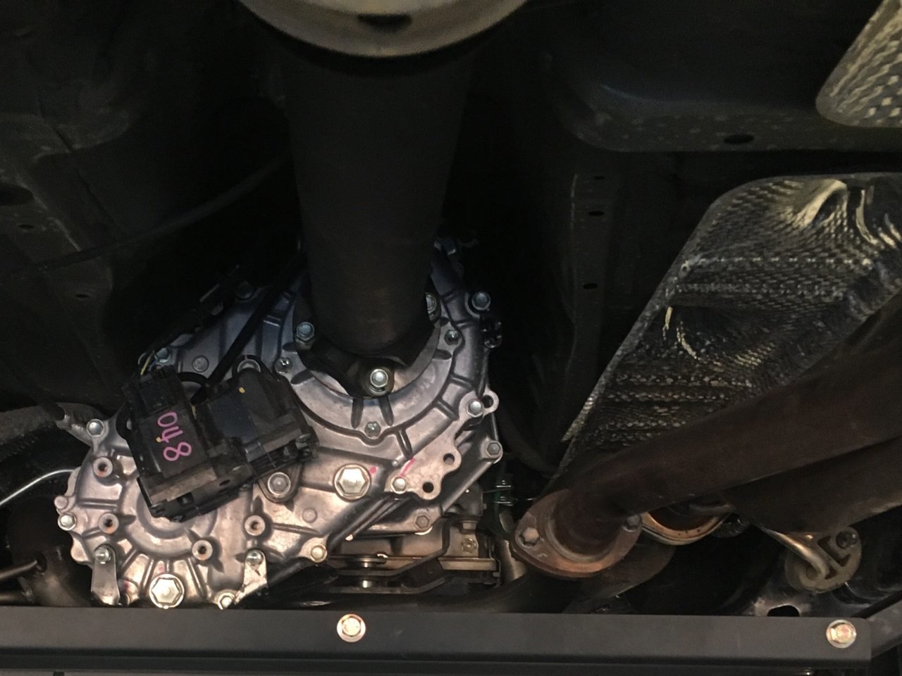

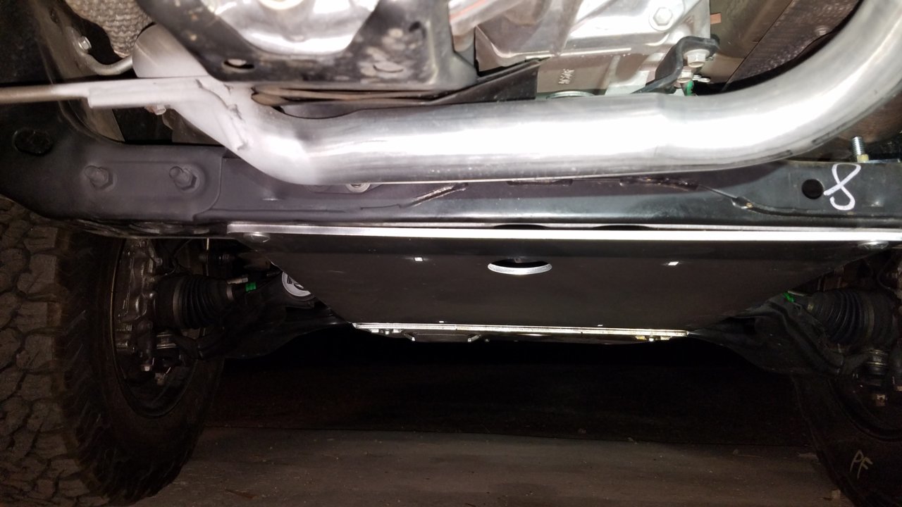

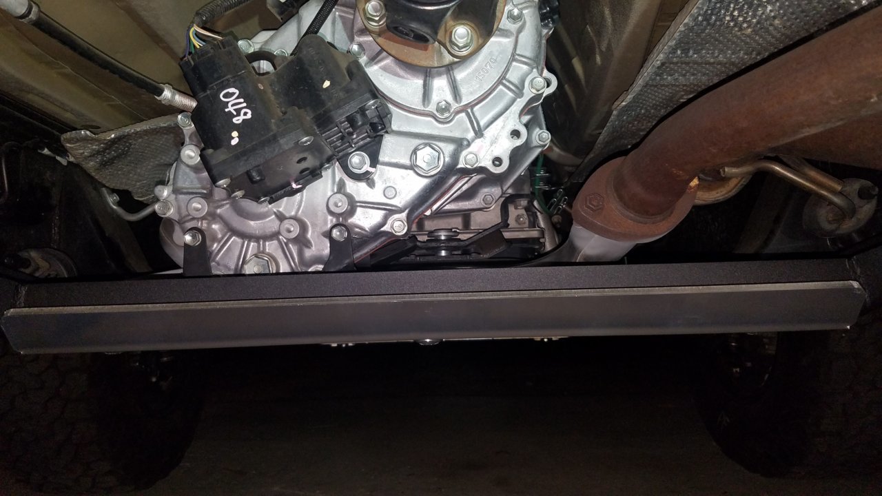

    Got my exhaust rerouted yesterday to accommodate the Mobtown skids we installed. My buddy rerouted it differently than most exhaust shops. A little more labor, but much cleaner and not in the way of the transfer case.

    Looks great! What is the pipe coated with?

    many are. you just need an exhaust man looking at everything under there, not just the exhaust pipes.

    The duller, grayer pipe looks like stainless to me -- when new, aluminized steel is a lot more reflective and silvery.

    It's about being a craftsman not just a "muffler dude". This is the way we should all perform our occupation, the best we can. When I work at his house I hold the same standard for quality in my services.
    There's already a factory heat shield mounted on the bottom of the transfer case. We have no concern.
    I'm not sure what he coated it with, after he had it roughed in, he removed the small catalytic conv. And welded everything up on the bench. Than painted it and reinstalled, then welded the bracket and touch up paint.
    He did an even nicer job welding up my Caliraised sliders.
    It's a blessing having good friends.
