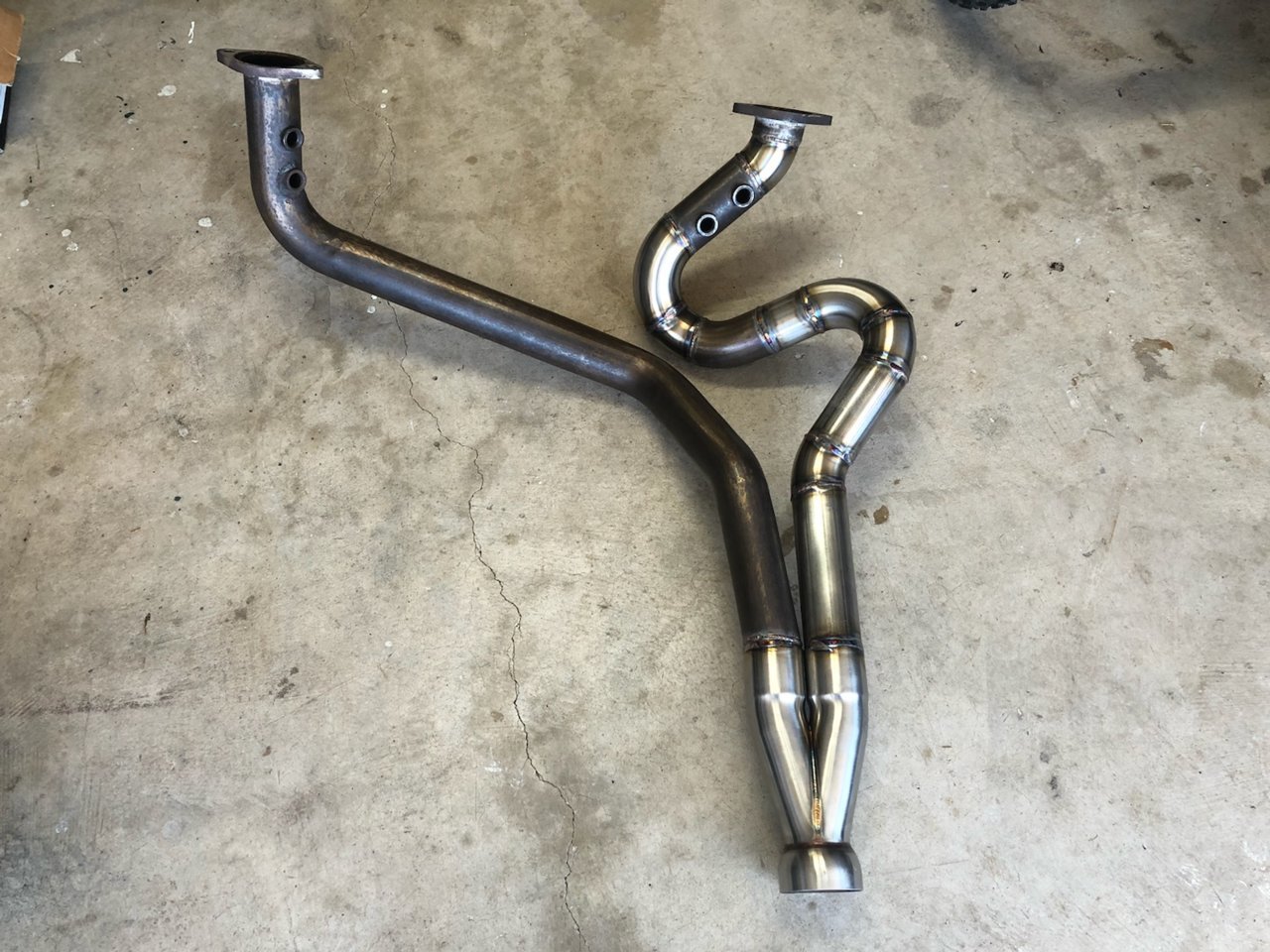

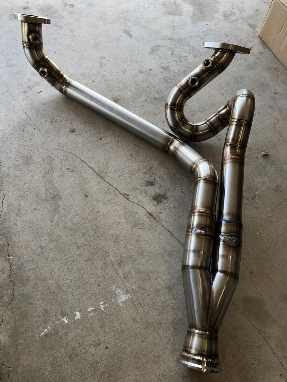

    So I started with this
    and ended up with this.
    This was the finished product and the only one I ever planned on making. It doesn't look the prettiest but the tubing diameter, length, and a true merge collector proved very effective both in performance and sound!

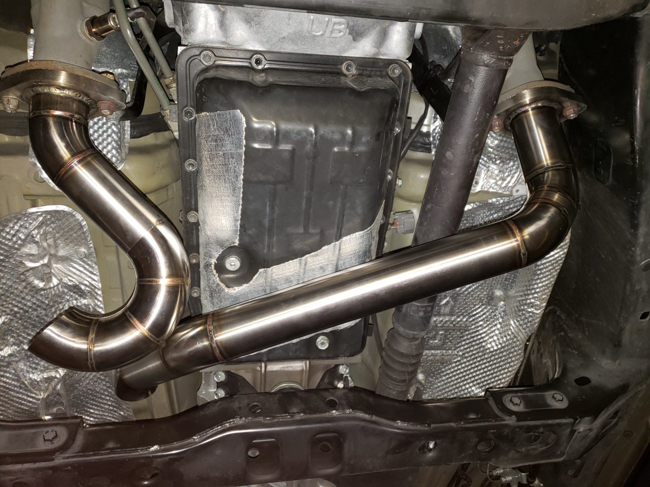

    I had been in PM contact with @loginfailed for awhile troubleshooting the 2012+ UCON teething issues and one day he asked me what I thought of him installing a factory type 3" muffler in place of his Magnaflow 12579 which comes on probably all of URD's exhausts. I told him the problem was in the y-pipe, NOT to install that restrictive muffler. A month or so later he came to my house for the weekend and we fabricated a more refined design very similar to what I make now, while utilizing all of the parts we could off of his other "performance y-pipe".
    Here is what we came up with:
    He liked the result both in performance and sound! After a few posts of our weekend fabricating a few others inquired about me building one for them. At that point I started a PM and had a few people to make y-pipes for. Here is the first post from that first conversation and my policy and prices:

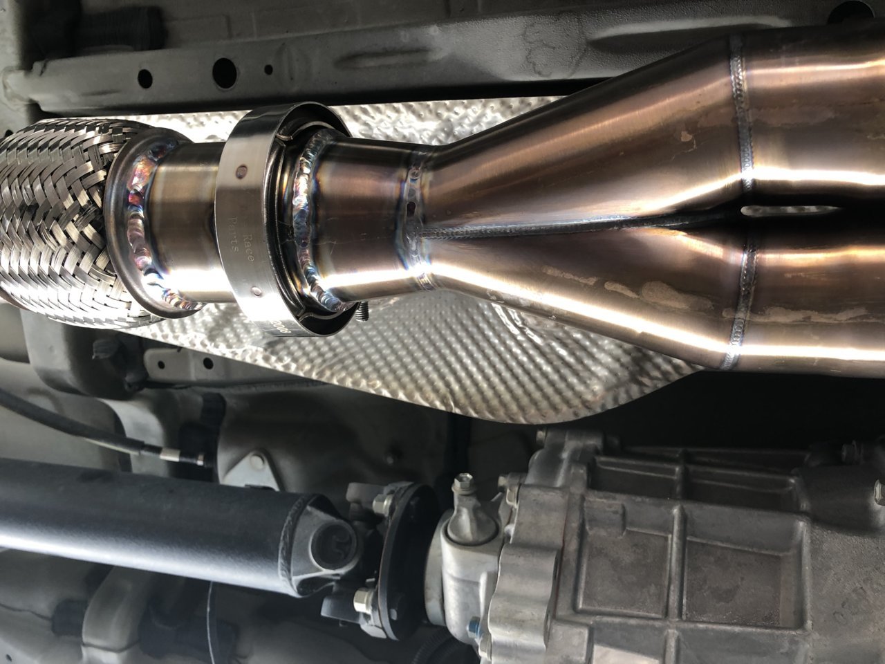

    5. I recommend a heat barrier for the transmission pan. Many have run the URD y-pipe for years with no issues but I prefer blocking any radiant heat. This is what I use
    How its installed on my transmission

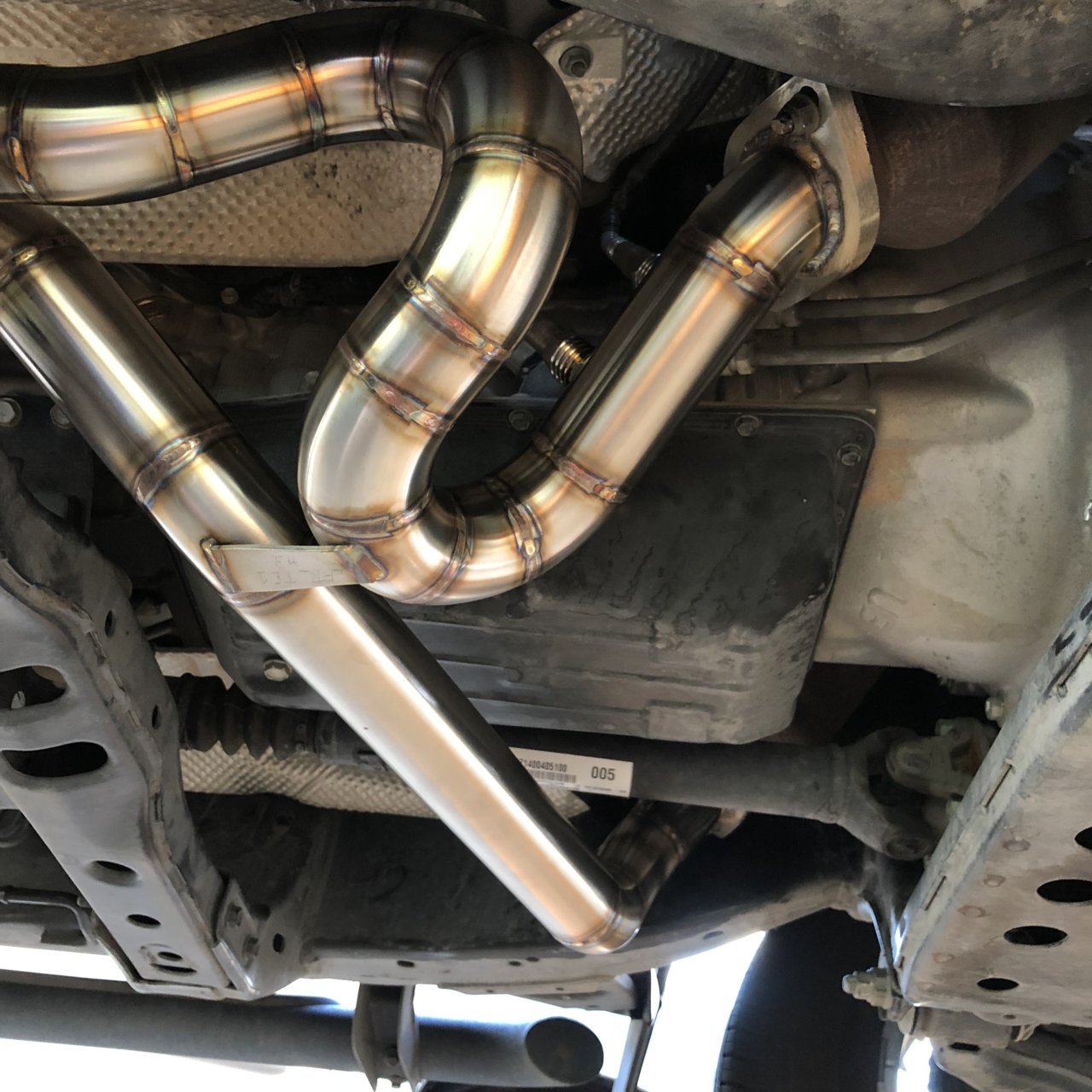

    High efficiency merge, cone, v band, and flex pipe.
    Killer finned bungs!
    Great clearance.[​IMG]
    Crazy pic, but you can see almost the whole pipe.

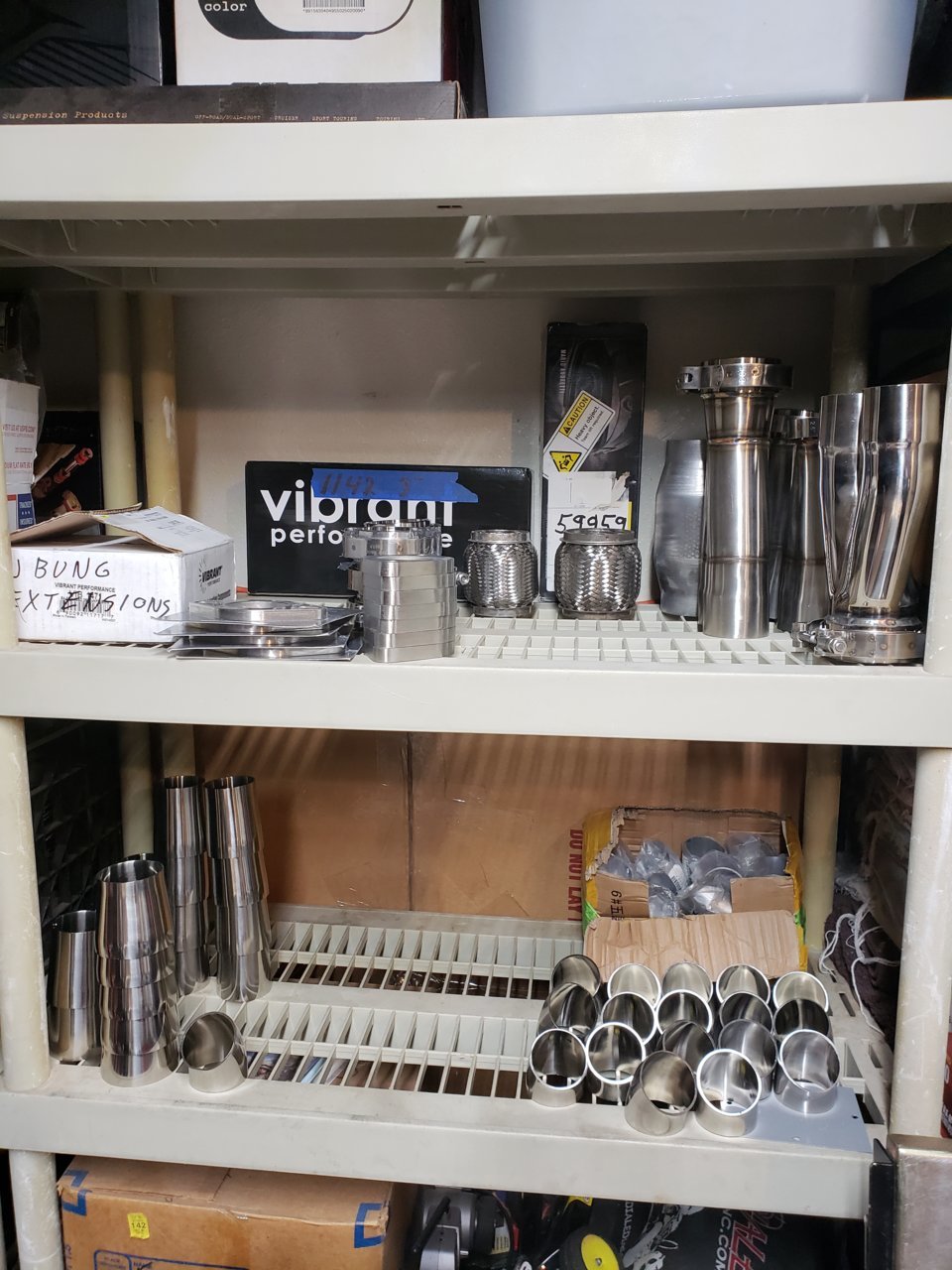

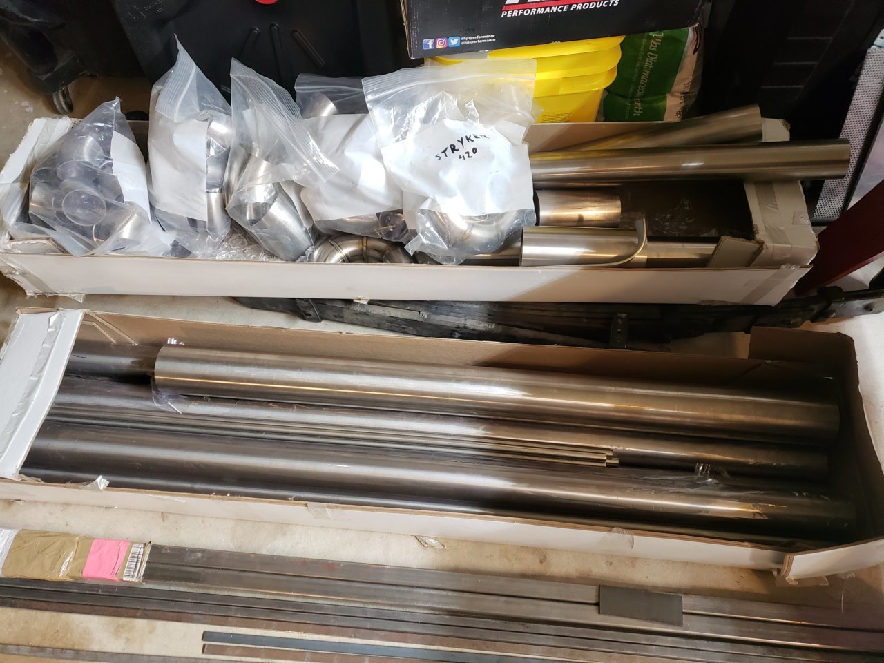

    Had to make a box to separate the J Bung orders. Also transition cones, premade merges, and other parts.
    More Mandel bends, straight tube, etc.

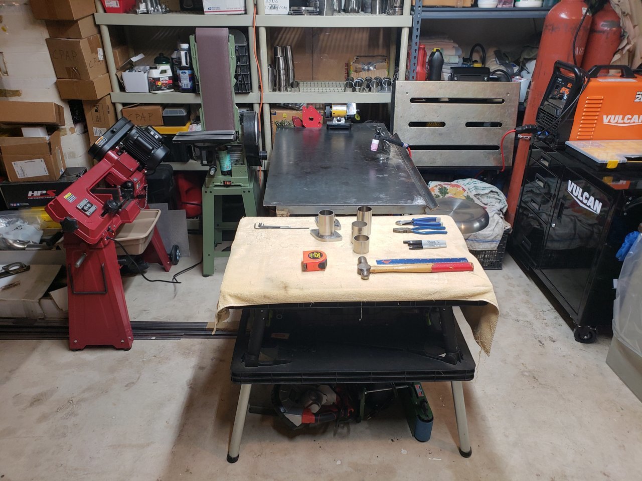

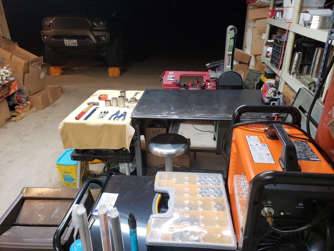

    The new setup with larger welding table and welding cart.
    I really do appreciate everyone's patience and it's time to start melting some stainless!
