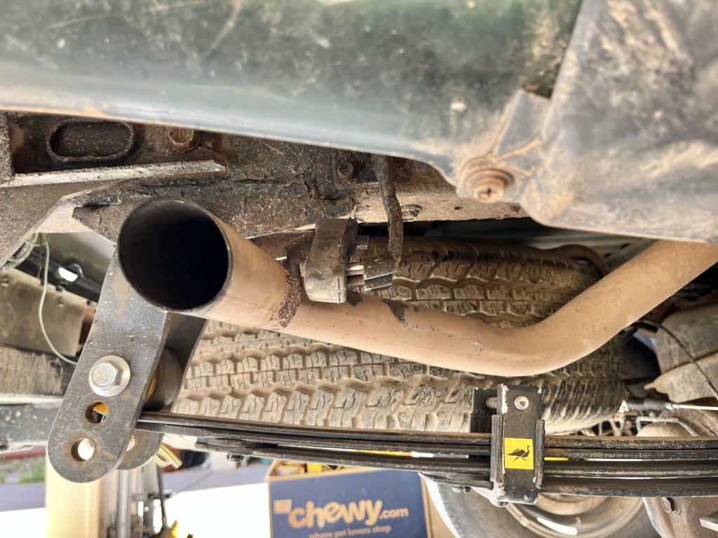

    I saw that too, and i do see why it might seem kinda dodgey, but i don't think it's one of those 'never do' things. I think you've just got to be sure the pipe's got ample space during full and violent suspension travel while also considering how much the pipe can move itself (for better or worse), and there's a good amount of space right there (my pic makes it look a bit tight, but i'll show you tomorrow). If you think about it the other way, what's more dangerous: the leaf spring ever touching the tailpipe, or the tailpipe ever touching a rock? I think the latter's way more likely, and WAY more damaging.

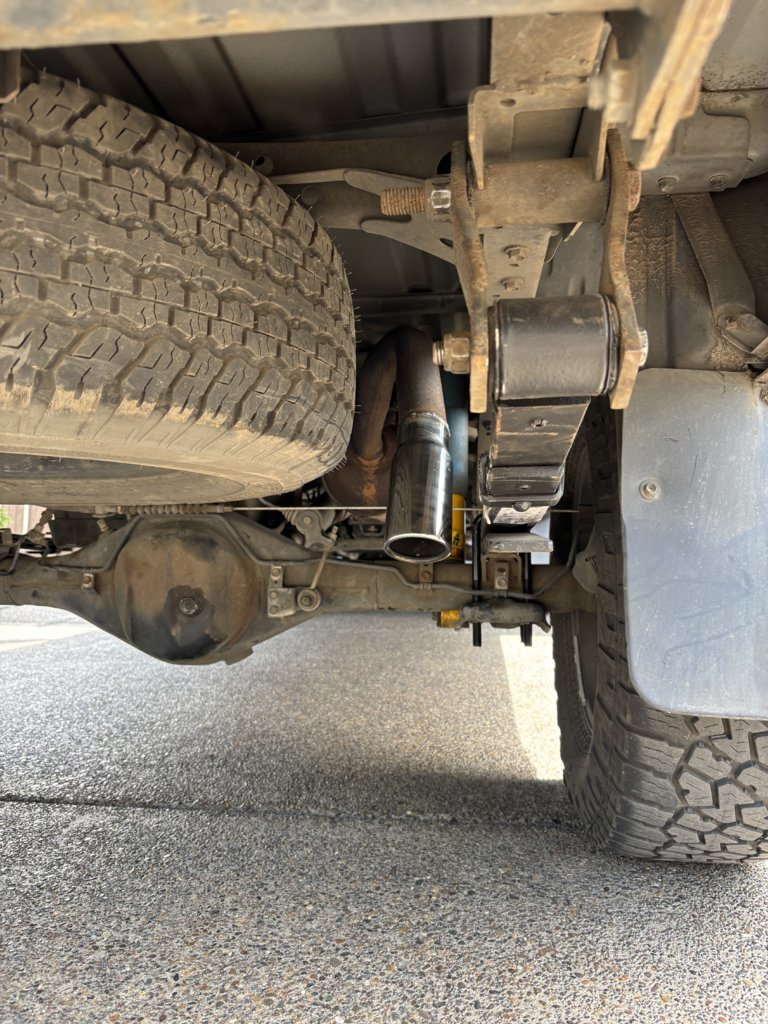

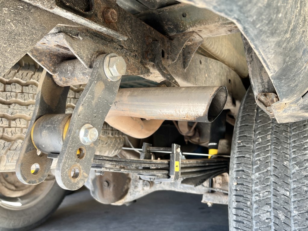

    Here's my reroute. I heated, bent, then cut the pipe hanger rod to shorten its reach, but after reassembling the leaf, i found the pipe still hung a little too close, so i flipped the hanger -- pipe rod 'standing' on the hanger instead of hanging, and it came out just right.
    I pushed chunks of high-temp hose behind the rubber to keep it from walking off the opposite rod(s). Although now, with some miles on it, it looks like it needs some adjustment -- starting to creep off the bottom a bit.
    Once it was all in place, i cut the pipe to well within the cavity. It wasn't actually touching the shell, but looked like it could, given the chance.
    (Please ignore all the other obvious work neglected! Transaxle leak!)

    Looks good man! It got done and does the job so that’s all that matters.
    I ended up just getting it cut and adding a little chrome tip. Satisfied

    You may wanna look into a LSPV relocation plate (trail gears offering), as I can see you don't have one. Also, if the previous owner overlooked that when they installed those DIY lift shackles, you should check for an extended rear brake line as well- if it's still the stock rubber ones, you need to get a longer one. And if you still have the original rubber brake likes in the front as well, just replace them as well...
