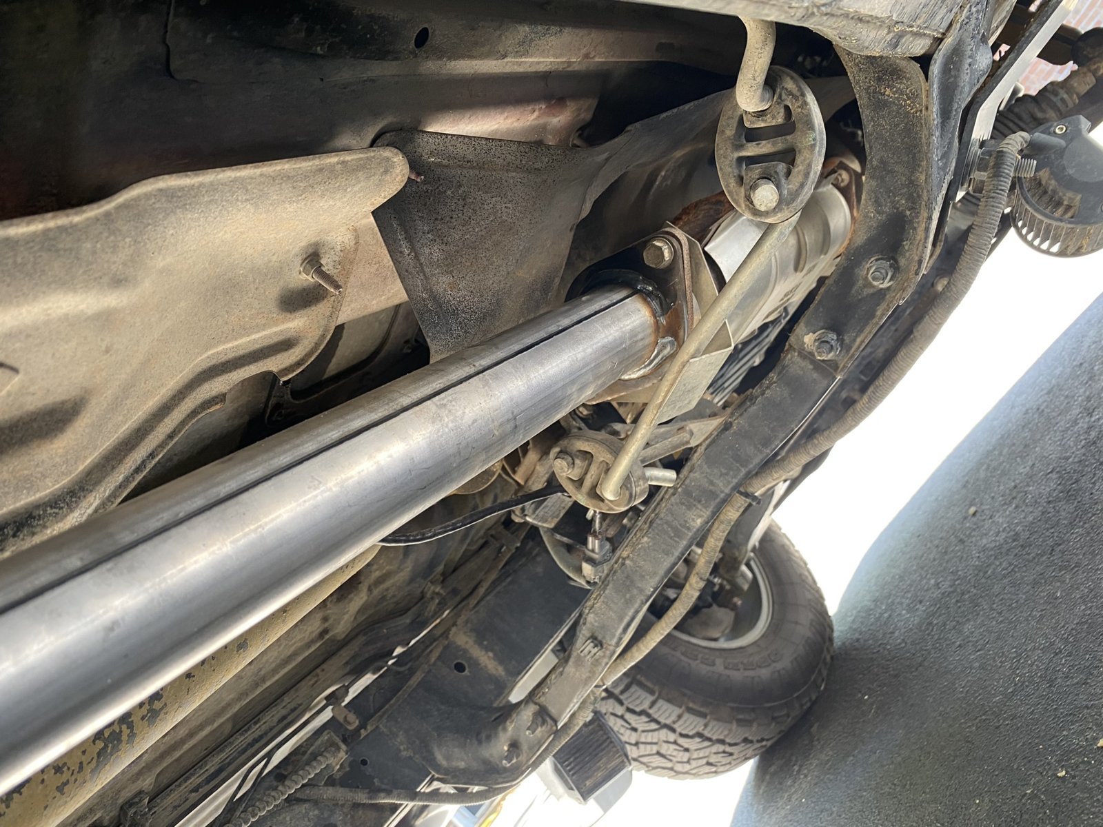

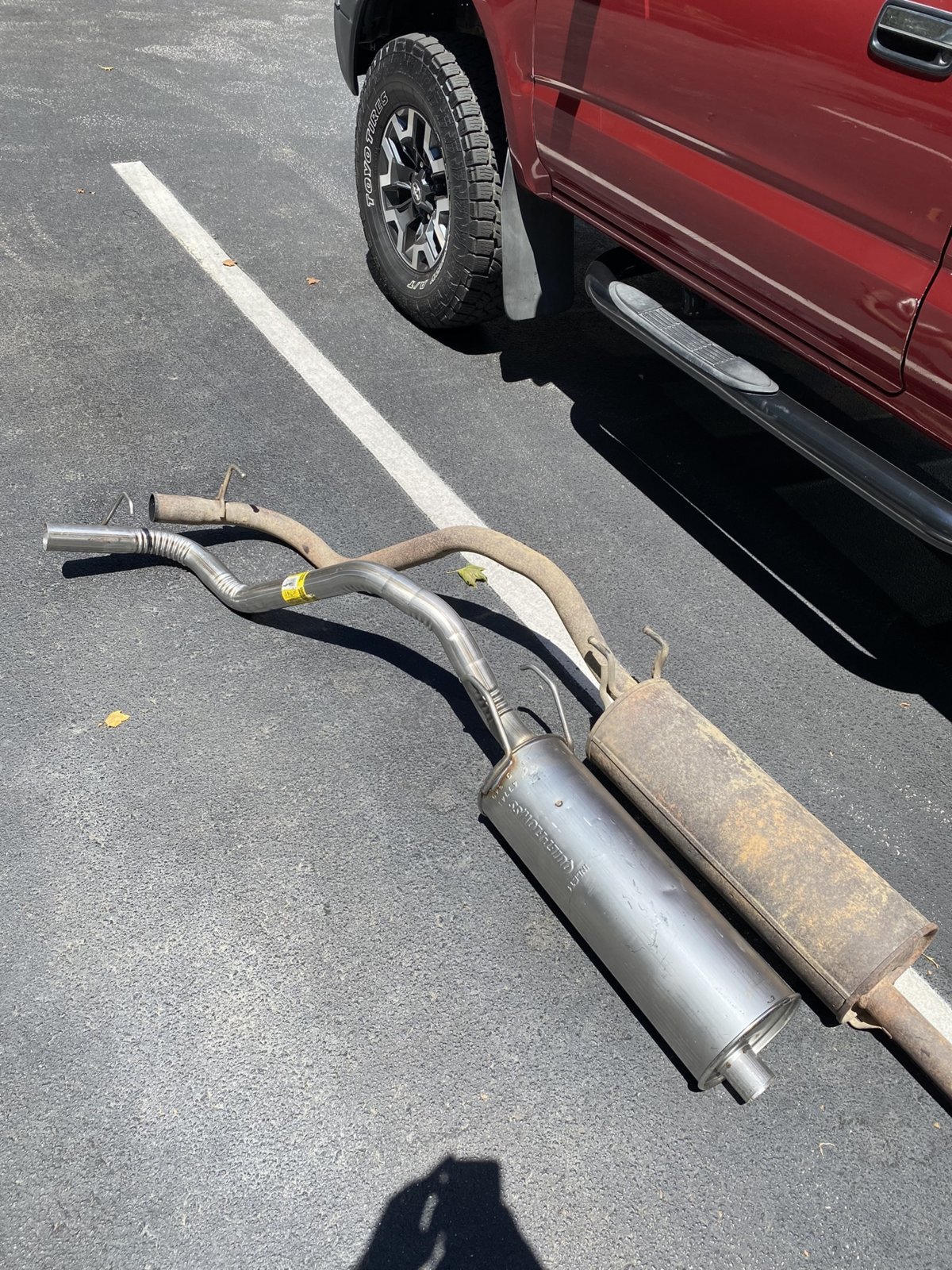

    I am about to walk outside and install the 2 piece Walker exhaust now. The muffler is the quietflow one... will report back and take some pictures.
    Got it through Rockauto, was packaged really well.

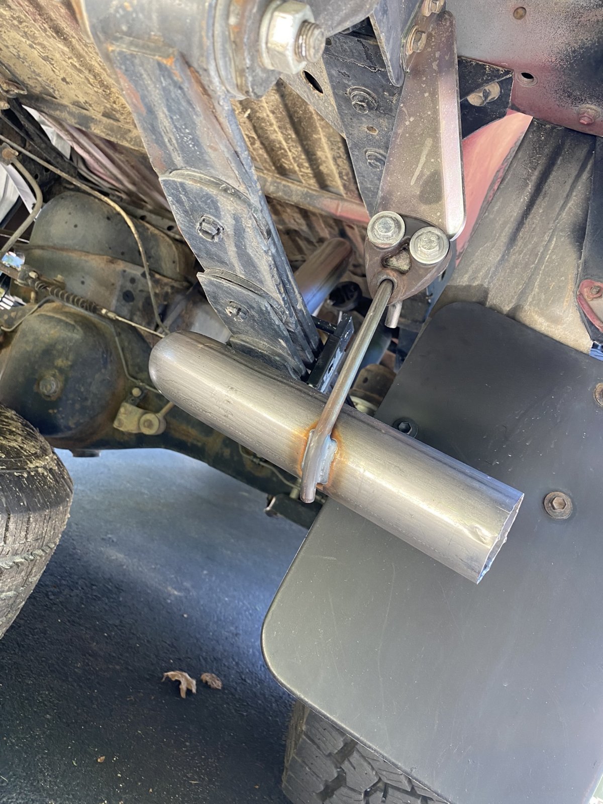

    I am content, not impressed. Fitment, like most aftermarket, is 95% with 5% of frustration. It didn't seem to mate up well to the cat (also Walker) and I have a leak at the top... if it doesn't throw a light I'm going to leave it. The clamp also did not equally clamp and seal from pipe -> muffler. It dripped water there. I re-orientated the clamp we will see. I had to bend 2 of the hanger brackets, annoying, but with a hammer not bad. The rear one just did not even come close to fitting up with the exhaust bracket drop from my lift. But it works.
    Sound is ok, around the same as OEM? Mine wasn't leaking before so hard to really tell. There was pieces of the old cat inside the muffler and had a horrible rattle which is why I replaced. I guess for $200 can't really complain much. Get some goof-off... just stickers are a pain.

    My install was pretty similar definitely had to bend the 2 hanger brackets but overall it was close enough. I also put SS worm clamps on my exhaust hanger brackets to keep the rubber hangers from backing off.

    Got the leak worked out... a band clamp worked great but took the welder to it last weekend and that solved it. Extended hangers are also an option to help it clear the cab. With that fixed, the exhaust is dead silent.

    Not required, the band clamp was enough to seal it but welds seal better :)
