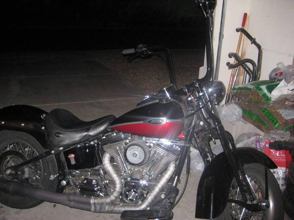

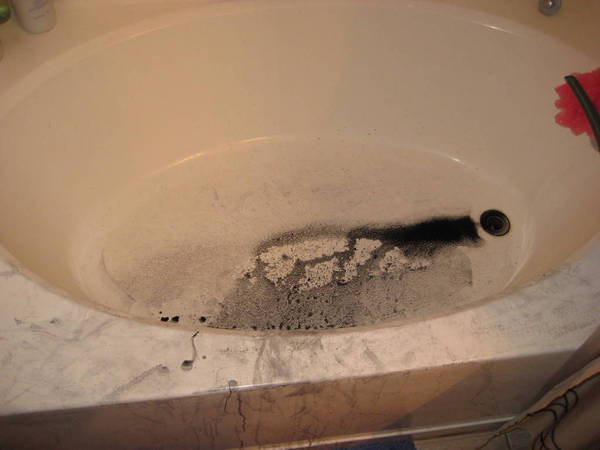

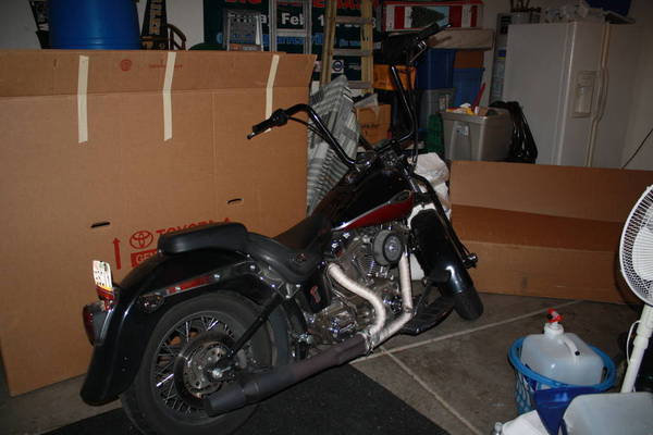

    I have done my bike and many others. I worked at a harley dealership for years. Don't powdercoat them. wrapping them takes time but looks great.
    I took off my exhaust, after cooling of course, brought them into my bathroom and did them in there. It's much easier off of the bike. You'll need to wet the wraps, do not soak them, just wet. I hung mine in the shower. I cut the wrap into two equal lengths and let hang. I did one pipe at a time. start at the exhaust port and metal clamp it on there after a few wraps. then continue on. The wetness will allow you to wrap it vert tight. Clamp the other end when your done and let dry over night. Install next day and start bike. do it outside of the garage beacause i do belive that the initial "smoke" is quite bad for you. not to mention it fuckn stinks. when its done smoking, your done.

    If you get the black ones, prepare for a mess!

    Is one pic before painting and the other afterwards? Top one looks more silver.

    ^ no, they came black like the one in the bathroom. over time the black fades in the sun and heat. the newest picture, whitest, was three years after putting them on

    Oh! Still looks good - the bike does, too!
