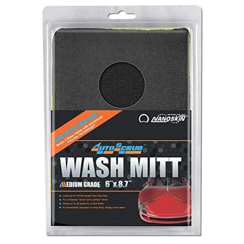

    Col4bin
    Col4bin [OP] Well-Known Member
    Apr 6, 2018
    #249606
    1,037
    Maine
    2018 TRD OR Double Cab
    this bad boy?

    rfranklin1
    rfranklin1 Well-Known Member
    Sep 17, 2020
    #341115
    66
    2021 Tacoma TRD Pro
    Negative - that's their clay mitt. The AutoScrub Sponge is the same one CTSpruceMica linked in post #6. You can get it from Amazon for $13. If you're buying elsewhere, be sure to get the blue (fine grade) sponge. Other ones are going to be more aggressive and would probably leave some more noticeable marring in the paint.
