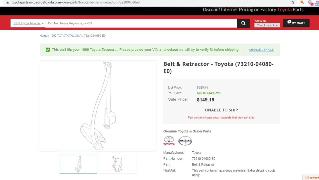

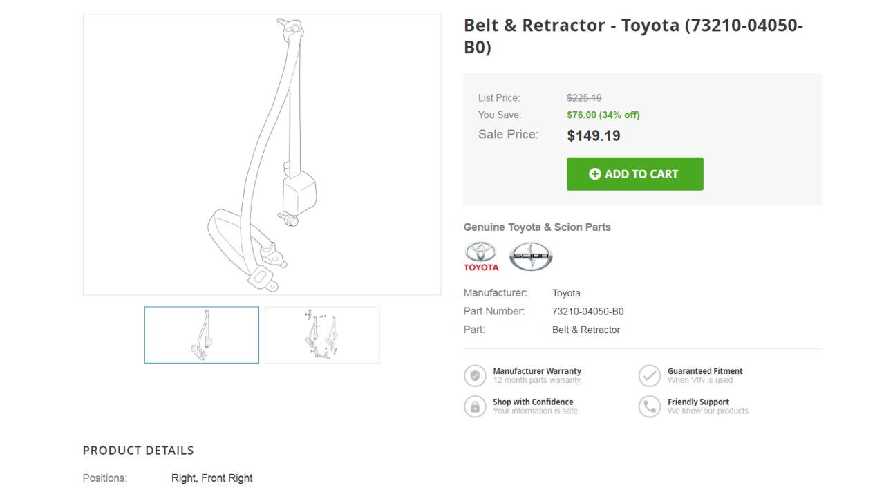

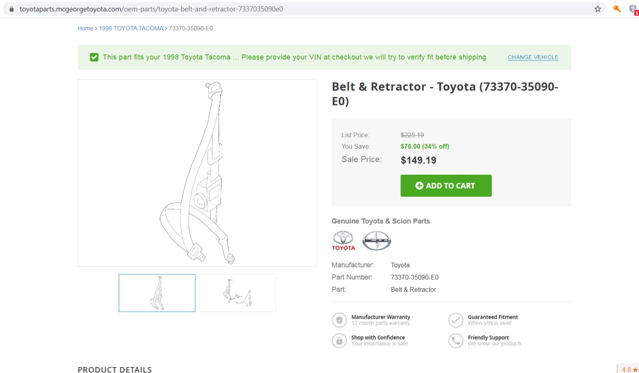

    When I saw the post, I remembered Nissan/Infiniti did not introduce the explosive retractor until 1999. The same goes for Toyota Tacoma in 1999.
    Here's a picture of a 1998 model belt and retractor from McGeorge Online Parts. NO EXPLOSIVE CHARGE IN 1998.
    Here's a picture of a 1999 model Tacoma retractor. Different part numbers. Notice the UNABLE TO SHIP designation.

    Yep. The explosive tensioner did not show up until late 99. (8 does not have them. I know for a fact since that is the year of my truck belts as well.

    This first belt you posted is for the rear seat!
    CS_AR[QUOTED] likes this.
