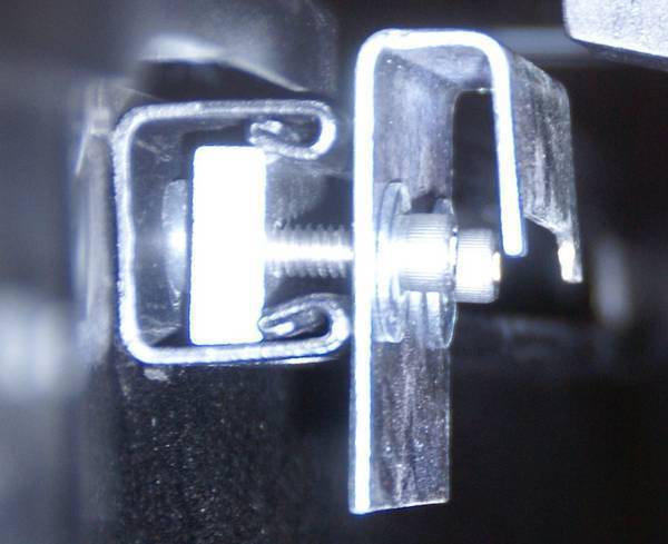

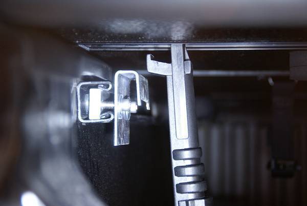

    Here is a picture of what the instructions suggest you should do. Installation of a bracket into the factory bed rails and then attach the spring loaded clamp to the bracket.
    I didn't like this setup for two reasons.
    1. The block that slides into the bed rail isn't tall enough. It needs to be a few millimetres taller because if you tighten it down enough, you can see the bed rail opening up and the block starting to pop out.
    2. I didn't like the thin, sharp edge that the clamp attached to. I worried that with the opening and closing it would eventually wear on the plastic and it could split or snap off.

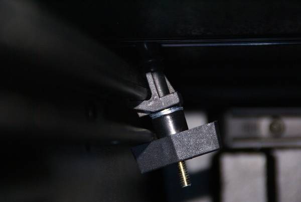

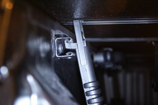

    I don't know why the instructions don't just say to attach the clamp into the bed rail all alone. It has a nice rounded edge to protect the plastic and there's no extra crap to deal with.
    And the fixed clamp at the back, same deal, the instructions said to put in the bracket. I did need the bracket because the wing nut was too close to the bed and it eventually hit the rail and you couldn't snug it up. To fix this I just stole the washers that came with the brackets and put them in as a spacer to push the wing nut down a tiny bit to allow me to snug up the clamp.

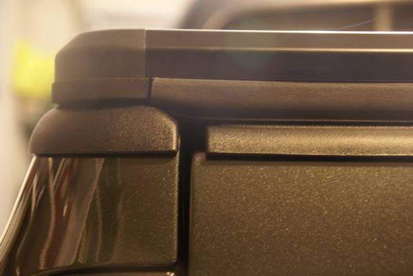

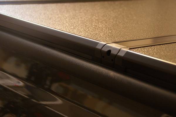

    The side rails on the cover fit nice and snug and no water leaks in on the sides.
    The back and front however, have small gaps at the side where water could leak in. The only water I have had get in so far was when I washed it and sprayed right on the corner. Normal driving in the rain has proven to keep the bed nice and dry. I will wait until the rain season here on the wet coast to see how it truly holds up.

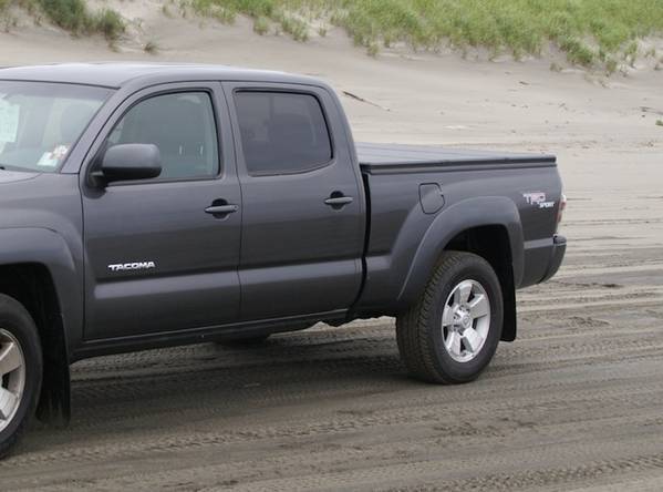

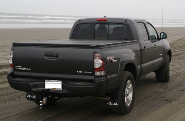

    Could you post some photos of the entire rear of your truck? I would like to see the entire cover and how it fits.

    It basically sits right on top of the bed caps and has foam seals on the sides and a hollow rubber seals on the front and back. I believe Extang sells a tailgate sealer pack which is just more foam or rubber seals that you put around the tailgate where it closes to help keep some more water out.
    Hopefully these pics are what you are looking for. I can take some more if you need, but these were just some I already had.

    Have a look at the 3rd picture I posted in the first post.
    It is very close to the end of the rail and I had to remove the small cap. It does stick out on a bit of an angle too.

    Just wanted to say thanks for the post. I got my Tonneau yesterday and tried with the brackets they provided to no avail. the freakin wing nut wouldn't turn because it was too close to the bracket. I ended up installing exactly like you did and honestly i think that is how they should all be done!

    My friend has this cover and to solve the bracket issue we turned the aluminum block sideways and trimmed it down to fit really snugly in the factory rail. I would just do exactly what you did and throw the damn brackets in the trash. Thanks for the tip; if I buy one I'm doing just what you did!
