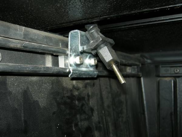

    i just received my trifecta from autoanything and it came with a bunch of hardware parts but nothing in instructions about how to use them. I think they are the brackets so i dont have to keep checking correct fit when re-installing on the bed. Any pics of how the brackets are attached to bed rails?

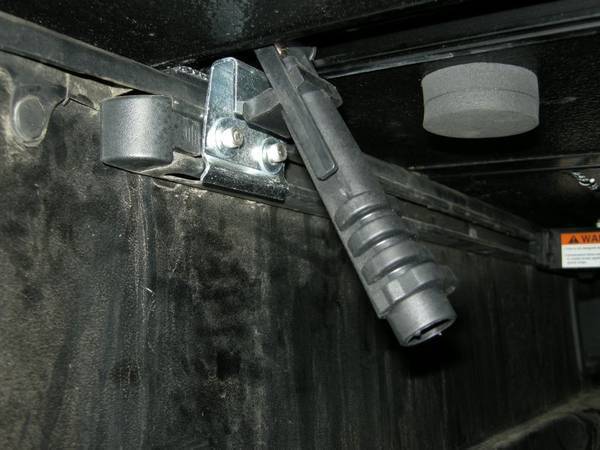

    I used the hardware for the front two connections because the turn buckle handle would have interferred with the lower edge of the track when the catch engaged the inside of the track. So, my front two look exactly as above.
    I had no problem with the rear spring loaded catches, so did not install the hardware for the two catches near the tailgate. Takes about two practices while bending over to see, now I just reach under and snap them in place.

    On the front I took off the thumb nut and put a spacer about 1/4 to 1/2 inch between the thumb nut and latch.That way the thumb nut does not hit the Rail system when you are trying to tighten it.Hooks just fine without the hardware.On the back I think I just tightened it in a little more.Worked for me anyway.

    so the top of the bracket should sit over the side of the bed correct. sit higher than the bed.
