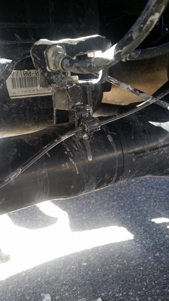

    Edit: my rear shocks came with a brake line block bracket spacer thingy but im not even positive it was needed but since i had it
