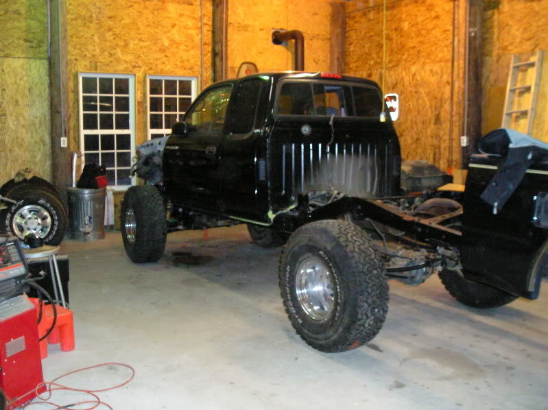

    Being a cheap bastage I'm sorcing stock OE application extended lines to function from now until SAS...
    Toyota 6" Drop Bracket lift front extended brake lines = 1991 - 1998 Geo Tracker (Left front)
    Geo Tracker / Suzuki Sidekick left front brake line specs from NAPA:
    Brake Hose - Left Front Product Line: Brake and Clutch Hoses and Cables
    Part Number: UP 38617
    Price $27.39 Each
    Attributes Brake Hose End Type : Banjo & Female - M10 x 1
    Brake Hose Length : 29.5"
    Caution Statement : Do Not Use w/ Petroleum-Based Fluids - Designed Only For Use w/ DOT Approved Silicone Or Glycol-Based Brake Fluids

    Rock Auto Wholesale Closeout
    1996 SUZUKI SIDEKICK SPORT 1.8L 1840cc L4 MFI DOHC
    BENDIX Left Front Brake hose 77892Hydraulic Hose
    $13.12 each
    Now I can pitch the stock gituar string brake lines...
