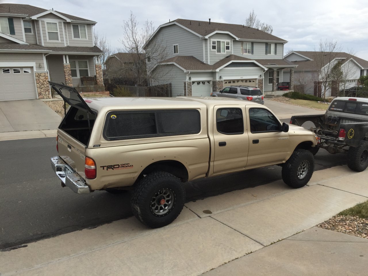

    Anyone swap the extended cab for a double cab and bed?
    Is it just the rear cab and front bed mounts that need to be changed?
    I bought a complete Dcab, will pick it up next week so I don't have both trucks in front of me to compare.

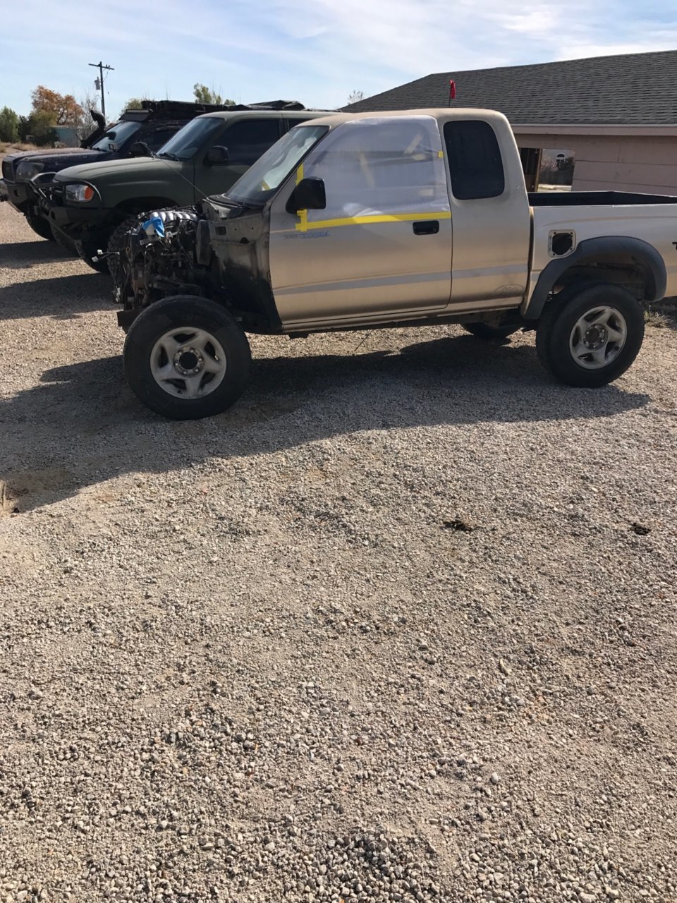

    Dcab is wrecked, and It would be just as much work to swap SC, injectors, Sliders, F&R shocks, beef the motor mounts, AEM FIC, F&R axles, swap 5 speed in.
    I haven't seen the truck in person yet but the whole front end needs to be replaced anyway, and most likely the front frame is trashed too.

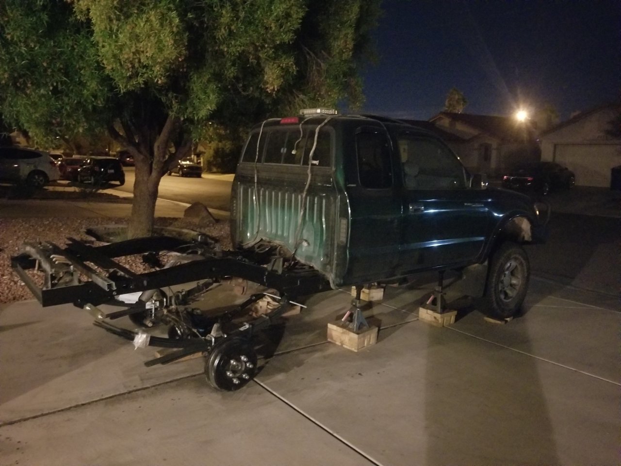

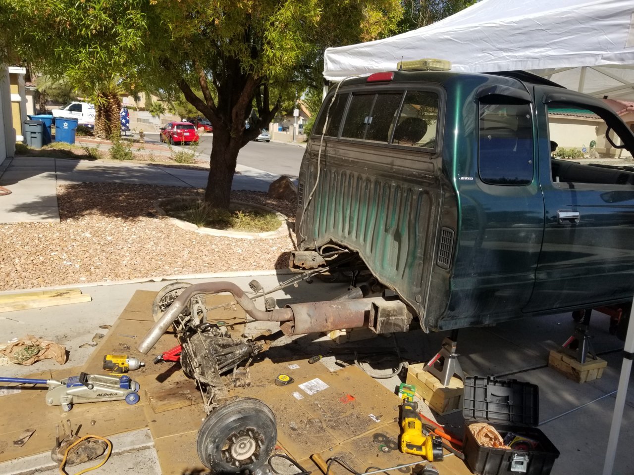

    The gas tank and filler neck is different but you will have that with the new one.
    The front bed mounts and rear cab mounts will be different but you can order them from Toyota. It will be easier to weld the new ones on. It was a real ^%&%&^%& to grind the old ones off and I could not imagine reusing them.
    The reason I know this. I cut the rusted reared of my 99 extended cab off and welded on one from a 2003(?) Double Cab. Excluding the support for the filler neck, front bed mounts and rear cab mounts they where identical. Even the cross members where perfect. I had already used safe-t-caps from that point all the way to the front and made custom pieces from that point to the very front.
    I cut out my old frame sides and used them to box the new frame and they fit perfectly.
    I tried to order new bed frame mounts from my local dealer but they said it was not possible. I got online and found the part number then the part and had them shipped here in a few days. I wish I had taken more pictures.20181104_221053.jpg
