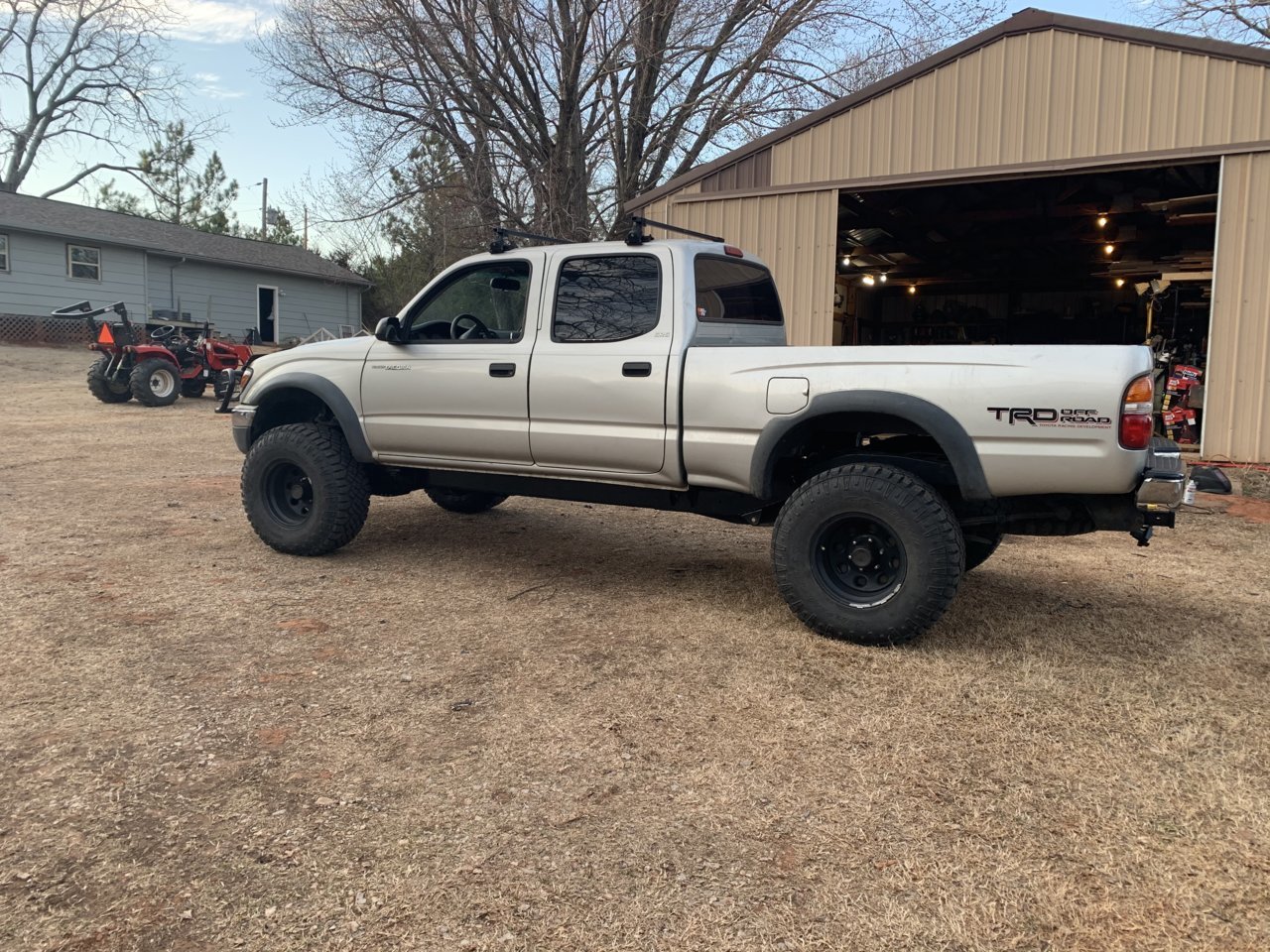

    FCC134D9-011C-4CAB-B292-7B93D49CCF2A.jpg Love the input here guys. I just joined the double cab long bed enthusiast family. Built this one as a daily, mall crawler, hunting/fishing, mild trail kind of rig.
    chrslefty, COMAtized99 and mattyosh like this.
