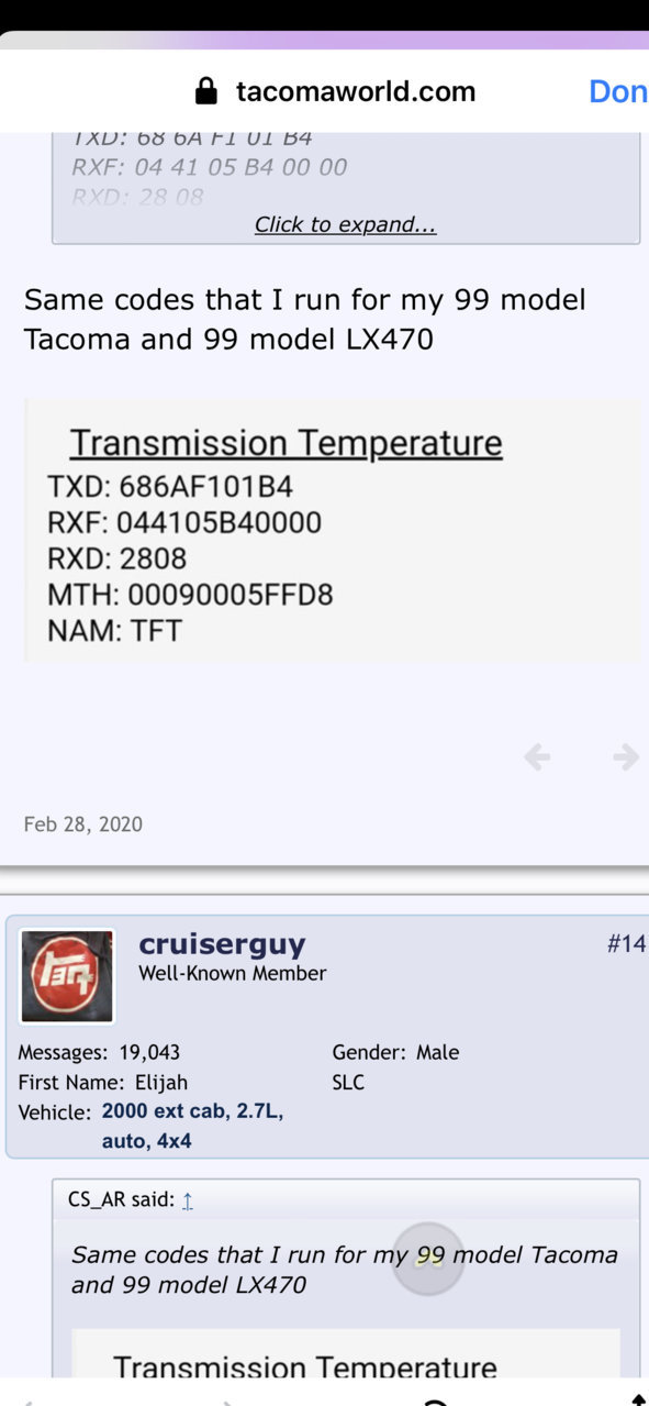

    How are you pulling the trans temp with the scangauge?

    Here are the scan gauge codes you have to put in. Just go to YouTube and Google setting up scan gauge 2 and there’s a video that walks you through everything where you put the codes in. From what I understand these codes will only work from 99-04 Not sure about earlier years.

    Thank you. Looks like my scangauge is too old to support Xgauge. I will look at my newer scangauge on my 4runner.

    Awesome! That code totally worked on my 2004 4Runner with a newer Scangauge.
