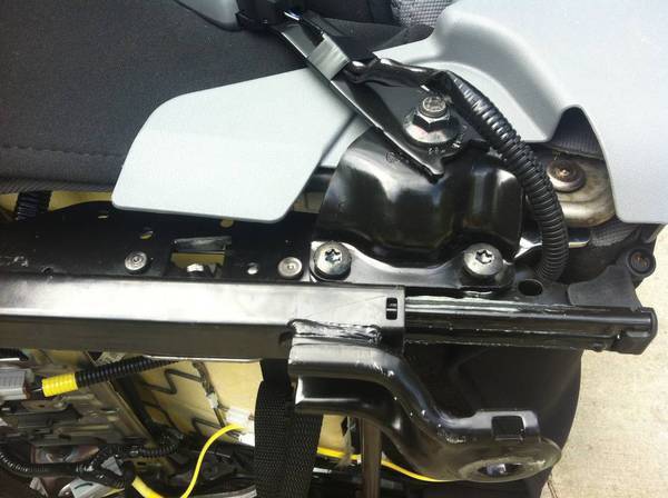

    This idea was conveyed to me by Mr. Marv and when I was doing my install I took a few photos. The final goal is to rotate the bar that is pointed down so it's pointed to the front or back.
    I put a Zapco Z150.2 under the passenger seat. 7.5(W) x 3(H) x 13.25(L). It fits perfectly now.
    Remove the seat from the truck.
    Remove the plastic covers on the sides of the seat. There is a combination of clips and screws.

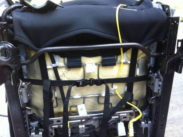

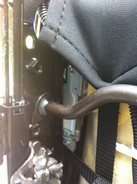

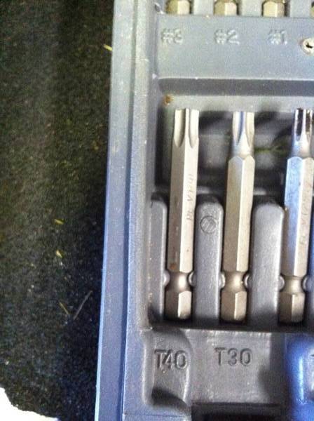

    You'll need a T40. Simply unscrew the ones holding the bar in place. I took the bar completely out.
    Mount the bar back in place so it doesn't hang down into the space under the seat.

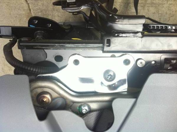

    Remove screws:
    Underside of plastic, notice where the clips are attached:

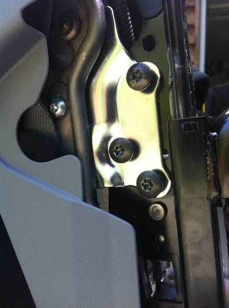

    Use the T40 to remove the mounting screws:

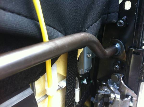

    Bar rotated about 90* pointing towards the back of the seat:
