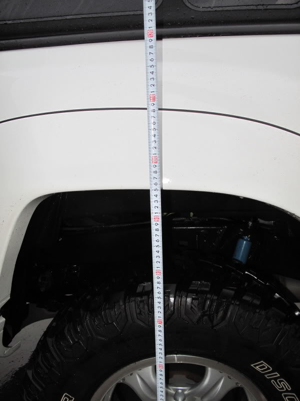

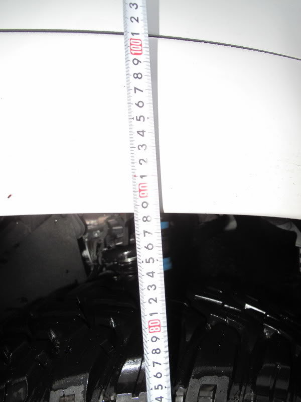

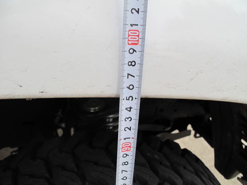

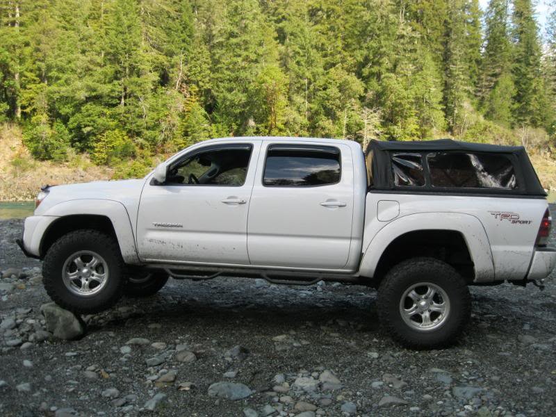

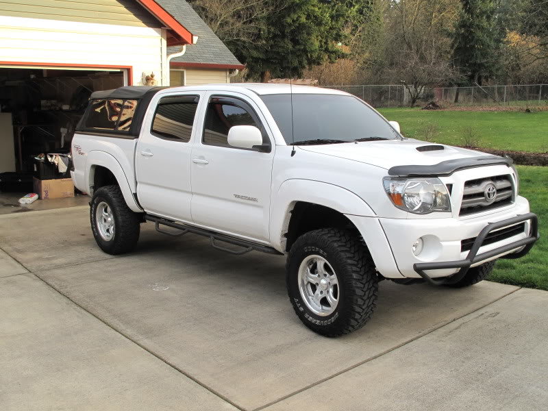

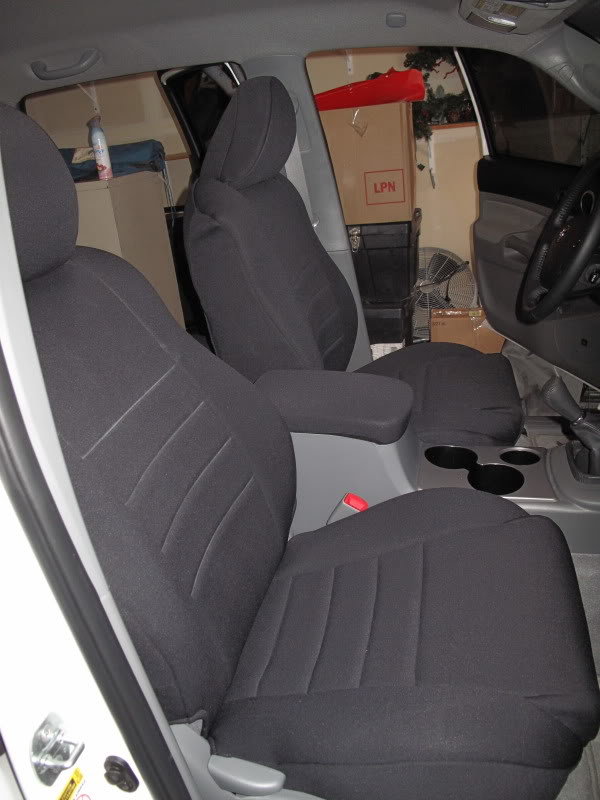

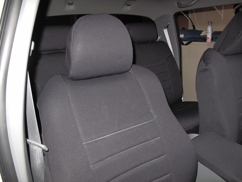

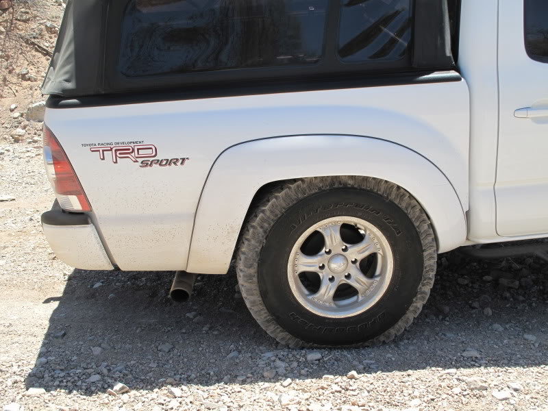

    OK guys, well I finally got a bunch of my parts put on so here you go.

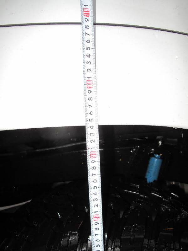

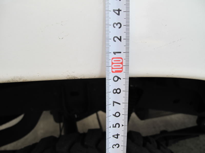

    BEFORE LIFT FRONT = 35"
    BEFORE LIFT REAR (with TSB)=37.5"
    BEFORE LIFT or TSB = 37"
    FRONT AFTER 5100's + Eibach SPRINGS= 37.5"
    REAR + TSB AAL & 5100= 39"
    AVID LIGHT BAR with VIPER LINING (line-x type lining)
    AVID STEP BARS with VIPER LINING

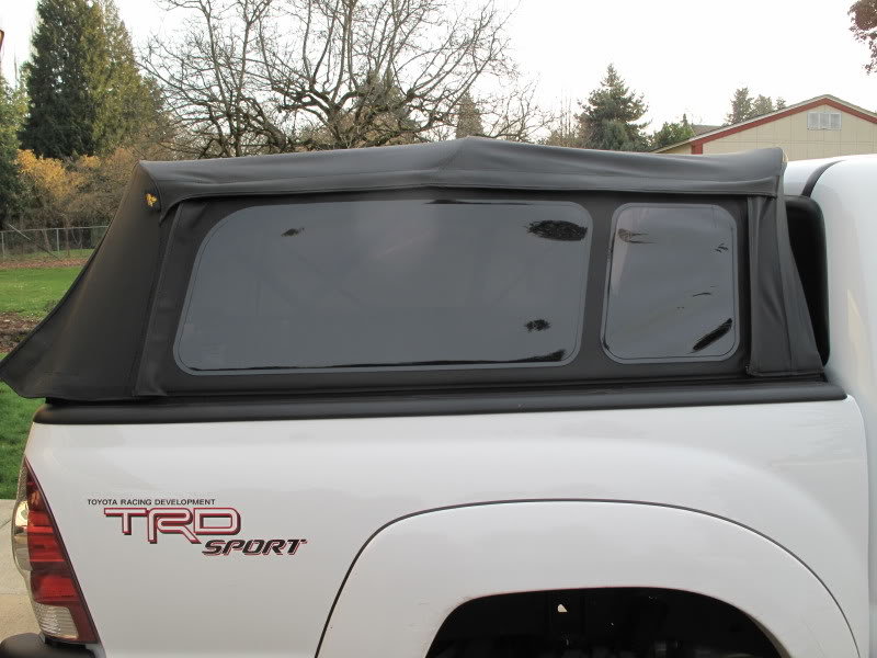

    BESTOP SOFT TOP
    BLACK WET OKOLE SEAT COVERS
    ENTIRE TRUCK
    Then I jsut traded my stock TRD sport rims & tires + my 265/70/16 Cooper STT's in at a used tired shop for $700. Then I called a friend at a tire shop and picked up a set of 285/75/15 Dunlop Fierce Attitude M/T.
    Yea, I know the sidewall is a little corny and the name is kinda gay, but I got the whole set for $850 installed so I literally only came out of pocket $150 for the tires and you cant beat that. My truck isnt a mall crawler but its not a full time offroad beast so I figure these will do jsut fine from what i have read. They will be in at 9 in the morning so I will put more pictures and measurments up once they are on.
    I also have a scan gauge II and URD short throw shifter going on next week. More updates to follow.

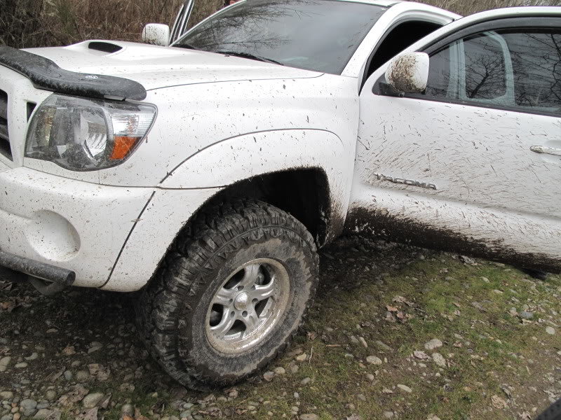

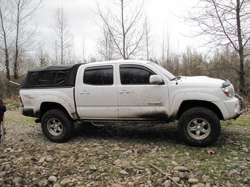

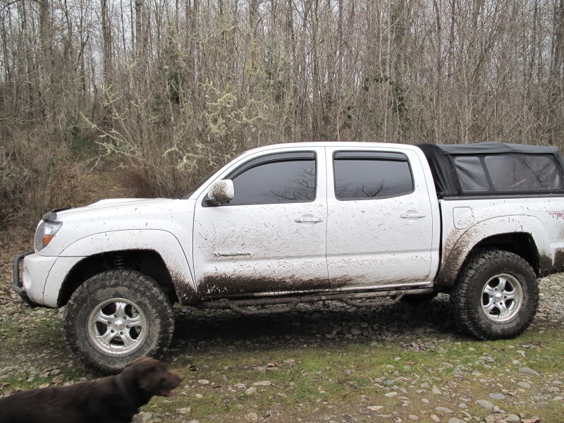

    Ok, got the tires on but its to dark for measurments and pictures tonight. I ended up having to do some inner fender trimming because it was rubbing at full lock and really bad in reverse. I am sure if I stuff them in the wheel well it will still rub but all in all I am happy.
    The tires are quieter than the Cooper STT's and dont seem to weave or track at all so thats nice. I do notice now that I am when my truck says 70mph my GPS says 75 so I need to watch that.
    Pictures and measurments to follow and hopefully some mud pictures tomorrow.

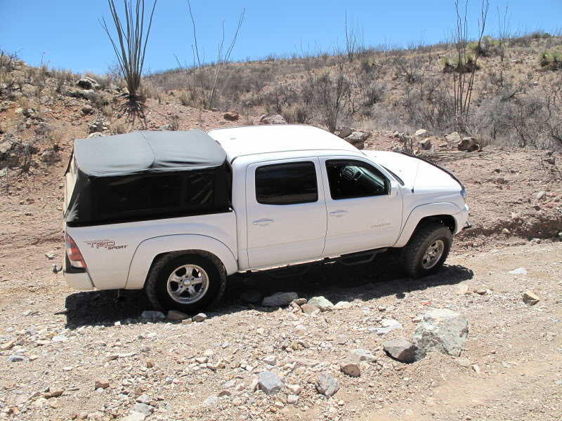

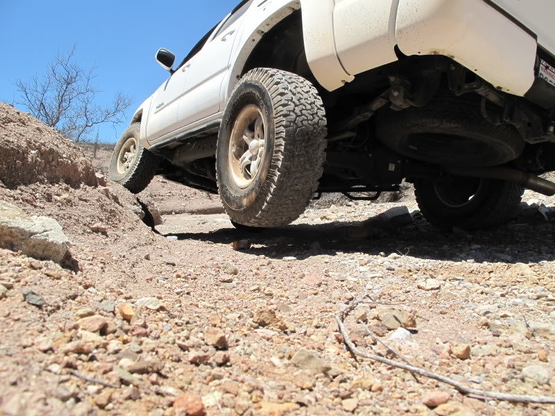

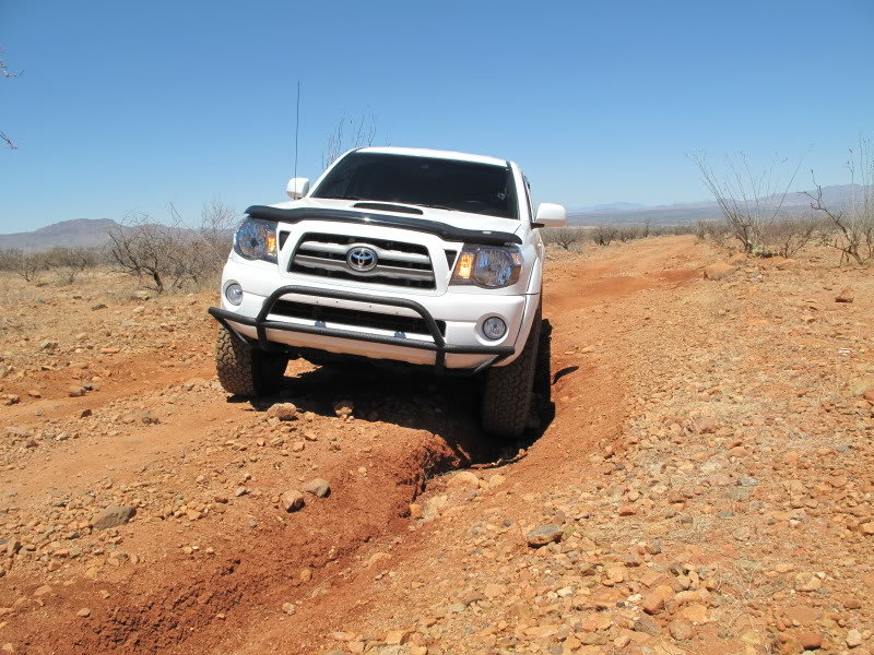

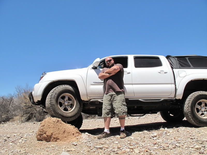

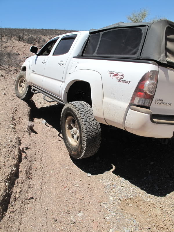

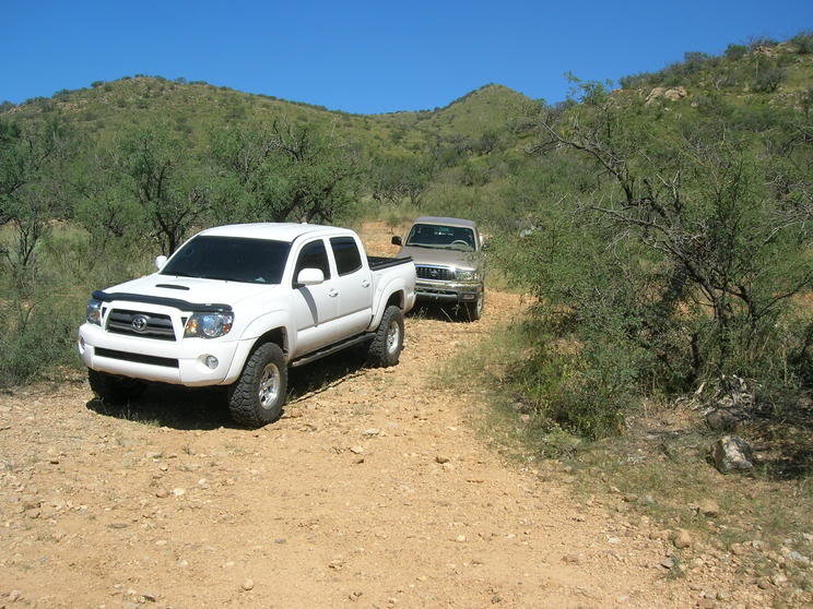

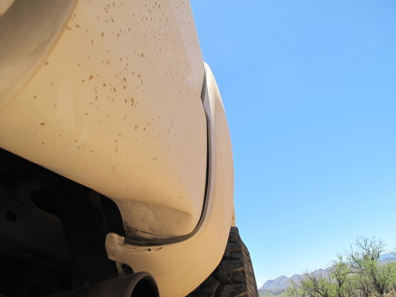

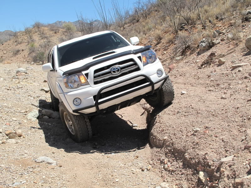

    Ok, no measurments yet but I did do a little offroading (and shooting) on my friends property. Some nice thick sloppy mud, deep water/mud holes and a nice big hill. All in all I am happy with the tires, they bite well and clean nicely in mud. Plus they are quiter than the cooper STT's. Here are some nice pictures for everyone:

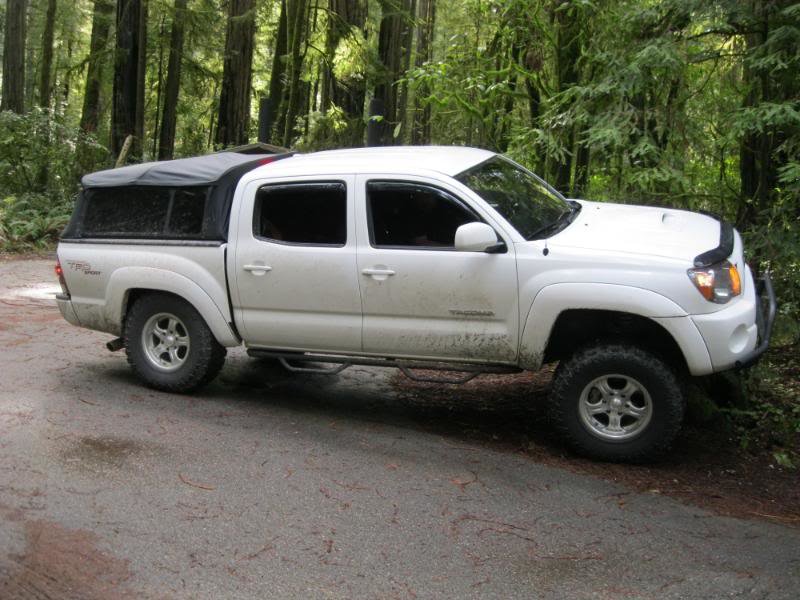

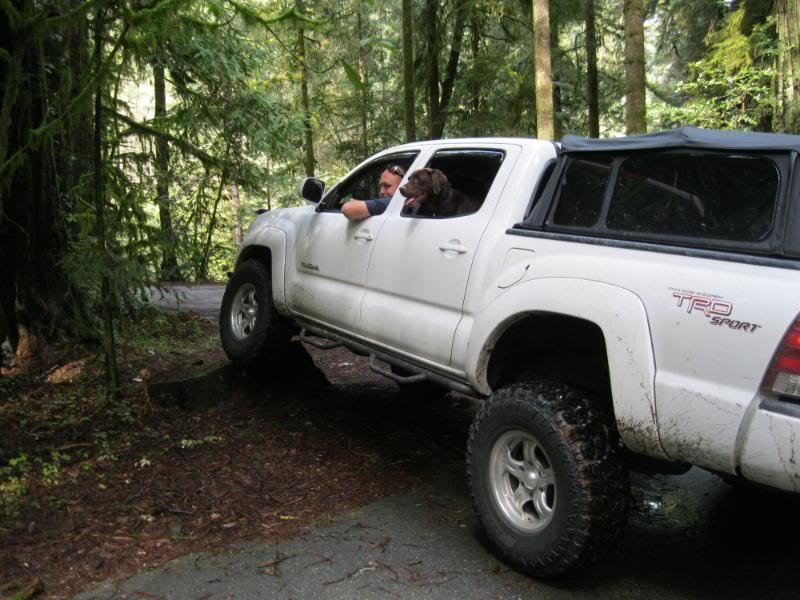

    Here are some recent pictures of my truck down in California at the Redwood National Parks by Crescent City, Ca.

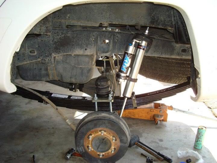

    Allright, time for the most recent update and plans.

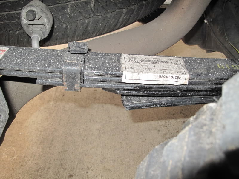

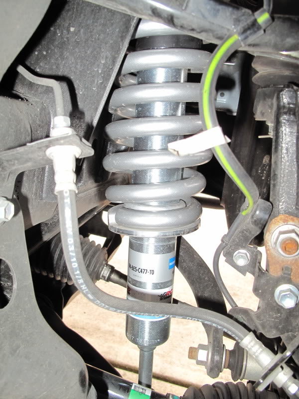

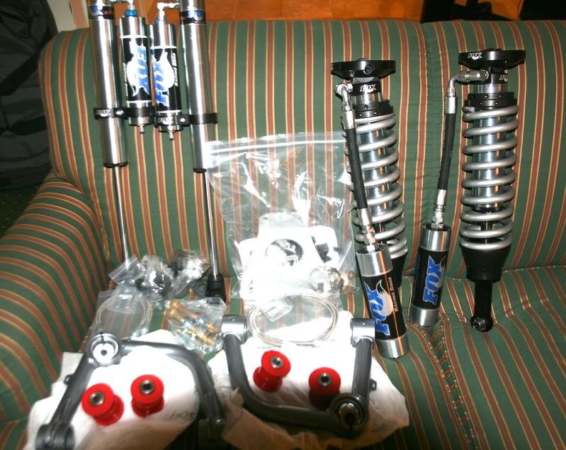

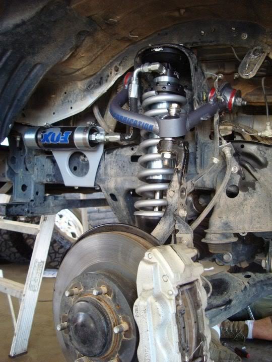

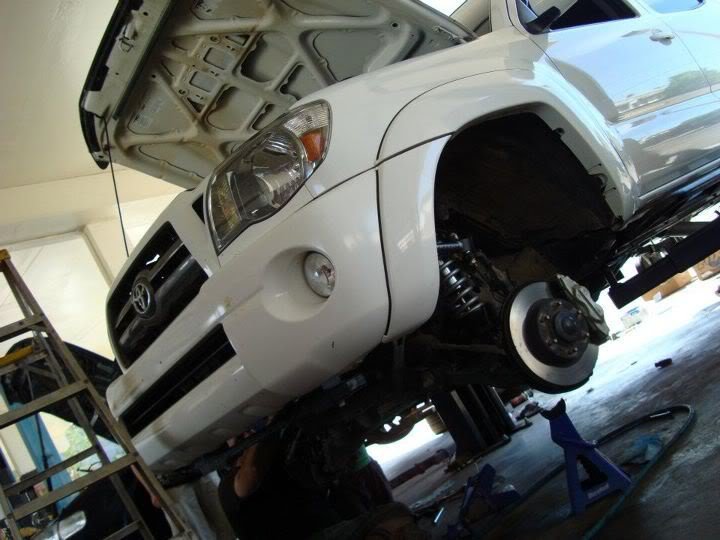

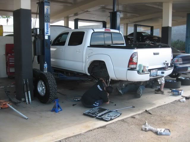

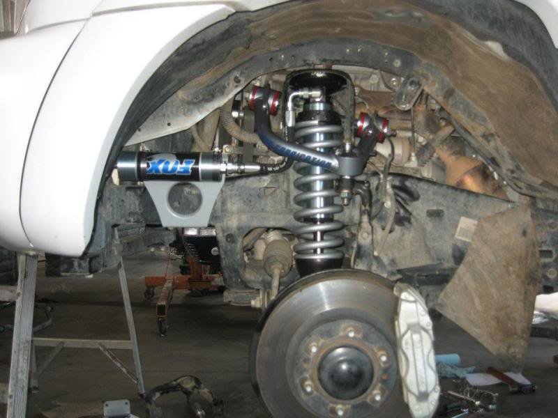

    I finally got my Fox Racing shocks and coil overs, Allpro expidition leafs, TC UCA's, and Timbren bump stops on. I also re-installed my Dunlop Fierce Attitude 285/75-R16. I still need to crank up my coils and plan on doing that next weekend once they settle a little. The back is crazy high and I love how it rides, I just need to crank up the front and then get an alingment. I also got all of my skid plates installed and my Avid weld on sliders with kick outs. Here are the most recent pics. I havent really taken any recently so some of them are hard to tell.

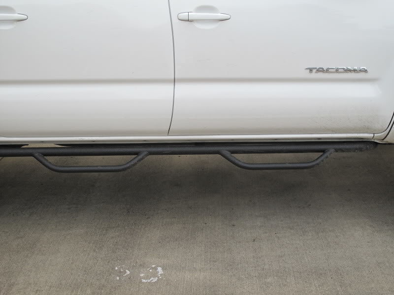

    Here you can see my sliders a little bit:
    Here was my install of my latest suspension goodies:

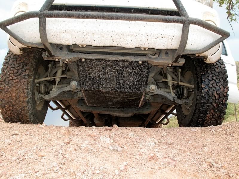

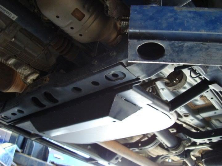

    Here are my skid plates installed:
    310948_10150286555745904_660105903_80498_de8bfad64cc90d69d50d9527f1e81137a2feda05.jpg
