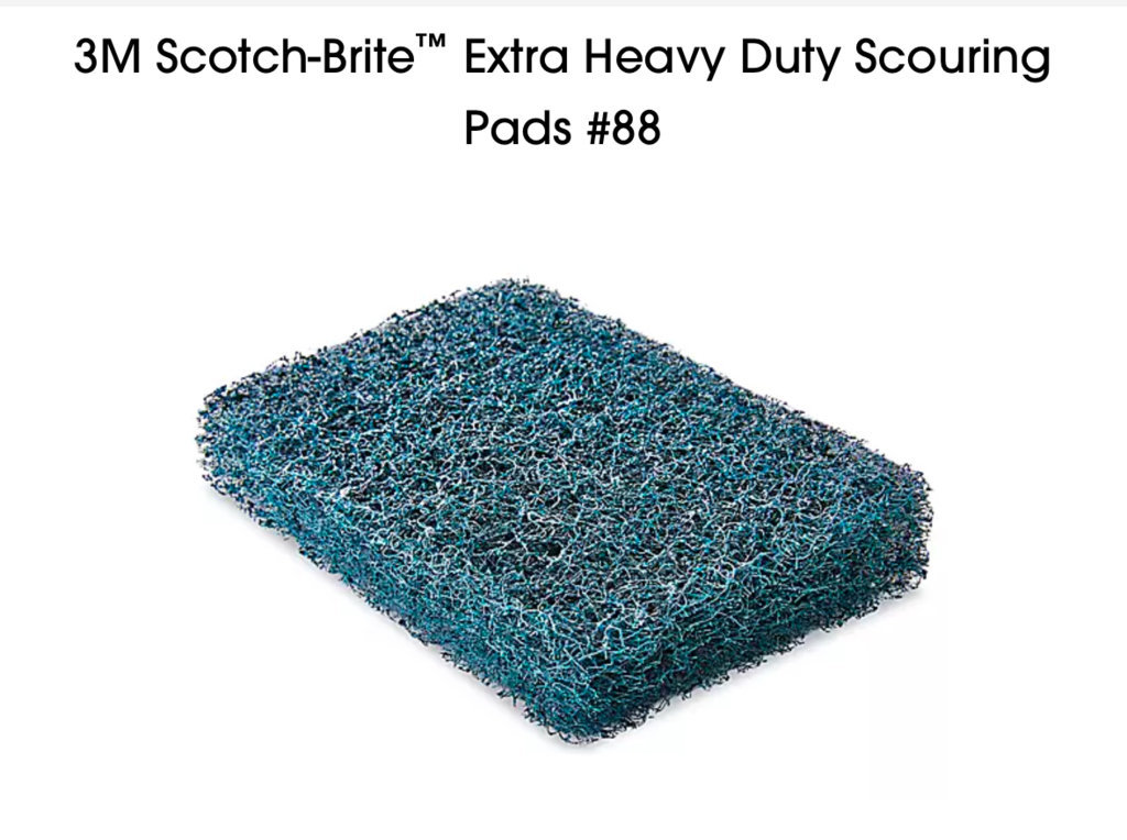

  16. Nov 9, 2024 at 4:41 PM
    #16
    ChrisK7UND
    ChrisK7UND Well-Known Member
    Sep 14, 2016
    #197268
    558
    Colorado
    2017 Tacoma TRD Sport Double-Cab
    LED Interior Bulbs, Hondo Garage Phone Mount, Tacoma Bed Mat
    I just hold a scotch-brite scour pad in the oil stream and don’t splash a drop.
    GTGallop and Jesse H like this.

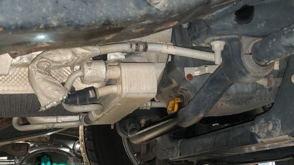

    I'll raise you Ford trucks with plastic oil pans and 1/4 turn plugs, most notably this F150. One of the worst designs ever, it's in just the right spot that the oil hits the sway bar and makes a nice shower.
