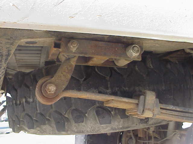

    ok my RUF setup will be:
    My stock rear springs mixed together with another set of rear springs from an 88 4runner. pack configuration - 1st leaf: 84 1st leaf, 2nd leaf: 84 2nd leaf, 3rd leaf: 84 3rd leaf, 4th leaf: 88 1st leaf cut down 5th leaf: 88 3rd leaf cut down and maybe a 6th leaf: cut down to match. I will have a trailgear front spring hanger with either 5.5" eye to eye shackels or boomerang shackels. I will need an extended front driveshaft, it will be a square shaft.
    The rear will be 63" chevy springs from a 95 1/2 ton pickup (3 leafe + overload) and will be mounted using SKY Mfg's. kit. Depending on lift to match the front I'll maybe put in an Add-a-leaf.

    To add, the reason I have chosen the direction above is because I want the least amount of lift possible and be able to wheel the piss out of some 35's, the higher you go with these older narrow wheel base yotas, the easier it gets to roll one. The way the front will be set up, it moves the front axle forward 2-3" depending on how I decide to mount the trailgear spring hanger. I'm using the TG spring hanger in effort to get a better pinion angle (my dual cases will also help this). In addition all of this will require me to run highsteer win an IFS box from an 86+

    AT all cost I would avoid a double shackle setup on the rear if you use the 63" chevys. Yes, it is true the drop travel is SWEET, but They tend to unload going down hill sending you a'rollin sometimes.

    basically yes with the addition of mixing two rear leaf packs to achieve the desired mechanics up front. No hanger from the rear moves up front though. it is a new front hanger all together.
