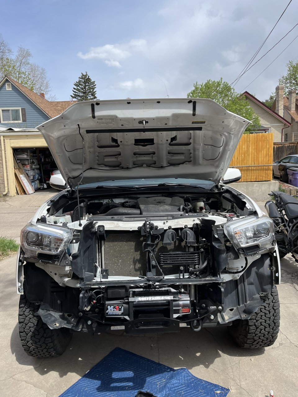

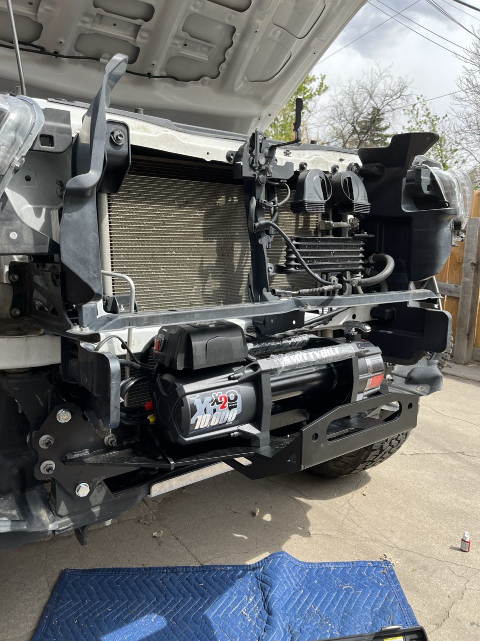

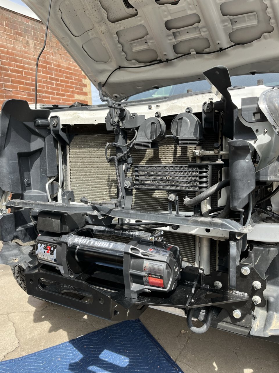

    Hidden winch mount and factory bumper still? A clean look

    Yessir! It's Torq Engineering's hidden winch mount. The toughest part is cutting the hole for the winch fairlead. It's really difficult to line up where exactly to cut given the winch is on the backside of the bumper & they do not provide the template. Other than that, easy & simple install for a lot of functional benefit.

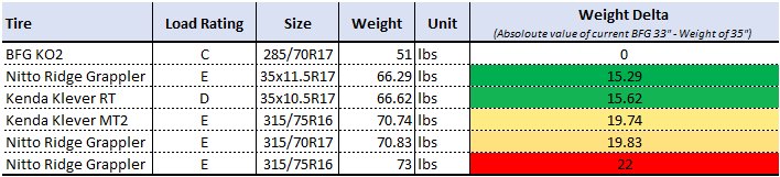

    Hey guys - looking for thoughts & input on 35" tire selection. I have been doing a lot research & landed on the below set of tires based on their tread patterns, size, weight, and reviews. I've put together the below table that compares the tires by some key metrics (size, weight, and the weight difference b/w my current 285/70R17 BFG K02s). The primary goal is to keep the weight as low as possible, but I do have some other questions I could use your input on. See the table & questions below.
    Questions:
    1. Any first hand experience w/ fitting these various sizes? I know the 10.5" Kenda's will be the easiest to fit, but wanting to know how much more trimming would be required (for my setup) if I went with the 11.5 or 12.5 widths. The 11.5 Nitto is very intriguing given it's the lowest overall weight.
    2. Any first hand experience w/ these tires (e.g., performance in snow, tread life, etc.)? I've read a lot of the threads on TW about them, but more info is always better.
    3. I am currently running 17" wheels, but I LOVE the look of 16s... I've been eyeing the old school TRD Tacoma wheels, which are 16x7.5 w/ a 10mm offset. What do you guys think about changing it up to a 16" wheel? Any considerations for fitment?

    I don't have first hand experience but I'm in the middle of buying new tires now so I feel your pain. (about to order the 33x10.5 kendas)
    There's a big thread on the Kenda 35 x 10.5s it looks like a CMC and plastic trimming is about it. Everyone I've talked to loves the Kendas
    There's also the Mickey Thompson Baja Boss in 255/85/17 at 65ish pounds I think

    Look at the Falken RT in 35x11.50. C-load, but with a beefier sidewall. It's like 66/67lbs. Just put a set on my truck. They weigh about the same as the 285/75/17 C-load ridge grapplers I had previously. My truck already had a CMR and a C4 fender liner kit, so these just bolted in place without any additional work.
