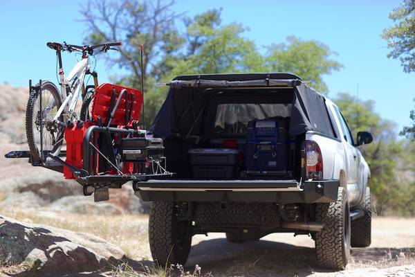

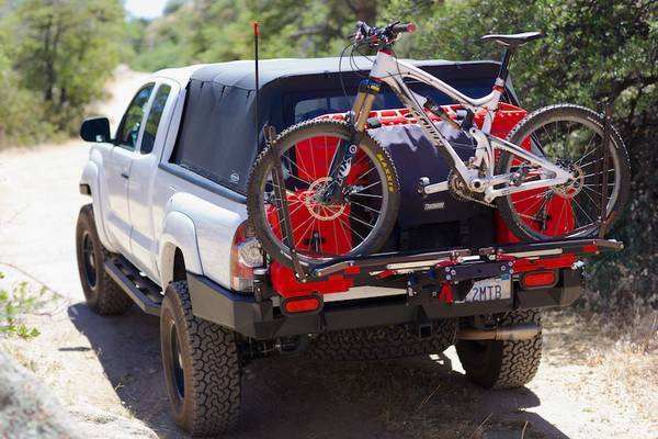

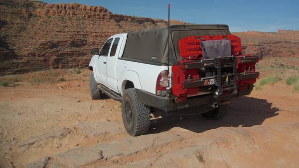

    No, I'm still trying to come up with a way to hold a kayak/canoe over the RTT, but I saw this guys bike rack and decided that was the way to go. I figure it can go in the hitch for now, and one day when I get a bumper with a swing out it can move up there.
    http://expeditionportal.com/lou-ortegos-toyota-tacoma-fit-for-adventure/

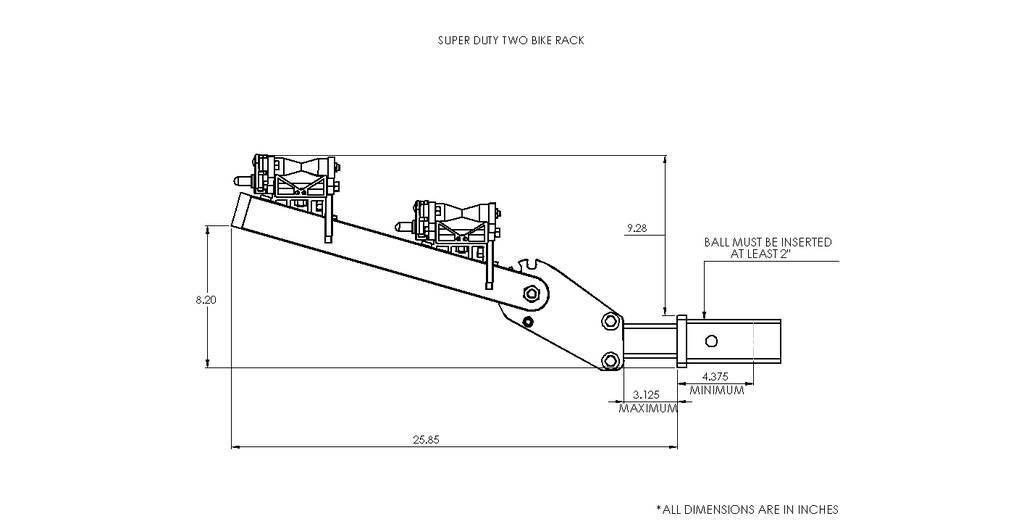

    And I'm a sucker for companies that post the technical drawings for their products. Plus I like that it's all metal. Yakima and Thule stuff has so much plastic to break. If only it didn't cost so damn much.
    http://www.1upusa.com/product-SDquikrackdoublesilver.html

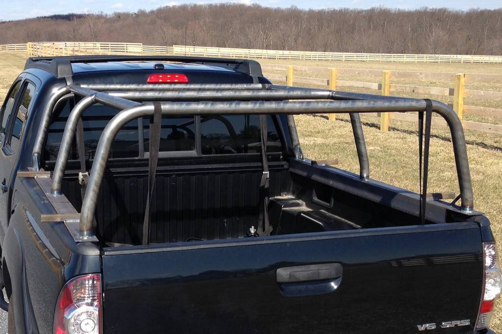

    How long is the square tubing that sticks out for your bike mounts? specifically how long from the inside of the rack rails to the very outside? Looks to be about 6" long?
  12. Jun 6, 2018 at 9:50 AM
    #52
    OutbackHack
    OutbackHack [OP] Well-Known Member
    Dec 3, 2009
    #26963
    636
    Evergreen, CO
    2014 DCLB Heavy
    Stupid amount of extra heavy metal all over
    Precisely. (All the dimensions are in the first post :cool:)
    But mostly you’ll probably just want to measure whatever bike rack you plan to use and make sure it fits and clears the RTT if you plan to have one.

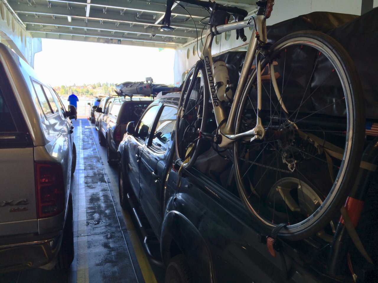

    After running bikes on the sides for a few years I switched to a rear rack. It’s nice having them up on the sides, but often I had to worry about them hitting low tree branches etc. Also after moving to the NW, I found the bikes were too tall when putting my truck on the ferry and I had to pay extra for riding with the big trucks. Also parking garages. Ymmv
