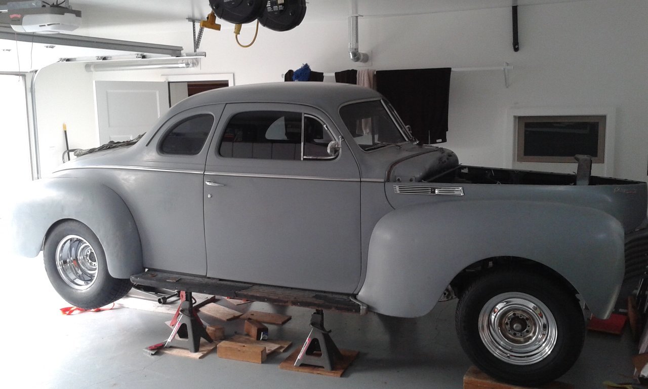

    So, I will soon be building the roll cage for my car. I am having a custom cage bent to my oddball specs (factory specs for a cage for a '40 Chrysler wont fit mine). However, I will be making some changes to make the cage fit my needs better since I dont plan on getting it cert'ed. My changes will require me to re-notch some of the 1 5/8 tubing.
    What do you recommend for a tubing notcher? Yes, I could notch the tubes using my chop saw and grinder. However, I am floating the idea of getting a notcher. I assume HF and Eastwood wont get many good words, maybe Pro Tools?
    Its cheaper for me to get a 14pt and remove bars than to get a 10 pt and add bars.

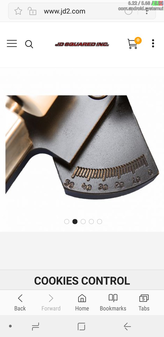

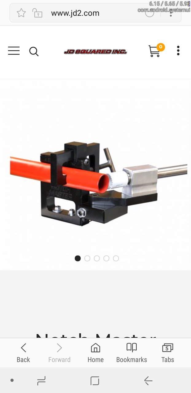

    A hole saw, you want to spend more jd squared has a notcher thats slick.

    Thanks. Ill have to get the laptop working. Cant access JD2 on mobile for some reason.

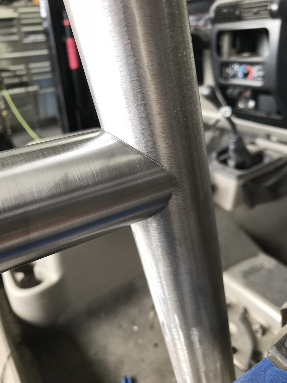

    I have a JD2 Notchmaster. Unless you absolutely have a need to cut a sadle in a curve, you won’t need the Beast. The hole saws I recommend are Milwaukee ICE. The Notchmaster is a surgeon, this is the fitup you can expect. This is 1.75” .120 wall in my Jeep.

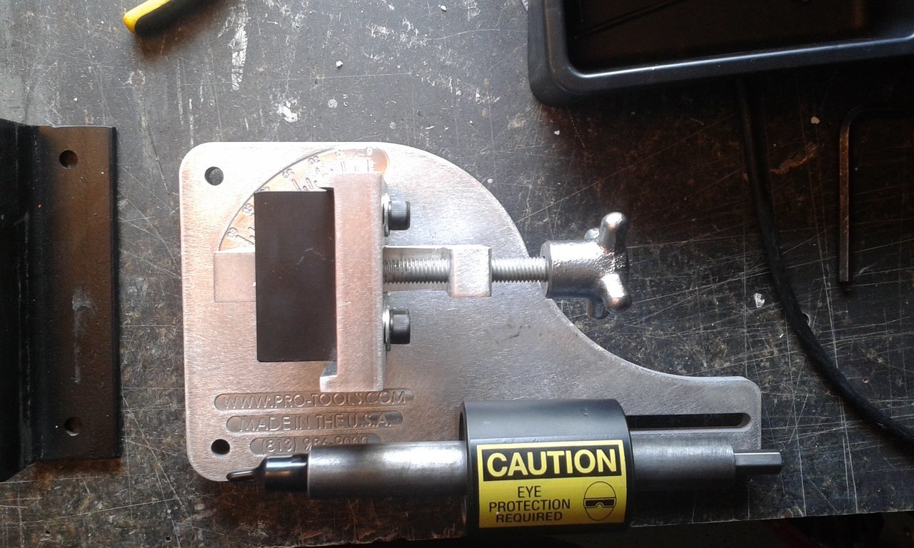

    Found a Pro Tools Industrial notcher for $150 new. Im going to build a base for it to attach it to the planishing hammer stand I have. Ill add an adjustable support to rest the end of the tubing on.
    Edit: I was lazy and just put it in the vice.
