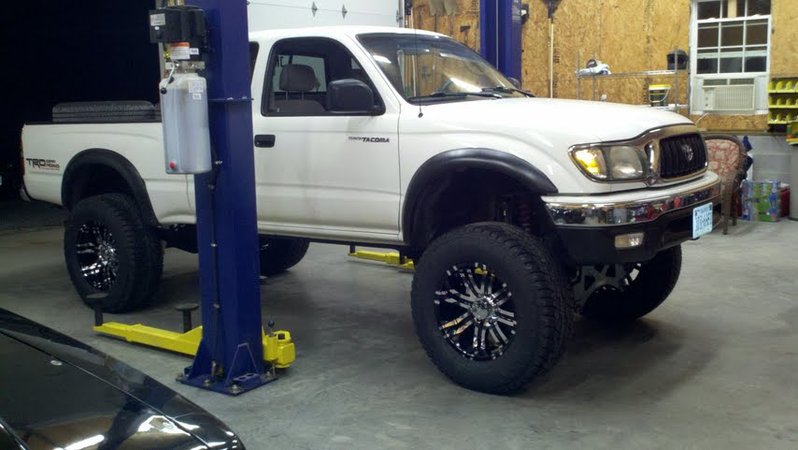

    Yea you have to drop the diff/cut cross member from frame with "lift kits" which is why a lot of people don't like them because you aren't truly getting extra clearance other than oversized tires. I wanted to go with a 3" toytec setup and 3" body (less expensive setup!) but decided against that to avoid the issue with CV boots rubbing due to angle of shaft. I drive a lot on beaches/sand (same issue with mud) which speeds up the process of blowing the boot dramatically if the shaft is angled causing rubbing. The lift kit keeps everything lined up nice. I spent about two months trying to decide what to do every setup has its pros and cons and its hard to decided what's best for your needs.

    I love my 6" fabtech lift. It works great, never had any problems. No it's not an SAS set up, but I do have more clearance than my friends with stock or 3" kits. I am able to run larger tires, which allow me to go further than my buddys do. oh, and it looks WAY better than the 3" kit. If someone tells you it's not worth it, and you want it because your weenie is small, it's only because they are light in the wallet and can't afford the bigger lift. I am however going to be getting rid of mine and upgrading to an SAS kit in a year or so. I miss the articulation factor :)

    I'm not understanding how you could have more clearance from ground to front crossmember than someone with a 3" lift.
    The 3" lifts pivot the lcas down, thus increasing the ground to crossmember clearance by 3". The drop bracket lifts do not. They work by actually moving the cross member down.
    So in order to have more ground clearance than someone with a 3" lift running 33s, you would need to have gotten all of your ground clearance using the tires, meaning you would have to be running 39's.

    Measure your ground to drop bracket height. Please.

    I love my truck, even if it's a mall crawler at the moment. I've owned it for less than 2 months and havnt had a chance to begin my build let alone finish it. Give me a break. I'm just "conversating" and giving defense to the fab tech 6" lift that has served me great the last couple months. Thanks for trash talking my truck, I can only hope to have one as bad ass as yours one day. I can also only hope my ego doesn't grow to the size of yours and that I don't trash other people's trucks when I'm done building mine.

    No, you're throwing around false information such as "I have more clearance than someone with a 3" lift"
