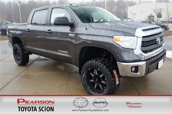

    Well I'm OFFICIALLY joining the 6" drop bracket gang...on this bitch d198a6ce46d9c0dd99a70dc1fa609c3e_f464d37f5b4bd3eb91a6a8ca805394283f7e8694.jpg

    Pro comp or fabtech :)

    Pro comp..it's the basic...I'll have to swap in coilovers and change wheels and tires cuz there ugly

    I hope you got the warranty I'm hearing that the power steering pumps on the Tundras are blowing up with these DB lifts and big tires.
    No joke here..
