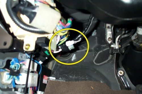

    For what it's worth, I have also included the link to the Free Alarm Mod as found on CustomTacos. Below is a picture of the clip that needs to be unplugged to make this mod take effect, but the process is broken down step by step in the writeup.
    Free Alarm Mod (2003 Specific - Possibly works with others)
    http://www.customtacos.com/tech/index.php?article=12
    All in all, your best bet may be to track down the actual part that is installed in a factory keyless equipped vehicle and snag it from an auto salvage, or keep an eye open in the Buy/Sell Forum for someone parting out their 1st Gen truck. That way you are still saving money, but could possibly still be able to mod it into a Free Alarm.
