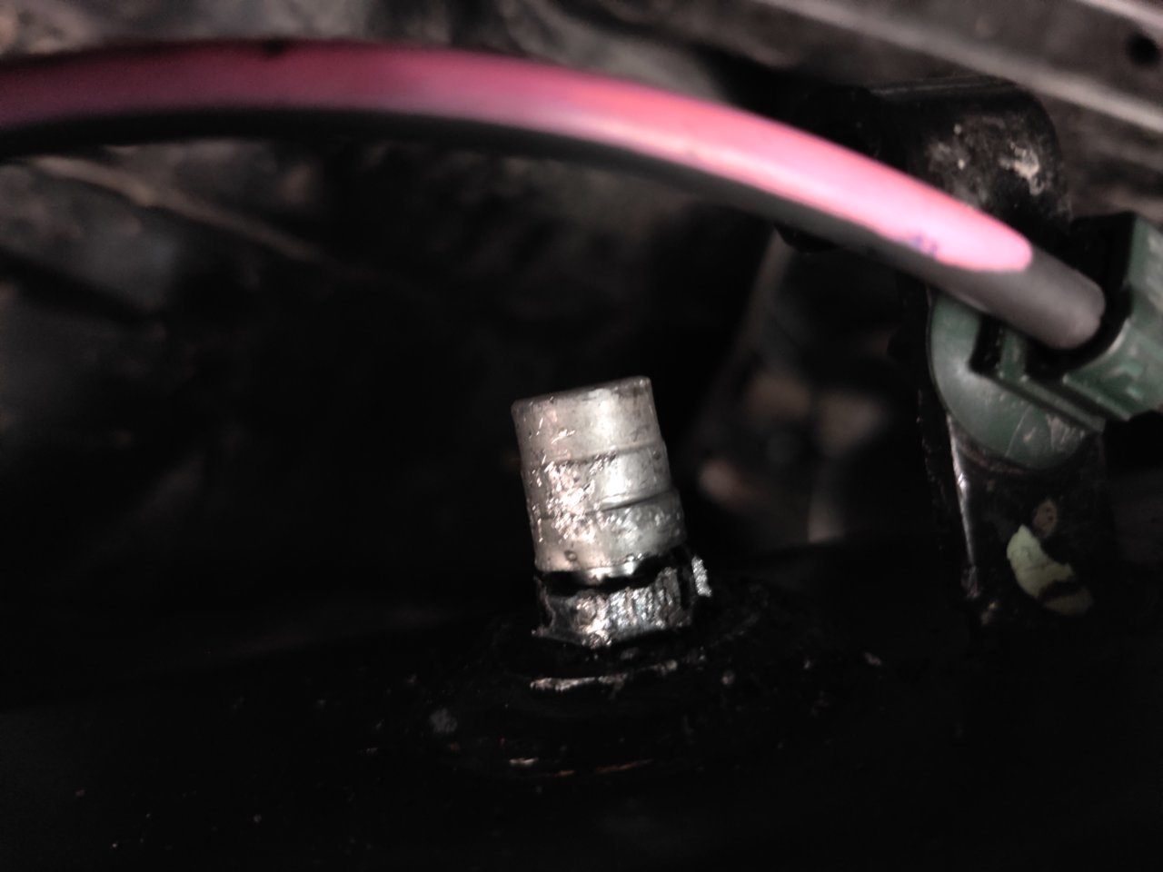

    I tried to remove factory breather with the 14 mm wrench but the nut is not strong enough and now it is slippy that I can't remove. I did try 13 mm but it won't fit in. Any idea

    Slippy? How about rounded off?
    Vice grips at this point.

    Tried pipe piler but it got worse. I go to a hardware store and get vice grips. Yes rounded off. It is overtightened already.

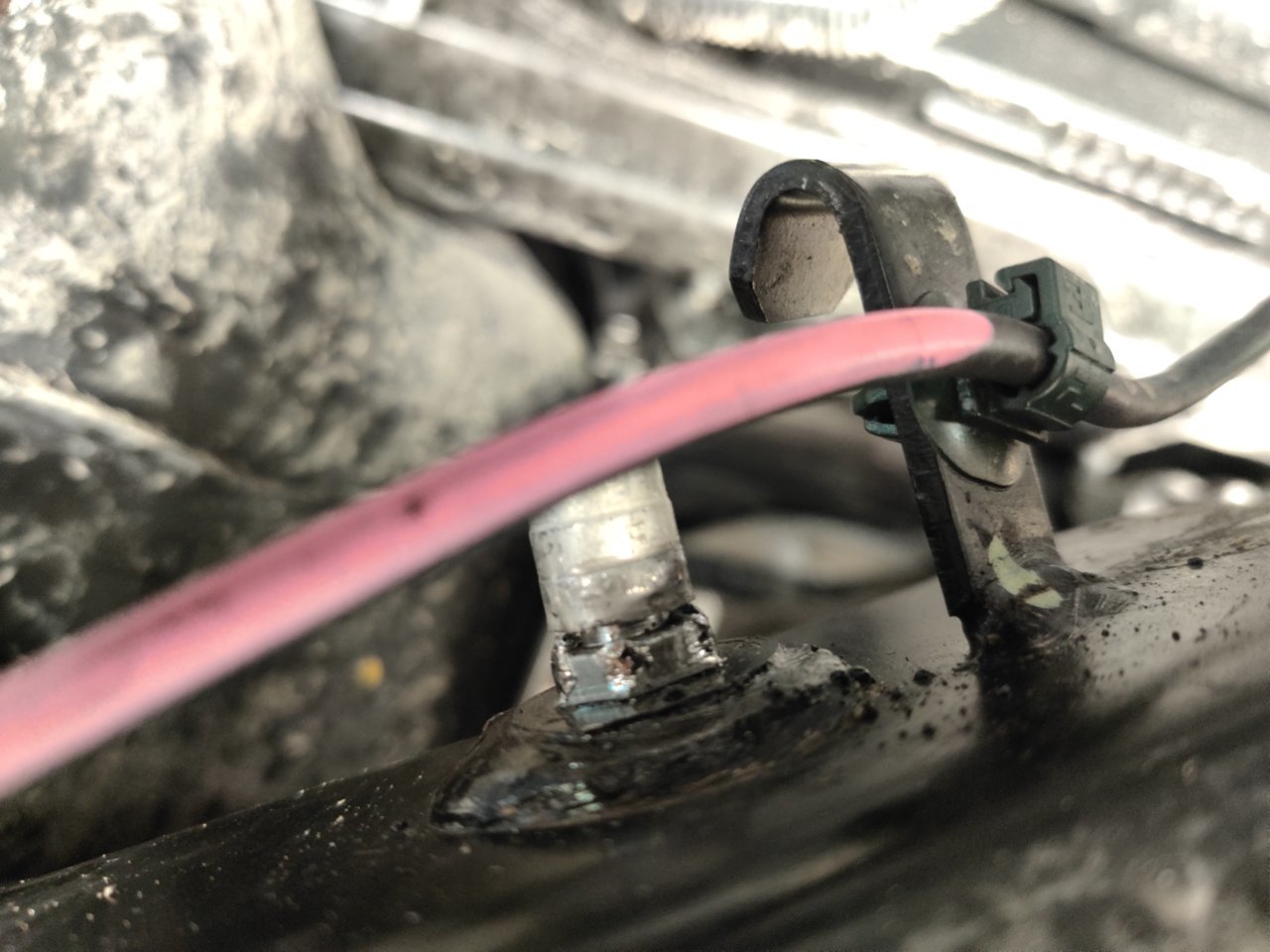

    That is bs. That wont budge when I used vise grip. Someone overtightened it at a factory. It has less than 4 k miles and it is only a year old. I had no issue with the nut in my 4runner before.
    Here is the pic I got it from harbor freight. I used the largest grip but the nut kept worse. New pic added. It is messed up.

    Looks like the hole keeps getting deeper. Find a socket that is slightly smaller than the rounded breather and hammer it in. Then unscrew it loose like a goose.
