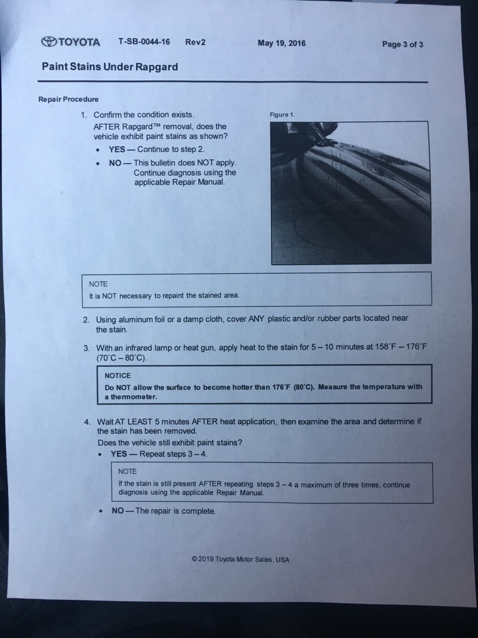

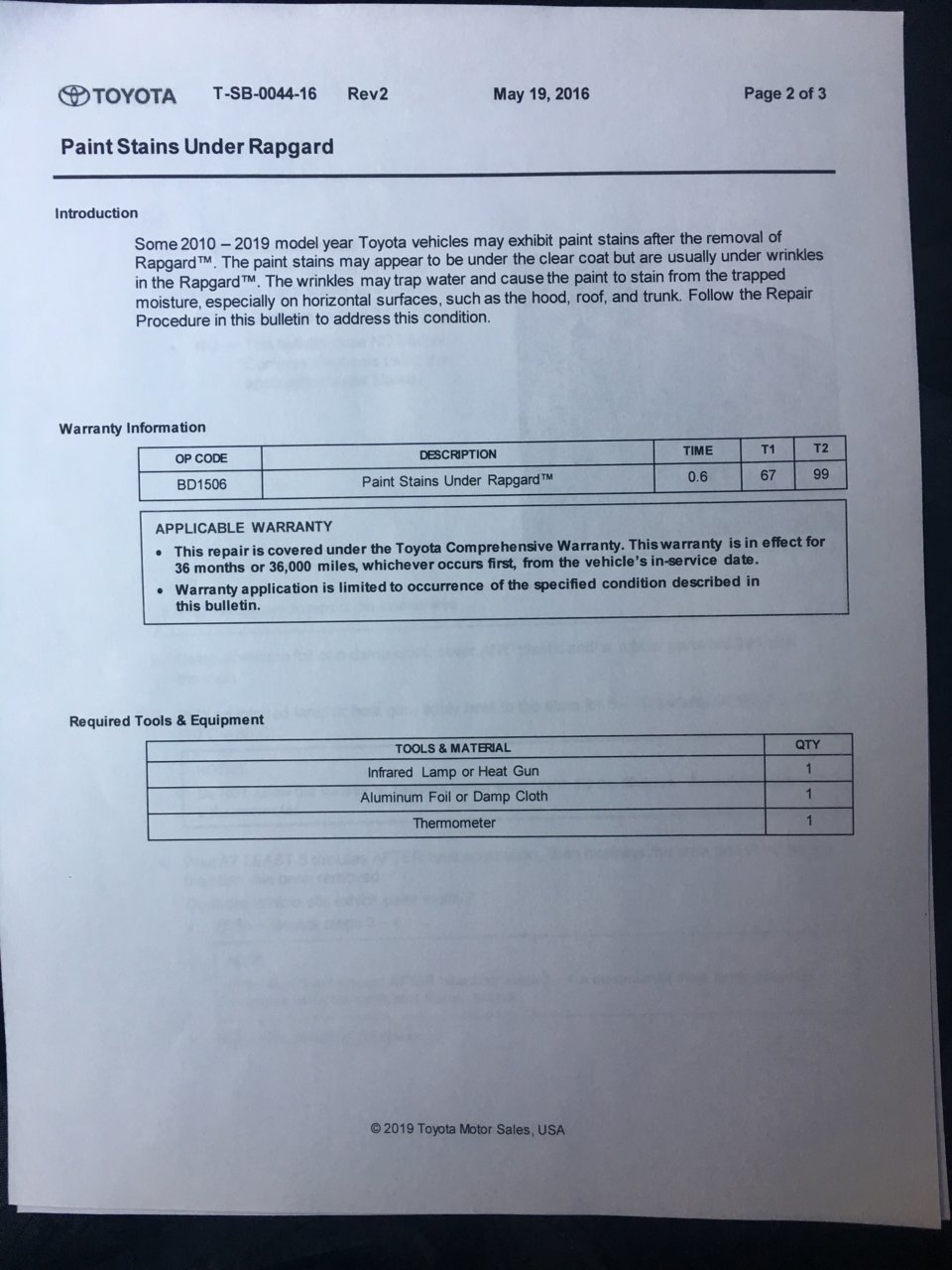

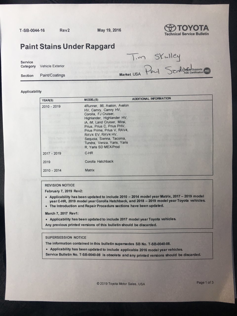

    What makes me crazy about that TSB, is that it covers every Toyota vehicle since 2010.
    Is it safe to say that Rapgard is a big fail? Is it about time for a new formulation?

    From what I can see Rapgard is not a consumer-level product. It's the white sheeting you see on cars when they're in transport. Which leads me to believe that when the crap is removed nobody is even looking. It gets washed in the wash bay and put out in the lot.
    https://testing-public.carmd.com/Tsb/Download/37639/tsb97-09-01

    The heat gun did not work on the spots on the hood of my truck. The service MGR said he could’ve kept going to see if it would have evaporated but that could have damaged the paint from excessive heat. So he called corporate and spoke with the regional service rep and recommended new paint for the hood to him. I have to meet with this regional rep next week so he can make a product report and get it set up from there.
    Based on that, this isn’t moisture, not sure if the wrap is the cause in this case. Who knows what this is, perhaps hard water deposit, but you can’t feel any abrasive or lip on the areas where this is.
    I’ll report back after speaking with the regional rep.
