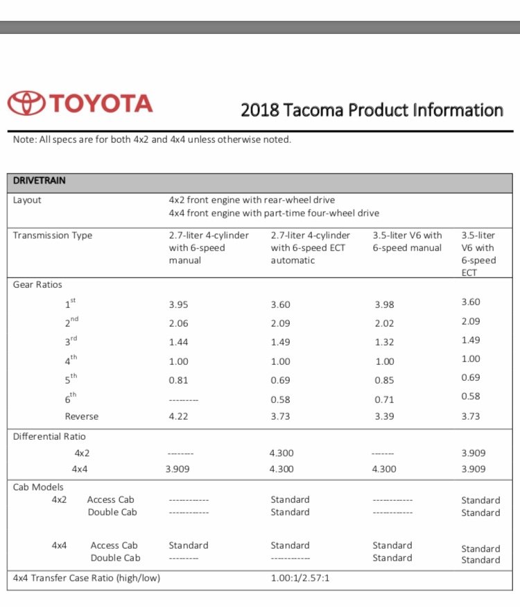

    I’m not sure yet if my Tacoma has 3.91 or 4.30.. looks like is 3.91.. so, if I decide do it, you recomend me go with 4.88?
    Mine is V6 Automatic transmisión

    TOYOTA OEM: Cast Aluminum Running Boards Mud Guards Bed Mat All-Weather Floor Liner NIssan Frontier Sliding Bed Extender
    You have the 3.90 :)

    2017 Tacoma TRD OR
    RTT Rack
    Get the 4.88s. lots of guys are super happy with them. Fyi with 4.88s and 33" tires your final drive ratio is still a little less than a stock manual transmission, but still way better than a stock Automatic.
