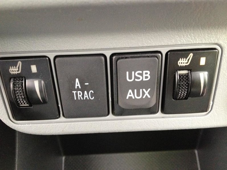

    I think this is my picture...regardless this is my setup. Heaters work really well. I installed the wiring but had a local upholstery shop install the heating elements. It is one of the eBay kits with the factory looking switches. Wiring the switches to illuminate correctly to dim with the interior is different than what's on the wiring diagram.
    But I'm pleased. It's hot when desired and the 4-5 settings of warmth are nice.

    This looks like the same setup I have as well.

    That's the switches I use and it is nice being able to set the heat level exactly where you want it. Also your profile pic make me laugh... That's the look I get when my dog is guilty of something.
