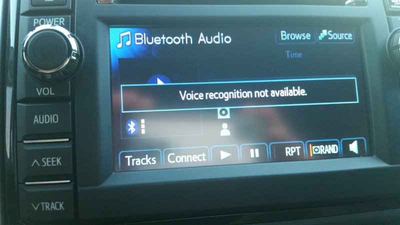

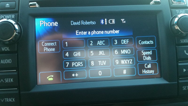

    So I pulled my head unit out again and made a few discoveries. First I found a wiring diagram flaw on TIS. Its amazing to me how many times Toyota has change the radios in the Tacoma. So much so they lose track. Anyhow after checking and tracing wires and operation I think it's working as intended. My stock radio I was able to push the talk button on the steering wheel and the nice lady work ask me for a phone number or say the contact. With the new radio installed when I push the talk button a window opens on the display and say voice recognition not available. I think this is normal because the radio does have the feature. If I push the phone button a screen come up with a number pad with speed dials, contacts and call history. Place a call and everything is hear though the speakers and the mic picks up my voice.
    Now onto getting the back up camera to display which I'm pretty sure I know how to do.
